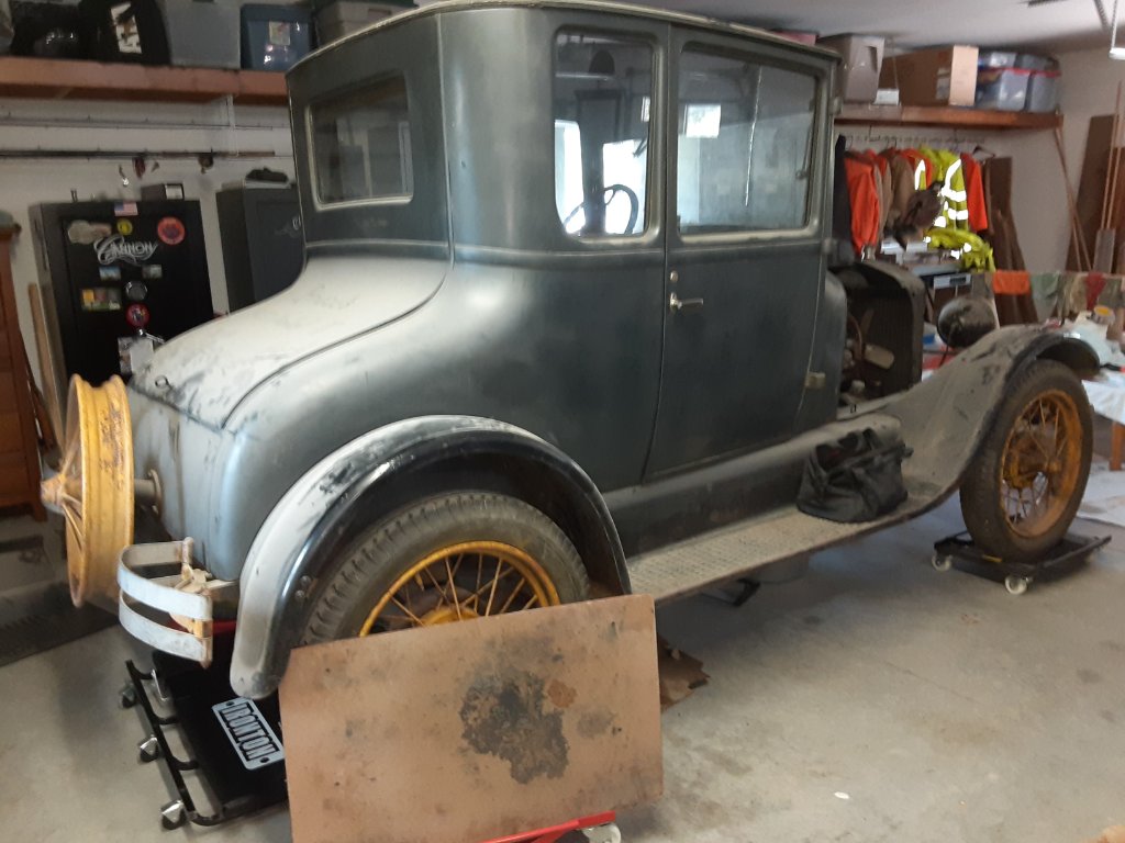

My 1927 coupe has the split rear bumper. Look at the fourth photo in my post "1927 Model T Coupe Restoration". It shows the brackets for the split bumper. I will send a photo that shows the bumpers attached to the brackets. I can't get the photo up now for some reason.

With regards to the rear split bumpers, do you know if that coupe was in the family since new? Could the bumpers have been installed at the Ford Dealer, or your relative install them himself? The reason I ask this is parts books seem to list spilt bumpers for runabouts and coupes, but in Australia.
However perhaps Ford did offer split rear bumpers for runabouts and coupes in the USA. It might be hard to find out as the bumpers were an accessory and were easy to add by individuals. Perhaps if others have improved coupes and runabouts with split rear bumpers, and comment on this forum, we may get a better understanding of just what happened. Perhaps the Bentsen Ford library has information we can research if/when Covid 19 issue is over. Vehicles that were handed down from one generation to the next especially with a know history may add to the information about split rear bumper availability.

IMO, the coupe pictured with the split rear bars is sporting non-Ford aftermarket bars, made by any number of suppliers like Marquette, Steward-Warner, etc. They may be this type:
