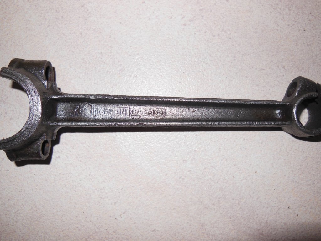

It is also on the Canadian Top Bow Saddles and connecting rods.
