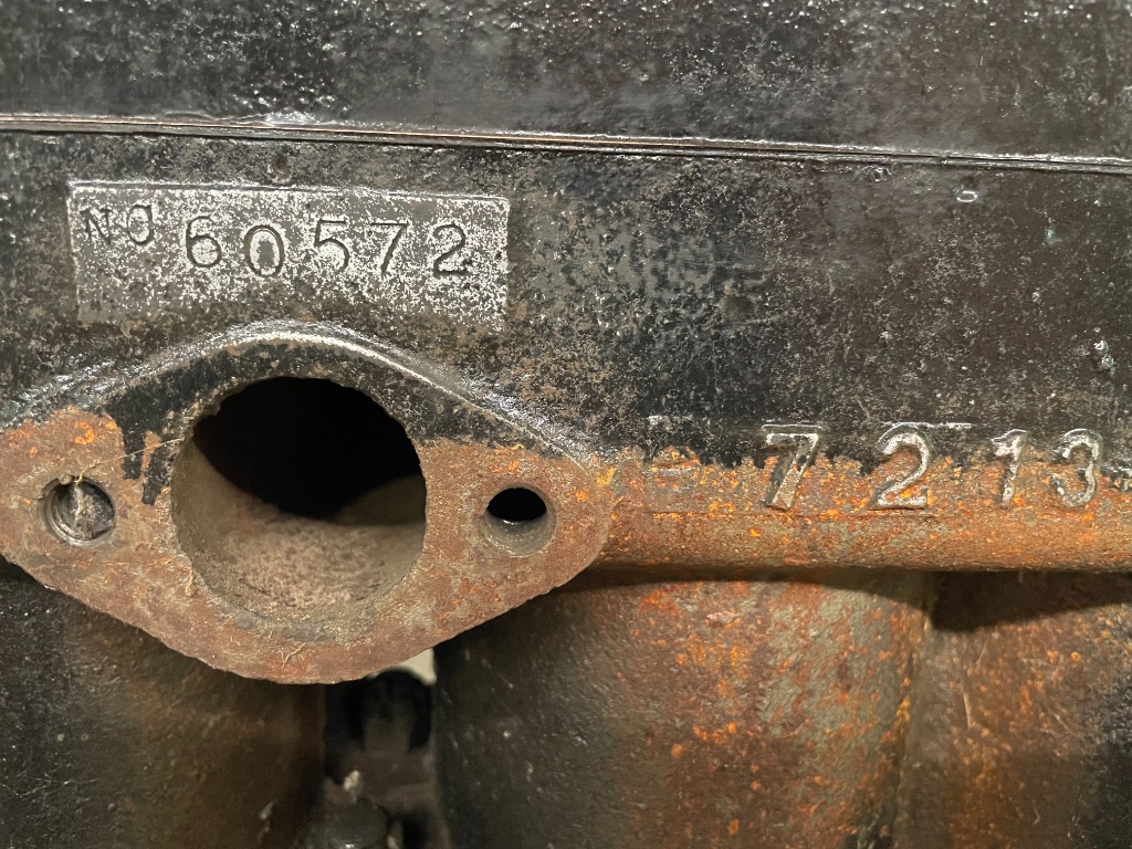

This is the engine number off the barn car I just picked up,. I have no idea about this one. Has anyone ever seen this before?

july 11 the number mark is odd

i wonder if someone replaced the 11 engine and re stamped it with the old number

Late June 1911 engine number; but a 1913 casting date? And I've never seen the "NO" prefix on an engine number. I think we are going to learn something new here.

The style of numbers is correct and there’s no sign that the original was ground off. This car just keeps giving challenges.

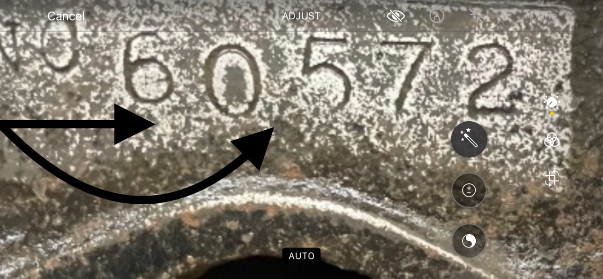

I enlarged the picture & think I am seeing shadows of numbers between the more pronounced numbers.

Replacement block stamped with the number of the ruined one it replaced. It would have been stamped in some shop, not the factory, where the "NO" was added. That could have happened in some other car before it ended up in the present one.

Is it just me, or does the "NO" really appear to be "NC"??? See the little "hook" in the 1 o'clock position of the C/O?

I don't understand the assumption that this was a new block that was changed out in 1913. As John pointed out there does appear to be some evidence of a previous (1913) number on the block.
Yes, it could have been changed out when the car was 2 years old (assuming the car is an '11, a leap of faith since it shares no similarities to similar bodied '11 Torpedos), or it could have been changed out any of the following 100 years (like when it got it's new frame??)
Given the July '11 serial number, if that engine sat for just a couple weeks, it would have been a model year '12 and that could account for the very unusual '12-ish body style.

The casting date is 7-2-13, that matches the running changes I see on the frame.

From what I see I don’t think it was ground off and re-stamped, you have to remove a lot of metal to get stampings out.

Note how the water inlet appears to be higher than the number boss. On all of my 1913 engines, the water inlet and the number boss are the same height, as if they were machined at the same height. My guess is this is a replacement block and the number is an original stamping, not a restamp. Just my thoughts. Russ Furstnow

To me, that is indeed a 'C' . Just a guess, but perhaps the mechanic who exchanged that later '13 block for the busted serial of an '11 made those letter notations along with the old serial number.
Could be NC for a North Carolina requirement needed the state attorney or could be NC for Number Change.
In any event, that is original '13 block, and serial pad was blank, as Russ pointed out, and then the odd letters and old serial added.

I thought it was NC at first glance myself, especially since it is in N.C. Maybe a state thing

Well Rich that picture pretty much confirms Russ’s thought about the numbers boss being cut down.
