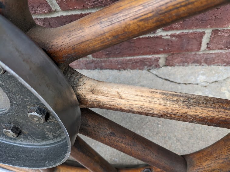

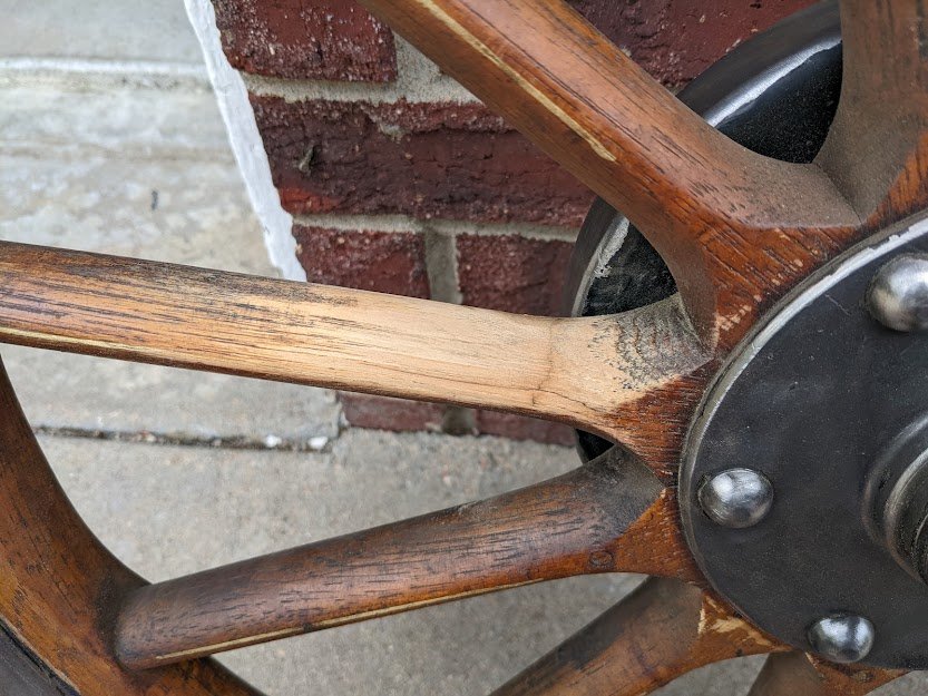

I am in the process of restoring a 1911 T touring car. Like renovating an old house, digging into a car that old will inevitably result in some surprises. The car spent about 110 years in southern California before making its way to Kansas last year. Overall the body and wood are in very good shape, as you would hope for a car that spent most of its existence in sunny California.
This week I started working on the wheels removing the paint from the rims and hubs. The original paint had been removed from the spokes likely when the car was repainted in 1949. My unpleasant surprise was finding one of the spokes on a rear wheel is cracked, as the two pictures below show. I restored a 15 runabout 3 years ago and it had loose spokes so I had Stutzman's rebuild them. They do beautiful work. I talked to Noah yesterday and there prices have gone up noticeably since I had the runabout wheels rebuilt. I guess high inflation also has impacted them too.
I am planning on having them rebuild the wheel with the cracked spoked. The other three wheels appear to be in good shape with no visible cracks in the felloes or spokes, and no loose spokes. My question to the experienced T restorers, maintainers and operators on the forum is whether what appear to be good wheels can still be good wheels, or should T wheels be rebuilt eventually no matter what.

At least the one which is cracked(if that is really a crack which goes through the wood, which it looks like in the picture). Any others which wobble at either the hub of the felloe and also if any of the rivets are loose or missing. Otherwise just keep a good eye on the wheels and check each time you take the car out.

It is cracked. I carefully sanded down as seen in the pictures to see if it was just a surface blemish. I kept sanding and the crack didn't go away!Norman Kling wrote: ↑Fri Apr 29, 2022 2:46 pmAt least the one which is cracked(if that is really a crack which goes through the wood, which it looks like in the picture).

I would definitely bite the bullet, and have all the wheels rebuilt. The peace of mind, will long out weigh the cost of doing the job right. Maybe two this year, and two next year. Just my honest opinion. Charlie.

That spoke didn’t crack when you bought it. It’s probably been cracked for many years. It may last for a few more years or 1 day. It’s up to you if you think your wheels need rebuilding. Some will say to park your car today and don’t get in it as it might crack the rest of your wheels. If you do get your wheels redone save the worst appearing spokes and put them in a vise and see if you can break them with a good hammer rap. You might be surprised what might happen.

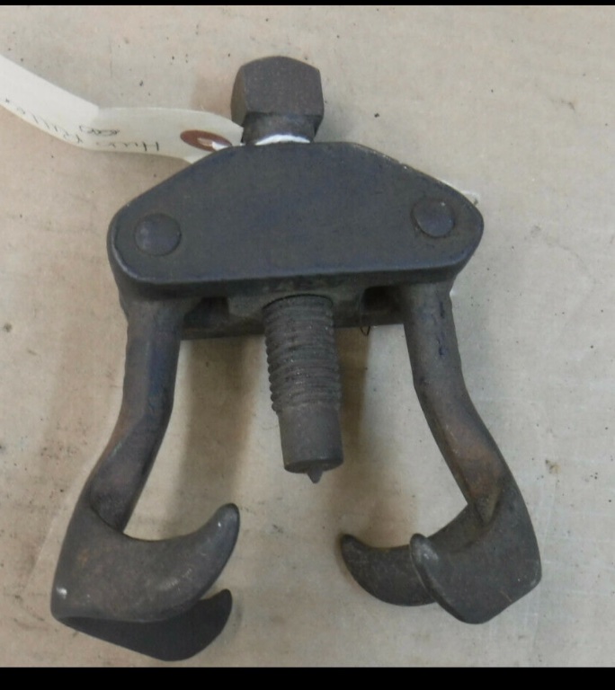

The tool that may well have cracked it could have been an APCO wheel puller which hooked 2 opposing spokes with heavy arms/hooks and had a heavy duty jack-screw to break the wheel away from the axle. I own one as a collector piece, and have always imagined it producing the exact stress crack that you have.
As mentioned elsewhere, that crack has most likely been there for a very long time.

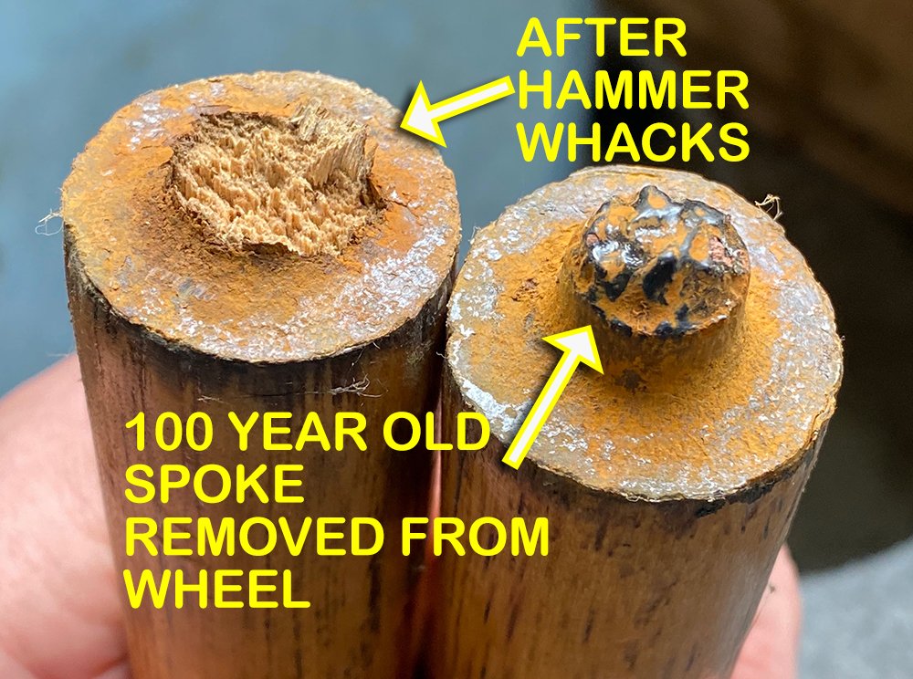

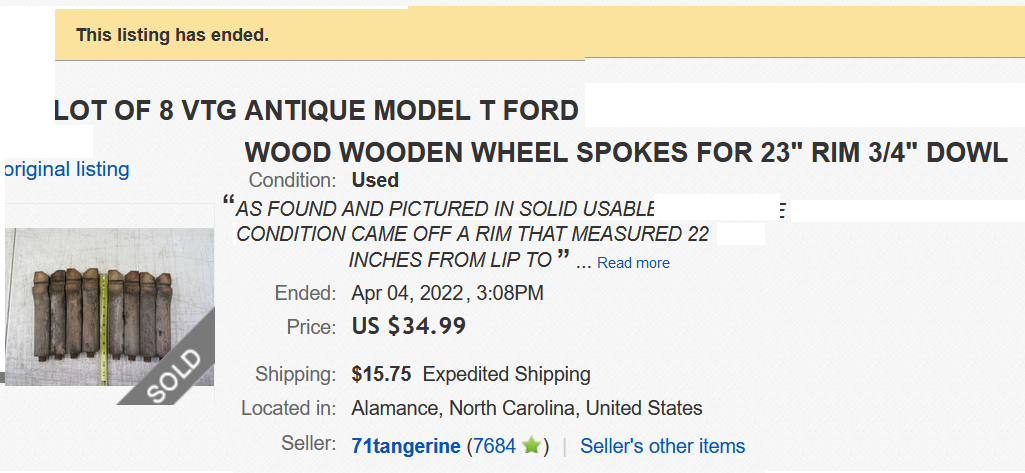

Sell your old spokes on eBay they are worth $3 to $4 each to wood turners & people who make pens out of them. Bundle of 10 for $40 + shipping. Since they turn them down not much difference in value for top layer

Wow! I didn’t know Apco made a wheel puller that used arms that gripped the spokes!
Ill bet not any of today’s Model T owners would use one of those. Even with a new spoke job from Stutzmens I sure wouldn’t do it and Im almost sure nobody else would either.
That’s one tool I bet the tool collectors would want. Maybe somebody on the forum has a picture of one. Thanks for a very interesting update Scott!

I'll try to remember to snap a picture tomorrow.
When I saw it, I thought it was so ridiculous, I had to have it.

If you have repro 09 -10 rear hubs that are thin in the neck area, the pullers that pull on the spokes are the best choice as the typical pullers that pull on the hub threads can break the hub. I had that experience. It's no fun replacing a hub on a painted wheel.
That one cracked spoke wouldn't bother me. I've seen a T run down the road with a number of spokes removed from a wheel, believe it or not!
As others observed, that crack has probably been there for years with no adverse affects.

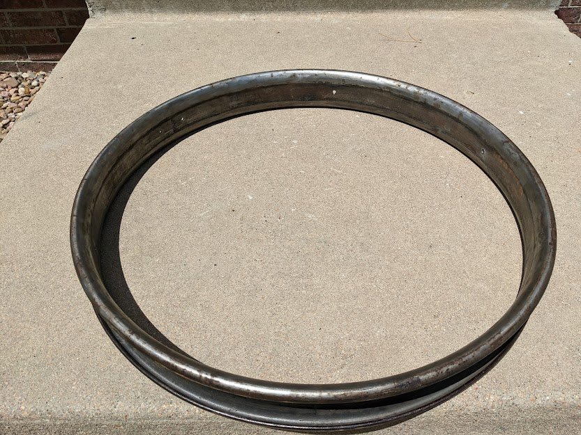

Re: Thoughts on when to get wood wheels rebuilt?
Today I took the wheel apart with the cracked spoke. In addition to being cracked about half way through the spoke, there are cracks going lengthwise in both directions from each edge of the widthwise crack. I suspect that Scott may be right on the cause of the crack. If not, something must have hit that spoke to do the damage. It could have been there a long time, but unlike our bones, it wasn't going to heal itself and there is no way knowing how long it would have been OK to use as is.
The cracked spoked aside, I found that the wood was in amazing shape. The spokes and felloe joints were tight and I had to work quite a bit to get some of the spokes loose enough to come out. No rot or deterioration whatsoever. What I was also amazed by was the lack of corrosion between the bare steel hub pieces and rim to the wood. Here is a picture of the rim after I knocked the felloe out. I had already removed the paint outside of the felloe before noticing the crack, and except for the paint line where the edge of the felloe was, there was almost no difference between the recently stripped outer edge and the portion of the rim under the felloe. Certainly the 110 years in California were kind to the wheels from a corrosion and rot standpoint.
I still think getting this wheel rebuilt is the correct thing to do given the nature and extent of the spoke crack, but I have to admit, it was a shame to take apart a very solid wheel. The others appear just as solid, and thankfully no visible cracks on any of them.

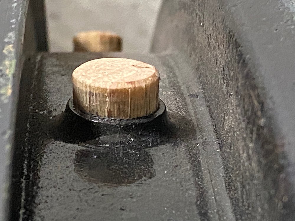

On my wheels that I rework, I purposefully leave flaws somewhat exposed. I want the warts and repairs to be visible so that someone can know that is a spot to keep an eye on.
Wooden fellies do often begin to split around the spoke tenon. A little soapy soak and my big blacksmith's vise can press them back to shape. A good cleaning and good gluing pressed in the blacksmith's vise again and the felly should be nearly as good as new. But I don't stop there. One or two steel rivets put sideways through the felly at the site of the split and that felly should never split again for many years. I do not nicely finish over those rivets. I leave them showing so that their presence is not forgotten.
The typical wooden felly model T wheel has six rivets going through the felly into the steel rim. Two at each join plate, and usually one slightly off center in each of the two felly halves. I usually add at least one, usually two, and depending on various concerns, I have added as many as four more rivets into the steel rim.
