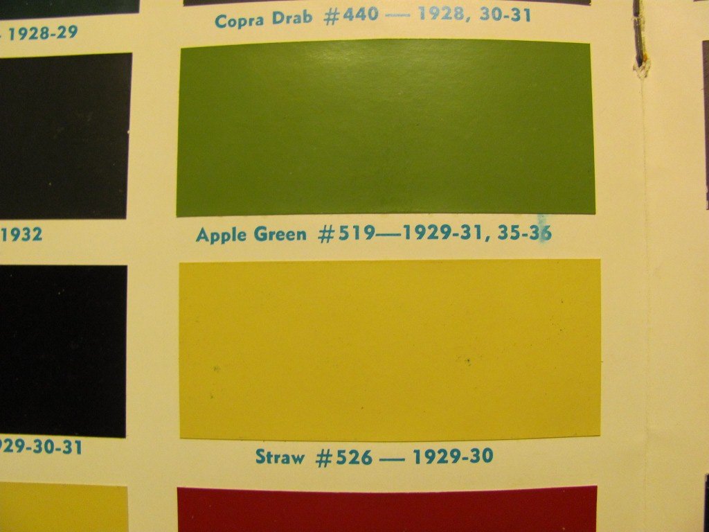

Post by Rich Eagle » Sat Apr 30, 2022 1:19 pm
I'm not sure how close it is to the model A color discussed here.
http://www.mtfca.com/discus/messages/11 ... 1292020911
"The old Ditzler DAR (acrylic enamel) number for Straw is 82302"
Steve Jelf, Parkerfield KS on Monday, December 21, 2015 - 10:37 pm:
"For other years, the encyclopedia has the scoop."
And from the MTFCA Encyclopedia (last resort :lol: )

Several years ago I requested the Ditzler archives people to provide a modern cross reference for the straw wheat color. This is what they recommended:
The important code is the Toyota color code. There could be a problem getting a current formula, since this color is for a 1974 to 1978 Toyota. The Toyota paint code is 528.
http://paintref.com/cgi-bin/colorcodedi ... 2&rows=200
Ron Dupree
