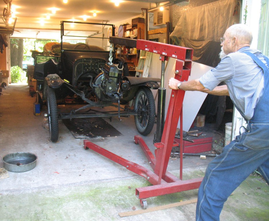

Posts: 7393
Re: Removing clutch peddle before engine removal.
Post by Steve Jelf » Mon May 02, 2022 11:43 pm
If a person of the elderly persuasion can do it solo, I bet you can too. :D
