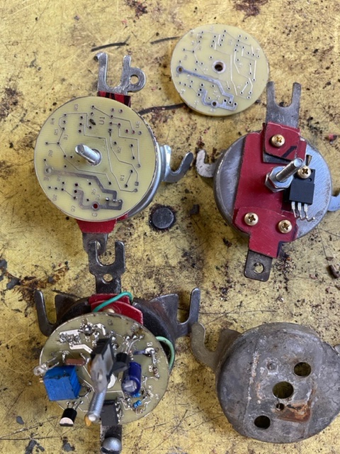

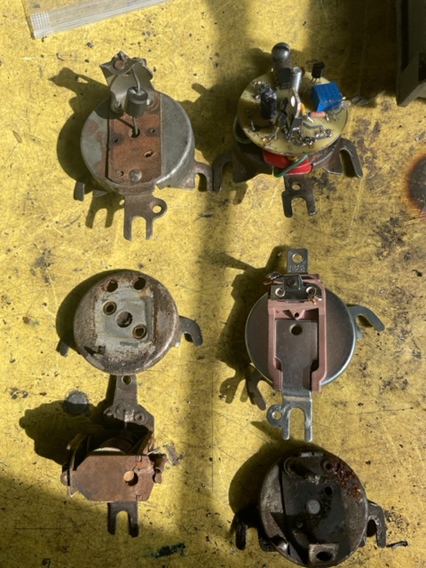

I have started to populate two more PCB using the LM383 design, one for my speedster and one for a Forum reader who want to try the device under typical conditions. While I have not run into any serious electronic problems, I am stalled due to a household emergency of the laundry drain completely failing. While I am working this drain problem, I spent a few hours looking at the seven regulator cases I acquired at the Tulare swap meet.
The results are not encouraging. Only two have the Ford script and internally they have a different construction. The other five are different again, only two out of seven have the exactly the same physical construction.
My PCB design needs a central hole on the base of the case. Four have such a hole so there is some hope, but one of these has a complex molded insulation base and is unusable for my PCB design.
Bottom line that based on my sampling, it is very unlikely that any PCB design can be configured to fit every regulator case that Ford and subsequent vendors supplied.

Tony can you post a picture of the type you need & will work?
Also post a picture of one that won’t work.
Best John
Best John

TonyB
- Posts: 663
- First Name: Tony
- Last Name: Bowker
- Location: La Mesa, CA
Re: A $20 (or less!) DIY regulator, and other issues
Below are a couple of photos, the first shows the internals of some of the internals of the regulator I acquired at Tulare
You can see the different holes in the bases and the different insulation techniques employed. I also included my prototype design showing the round PCB. My design needs several holes in the base and the heat sinking of the diode needed a custom hole in the base. Eventually I chose to scrap all the original insulation and drill holes where I needed them, so with a little mechanical work I can use virtually any existing base. To get things lined up I prefer to use the existing three the two holes for the battery connection and the center hole. I then drilled the other two holes to meet my needs. I replaced all the existing insulation and used my own design. Lots of work but it’s only free time. The second picture shows the different stages of construction.
The base on the lower right doesn’t have the three holes I like to use a guidance.
As an aside loading this took much more effort than I think it should. First l loaded my 12meg pictures and they were rejected by the site. I reduced then to 3meg withe the same result. I then took the down to 300k and they loaded but the resolution is barely adequate.

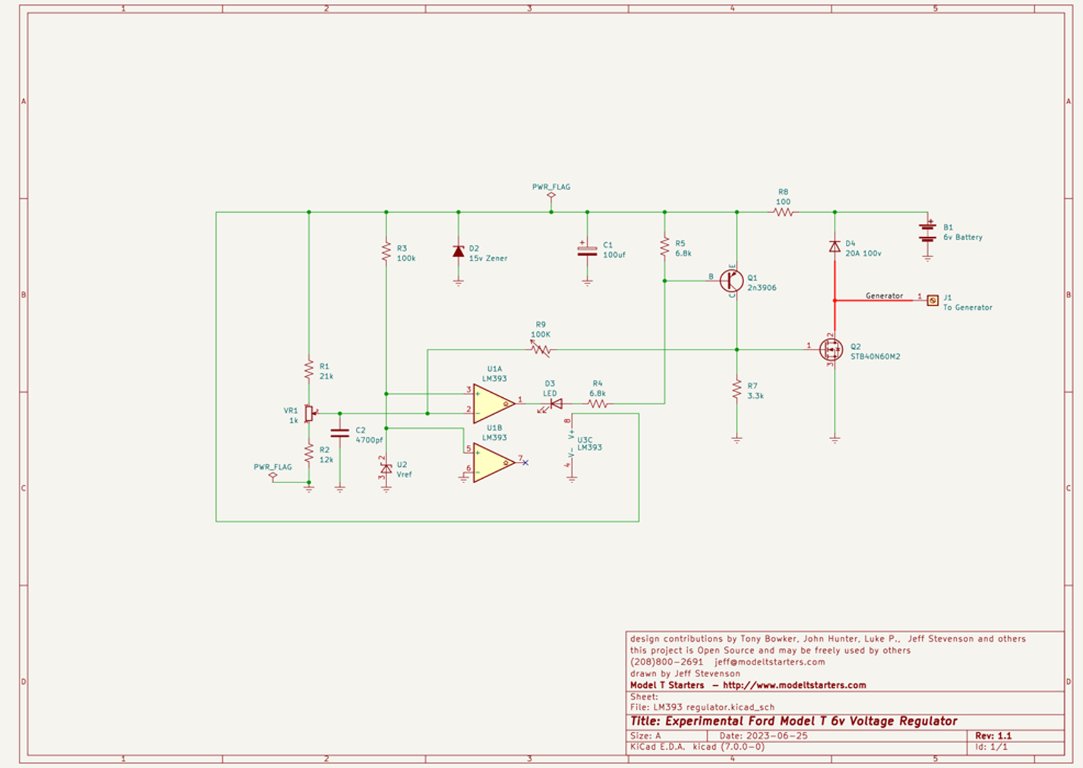

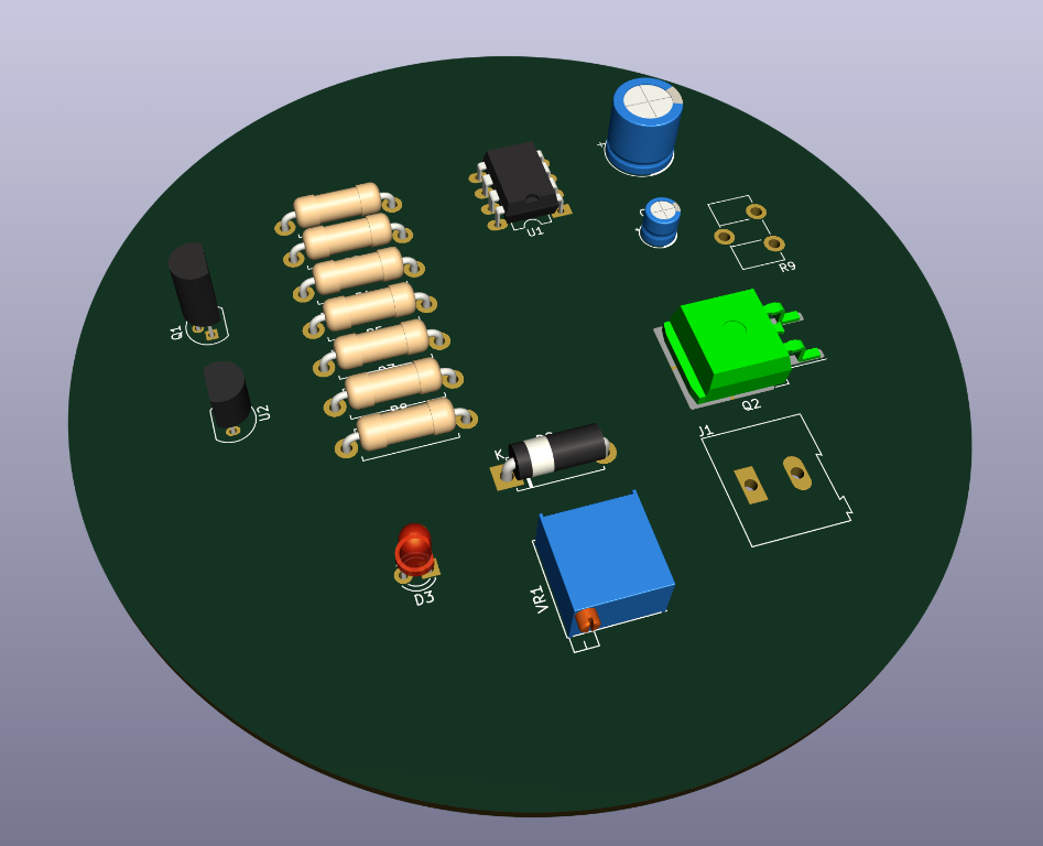

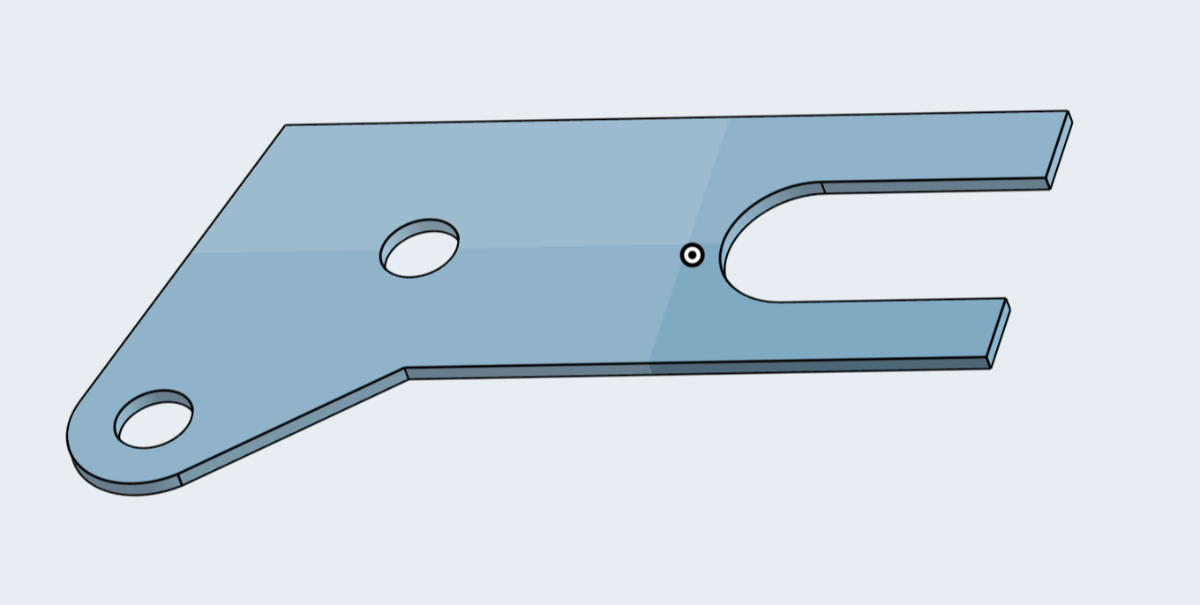

So based on the extreme interest in this project (users who want one), I'm resurrecting it and updating it. I re-drew the schematic in KiCad. Tony's was a good first pass, but after real world tests over the past year it's necessary to do some updates - especially mounting Q2 and D4 for heat-sinking on the housing. Its attached as a PDF and image. I've also triple checked all routing and components. If anyone spots an error, let me know. I did change R6 to a trim pot as adjusting that seems to help w/ oscillation.
The single biggest challenge is finding a suitable housing. I'm in contact with New-Rex about the housings they get and that looks somewhat promising. The owner has agreed to send me a housing to try out. I may be able to purchase 25-50 of them at a time. Once I find a housing that works, I'll finish the printed circuit board. Placement of Q2 and D4 will affect the final layout slightly.
I must say, KiCad is quite amazing. This is a simple project but it took me MULTIPLE DAYs of watching instructional videos to get this far. Its actually my idea of fun
The time and effort it will take to go through w/ all of this, and finally assembly build time will ultimately dictate pricing, but my plan would be to sell printed circuit boards if someone really wanted to do it themselves. I know how cheap Model T guys are... I doubt I'd be able to sell the housings by themselves depending upon what NuRex's terms are.
More when I know more.
Jeff
Jeff

Thanks Jeff for resurrecting this. It was really lack of a standardised cutout housing that stopped the project going any further in a commercial sense. The PCB designs that Tony and I developed for our respective cutout housings only suited those types. I have Tony's files for his PCB design if you still need them, but as I recall a few modifications were needed. My own regulator is still going well after about 18 months and 4000km of driving.
AdminJeff
John,
thanks, but as you can see, I'm way past the circuit board part now! KiCad to the rescue. I'll finalize it once I solve the enclosure problem. I just got off the phone w/ John Regan. To say it was unproductive would be an understatement. Why some old guys refuse to pass their knowledge on is absolutely beyond me. EVERYTHING this old guy does I document on my website and here for others to learn from. Sure I charge $ for my product, but if you want to do it yourself, HAVE AT IT.

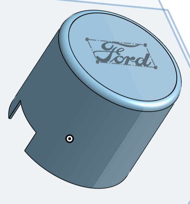

The whole Fun Projects situation is a fiasco. I think FP was sold to Birdhaven who was then sold to Texas T Parts or some permutation thereof? Anyway apparently the guy who bought the regulator biz from Regan isn't going to ever do anything on that front. What a total waste. I wish I knew who it was, as John made 30,000 of those cutout cans. He wouldn't actually say it, but I surmised from our conversation that there are a bunch of cutout shells he sold w/ the biz that are just sitting around collecting dust at BH or Texas T or wherever.
I know I could do a complete, fully dimensioned 3D design of the can (I use OnShape 3D) but I haven't a clue how to go about finding someone to make it. There are 4 distinct metal pieces needed. Any ideas, speak up!
Jeff

Jeff,
As with John I'm pleased you're following up with this, thank you. Tony did a lot with his PCB and was keen to keep things simple and not get too involved with the mechanics, however I think you're right and that for this to be useful to the majority of people there does need to be a suitable housing.
With regard to producing housings I imagine there'd be various sheetmetal manufacturers in the U.S. that could do such a thing? Here I'd select a place with a die stamper and maybe laser cutter, present them with a model (I expect an old housing would suffice) and they should be able to give a price to produce X number from a sheet of say 26g or whatever. Typically there's a setup cost but that should be easy to account for per unit.
An alternative might be to have a go at producing them yourself? Could be an interesting journey to the perfect housing and one which it would seem various manufacturers have gone down over the past 100 years. Given the demand is uncertain at this stage it might be worth doing an initial small run at home to gauge interest. If it was high you might then choose to have them done in bulk eventually, if not then it could make a nice little cottage business with your new skills.

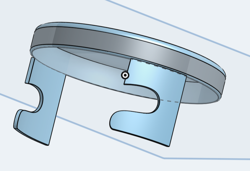

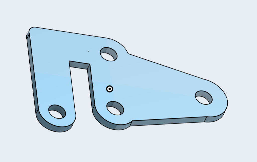

Here is an example of how I'd go about making a top cap with simple machinery such as a lathe to make the dies, and a hydraulic shop press to draw a metal disk into shape. Assuming a 'standard' type housing I expect that one or two passes would suffice: https://www.youtube.com/watch?v=-tZWlA6HRSk
Luke.
