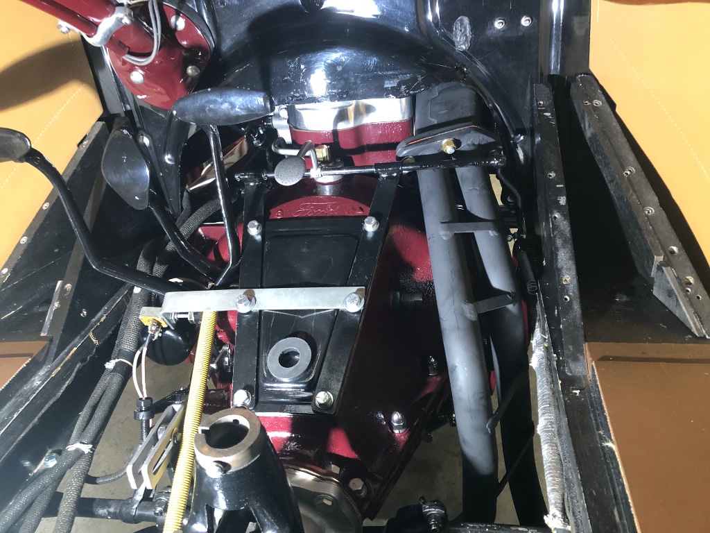

Before you think 'this guy is all over the map'......I'm only curious and won't be looking into this anytime soon. I was just looking through Lang's and I see they offer a dual exhaust manifold for the Model T. Has anyone here tried it? What does it sound like? I had duals on a '50 Chevy 6 and really thought it was pretty cool. (for a Chevy, right?)

TRDX2. Funny how the Speedster project is still alive. Thanks for the link to it.

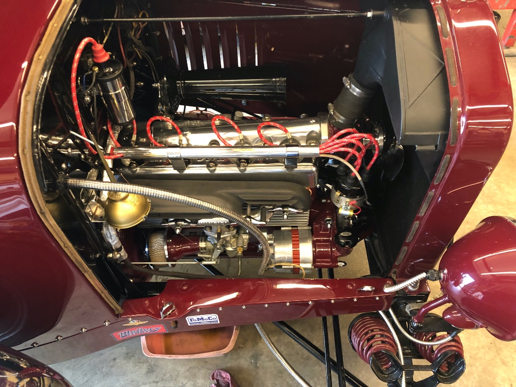

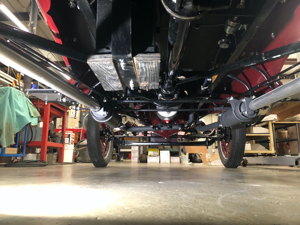

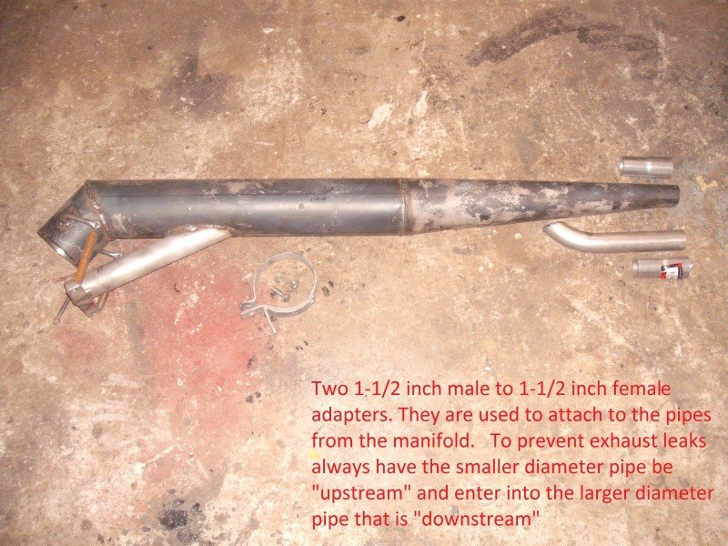

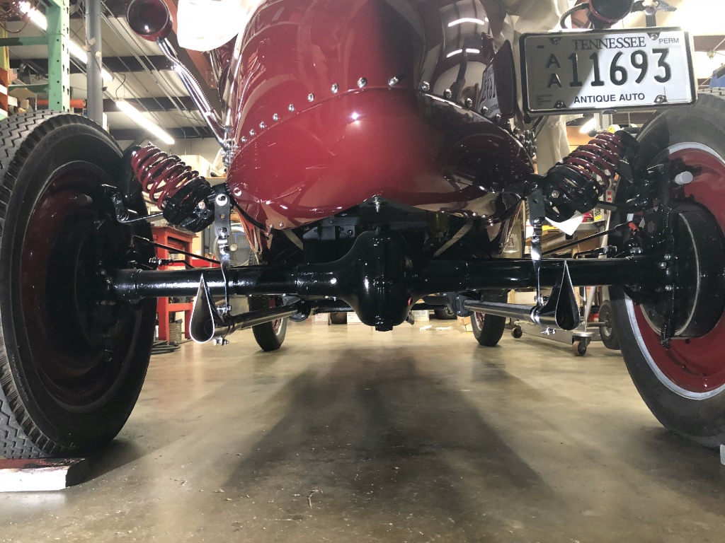

CatGuy. The link shows the duel exhaust manifold Lang's sells, feeding a Taylor Loudspeaker muffler that I reproduced using an original as a pattern. There is nothing like the sound of a dual exhaust T. Into a large expansion chamber "dump" style muffler.

That is very nice!
