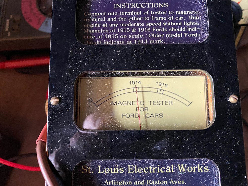

Our club has a Fun Projects replica of a St. Louis Magneto tester. It is designed to show if a mag is producing a proper output and works at any RPM above idle. When I tested mine, it indicated output correct for a 1914, even though I have a 1917. Not a big deal as I'm not trying to run headlights, just the ignition coils.
- Posts: 7393
Re: Magneto output
When I tested mine, it indicated output correct for a 1914...
That should be enough to start on MAG.
