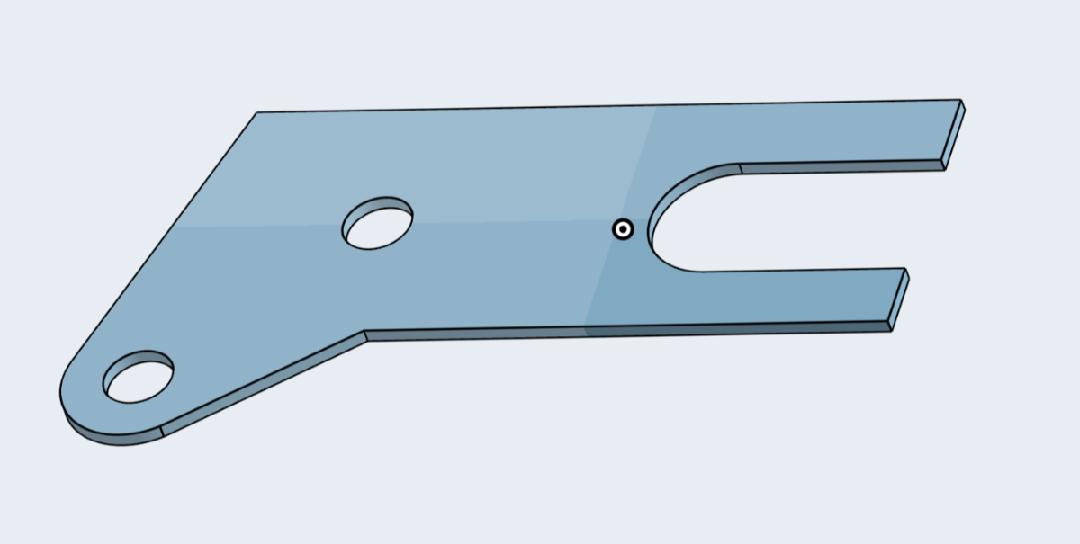

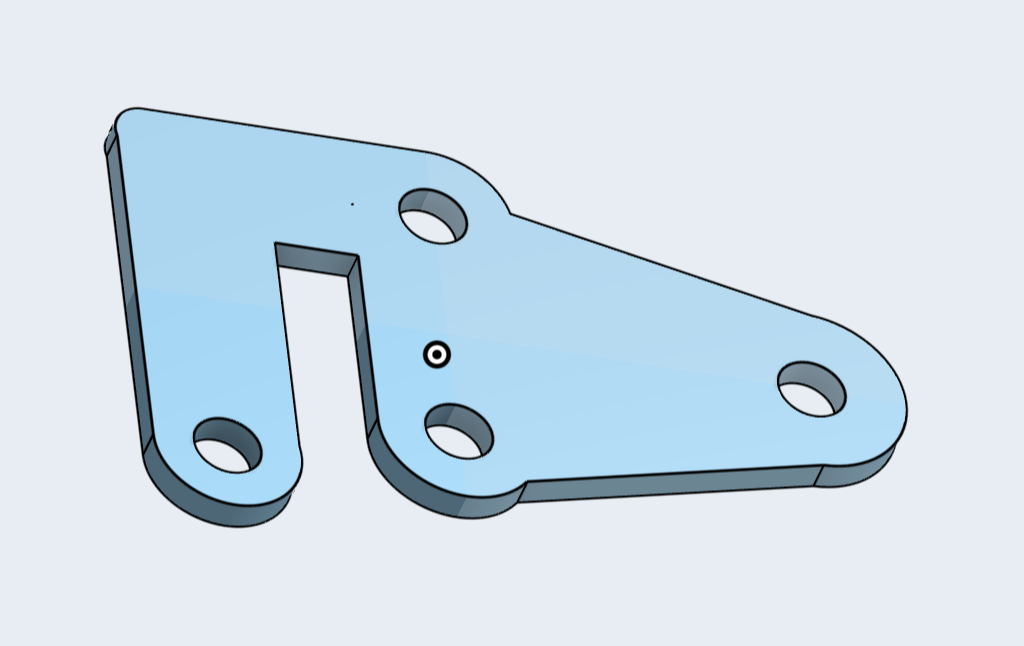

That is the conclusion I came to as well, which resulted in the complicated bracketwork for the housing I ended up using. It's not so much the PCB itself, but the mounting of the two power semiconductors.
By the way, I've had a 12V positive earth FP regulator come my way a few days ago. I had to modify it for negative earth. The FP housing is certainly very user friendly.

I talked to the owner of Nu-Rex today. Why are some of these vendors such jerks? I quote "I literally want nothing to do with this project." I even offered to sign a non-compete (he makes 6v diode cutouts).
At this point, as far as I'm concerned, game on, now I also see diode cutouts in my future. I finished the 3D dimensioned can design today. Of all the cutout style cans I've seen (and I've seen LOTS), the one John Regan had made as it is the best suited for mounting components & a circuit board. If it comes to it, I'll have the cans made. I already have a quote for cans made in Hunter's favorite country. Cost is $1.61 at qty 250 plus $2,500 tooling fee. I'm going to get more quotes. If anyone has any suggestions, I'm all ears.
. Battery Electrical connector Generator Electrical connector
