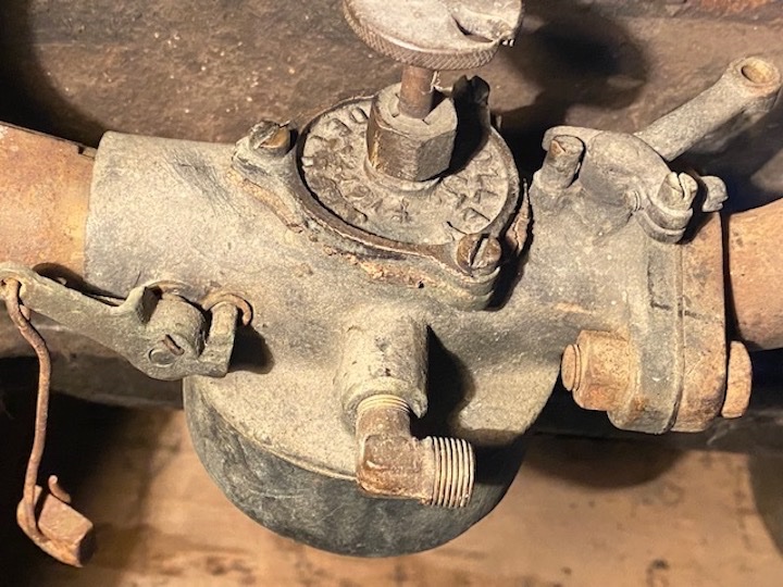

I have this mid-teens(?) Holley G on a spare engine that apparently powered a saw bench way back when.
My 98-year-old Model T friend was over the other day and opined that it was a desirable unit for my newly-rebuilt '26 Touring engine (Z head, bigger valves, advanced timing gear, TW timer, well-balanced, hi vol intake manifold).

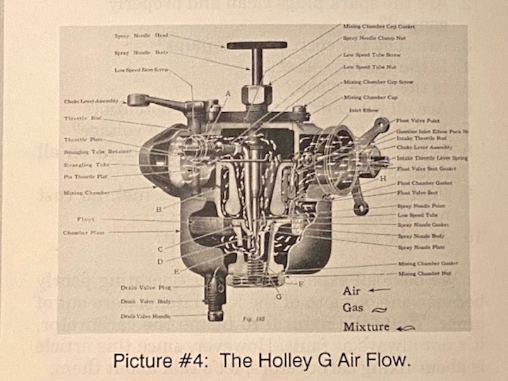

I read up a bit on this carb in the MTFCA Carburetor book... it looks daunting to disassemble and rebuild and the airflow passages would appear to to stifle breathing rather than enhance it.
I would like to hear from the forum on this question. Many thanks!

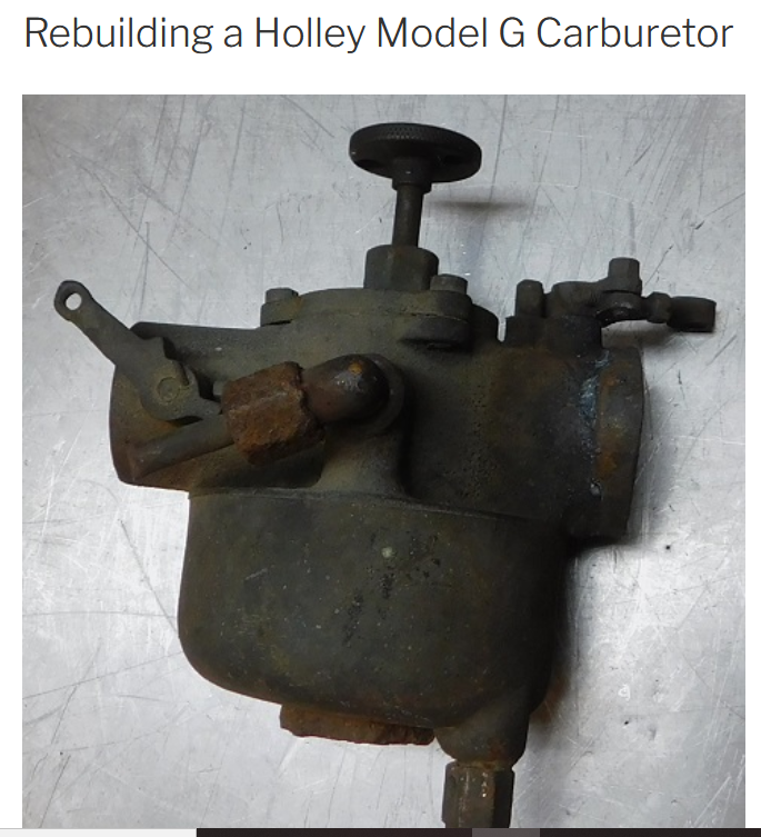

In case you want to rebuild it. open the link https://modeltfordfix.com/rebuilding-a- ... arburetor/

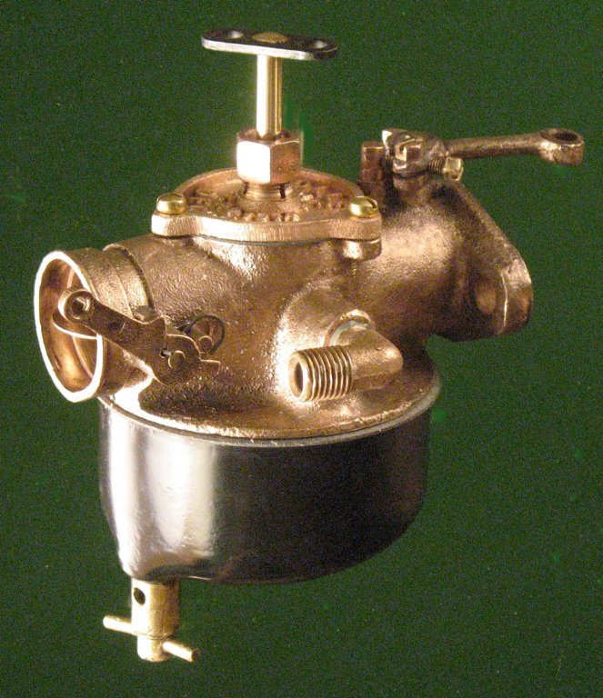

If a mid-teens, it's a bronze body carb which looks terrific redone and polished (it's the simple things in life

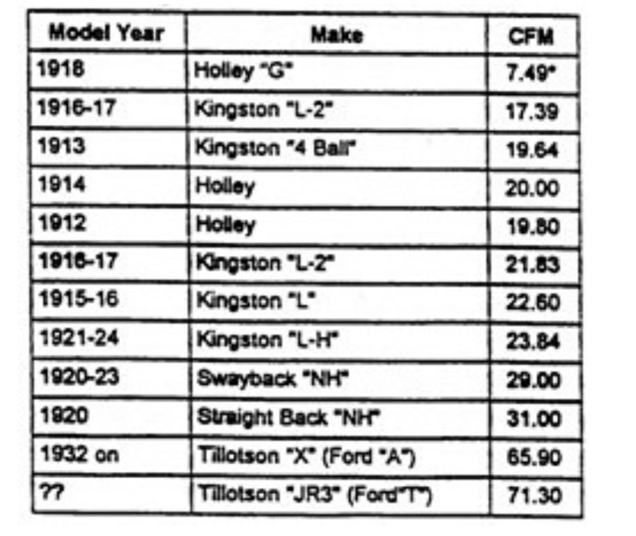

This flow chart has been posted before. Shows the G is rather poor at velocity. Holley NH is better choice for performance.

Is the G cfm really only 7.49. Must be a typo. Yes mine runs out of steam at 40 but sure does hand crack easy and purrs right along at 30-35.

The chart that Dan posted pretty much tells the tale for stock carbs. If you want CFM, then a Stromberg OF (or similar) would be at the top of the list...if it was on the list. That said, those carbs including the OF were designed for a stock engine.

I question this also. I would expect a CFM around 20, as in the 14 carb. holley. Arent the basically the same carb?Mountainrider wrote: ↑Sun May 08, 2022 3:40 pmIs the G cfm really only 7.49. Must be a typo. Yes mine runs out of steam at 40 but sure does hand crack easy and purrs right along at 30-35.

George is right. The bronze ones sure do clean up pretty.

Looking at the great CFM chart & wondering:
1. Is the small 7.49 CFM for the Holley G a typo?
2. Any idea what pressure drop these CFM were flowed at? So many standards have been used, 1.5" Hg=22.5" Water, 3.0" Hg=45" Water, also 21" water, 28" water, 41" water.
3. I've looked for the link discussing this chart but cant find it, any ideas?
Nowadays the standard is 1.5" Hg = 22.5" water for 4bbl carbs, and 3.0" Hg =45" Water for 2bbl or 1bbl carbs.But even now other standards get used.

That chart posted came from older source, but couldn't find the ref.

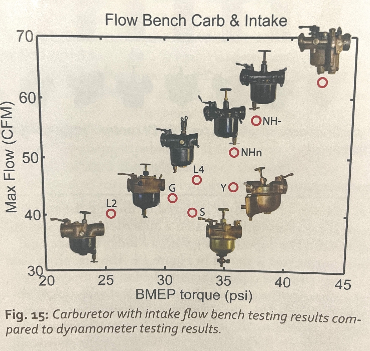

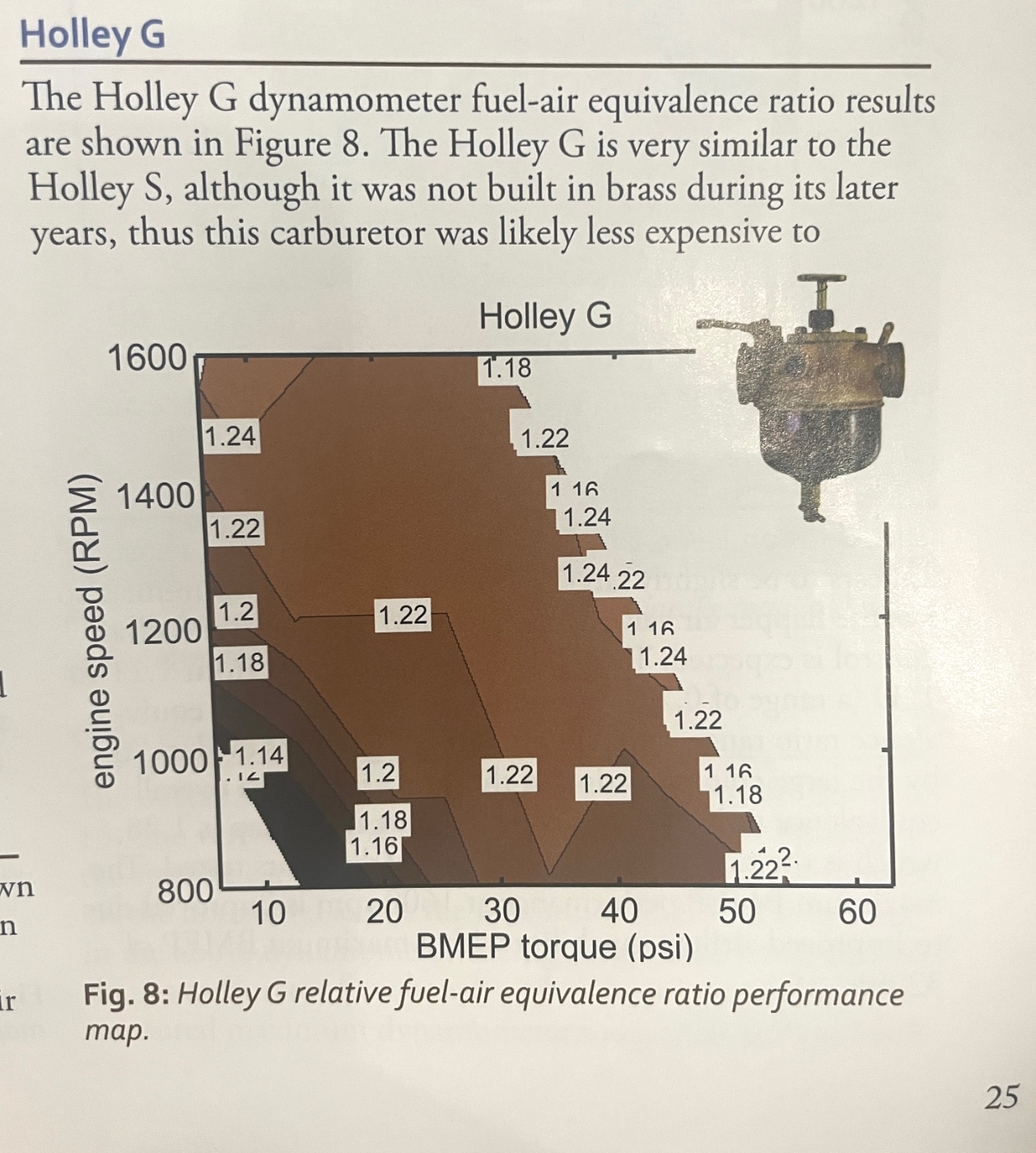

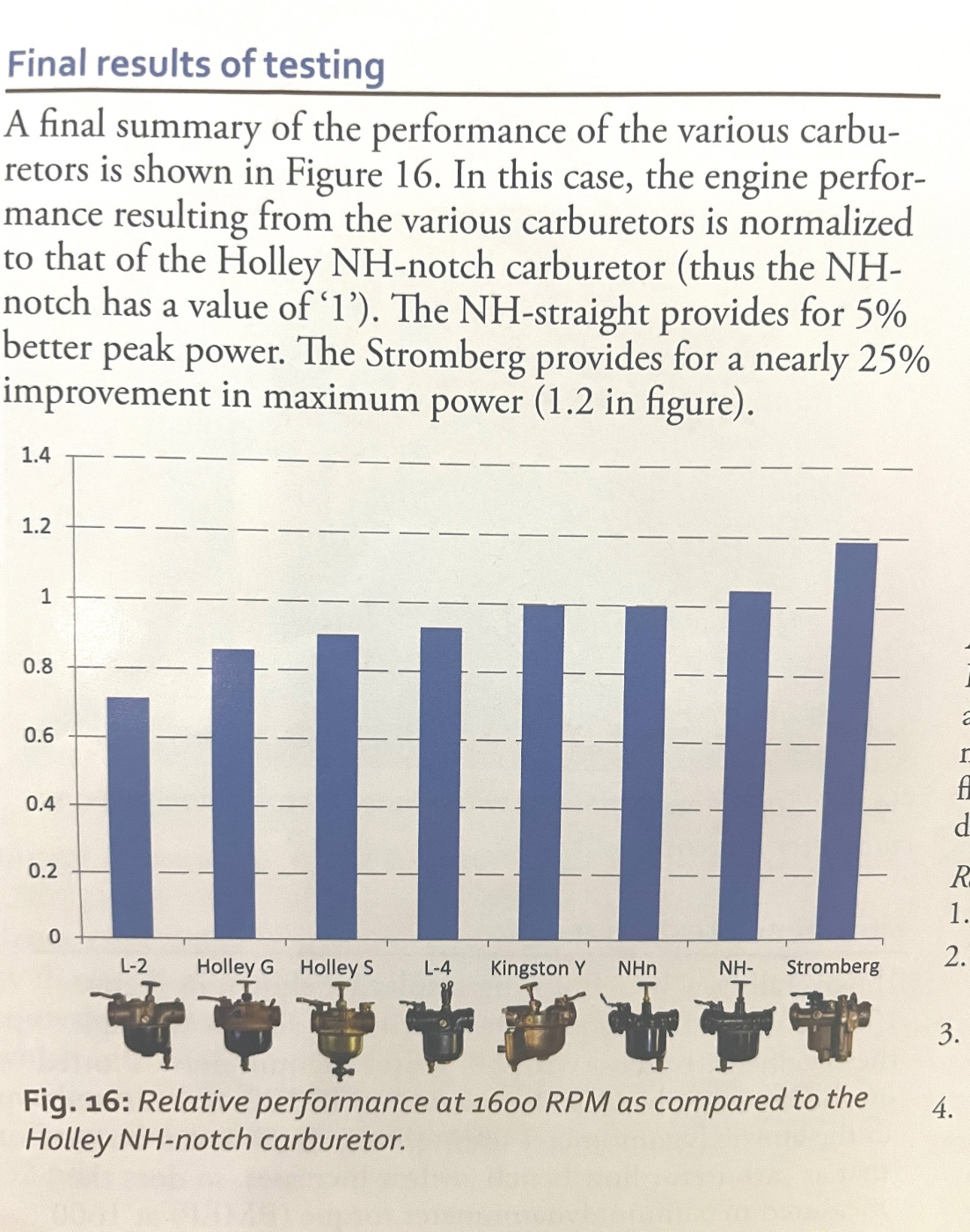

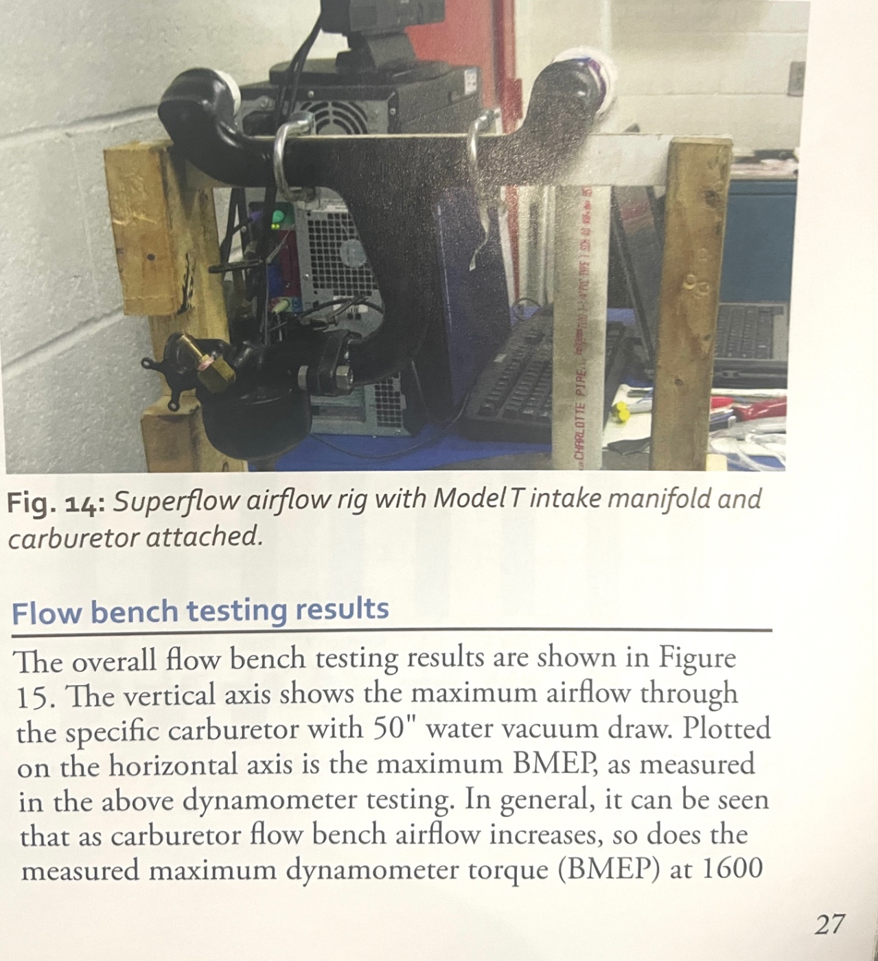

There was a rather detailed evaluation by Dr. Jim Cowart, U.S Naval Academy in the Model T Times, March/April 2014 issue,No. 390. A pub of MTFCI, there may be old copies avail from the club.
His article reports results of two variables tested, air-fuel ratio and torque at 1600 rpms, for the more common Model T carbs ('13-'26), and the Stromberg OF.
Below are some of the graphs of his study, the Holley G did perform good in flow bench (using a stock iron intake), but only midway in dynamometer testing.

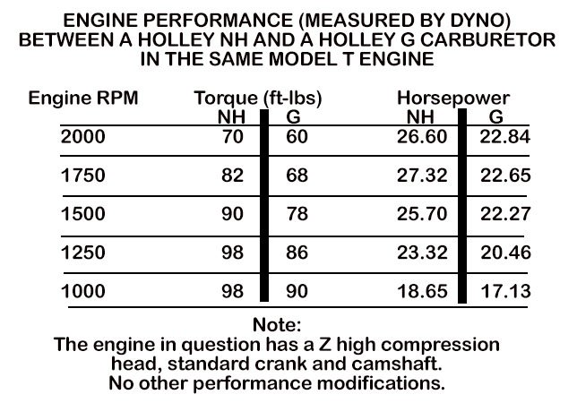

I started with a Holley G on my '17. Started great and ran smooth. Got about 20 mpg
Replaced it with a swayback NH - takes a little more coaxing to start, runs smooth. Get about 20 mpg.
I had some engine work done at a very reputable shop and just for fun, while my engine was on a dyno we tried both a Holley G and a NH carb on it. Here are the results.

Wow thanks for sharing that dyno data. Looks like quite an improvement with the NH Holley.Oldav8tor wrote: ↑Thu Sep 05, 2024 10:43 amI started with a Holley G on my '17. Started great and ran smooth. Got about 20 mpg
The Z head gives about 6.0 compression ratio right?

Great excerpts thanks. Now I need to hunt for the whole article. I looked on the MTFCI web, they sell a flashdrive for $99 but I dont see a way to get just the one issue.DanTreace wrote: ↑Thu Sep 05, 2024 9:17 amRW
Do you know if the dyno was an otherwise stock Model T engine?
When I calculate engine Torque from BMEP as T=BMEP*CID/150.8 they come out awfully low but maybe that's explained in the article.

RW - the Z is called a "high compression" head but it's only a slight increase. The chamber design should result in more efficiency and as you pointed out, increase the compression ratio to around 6. Here is info on the "Z"
