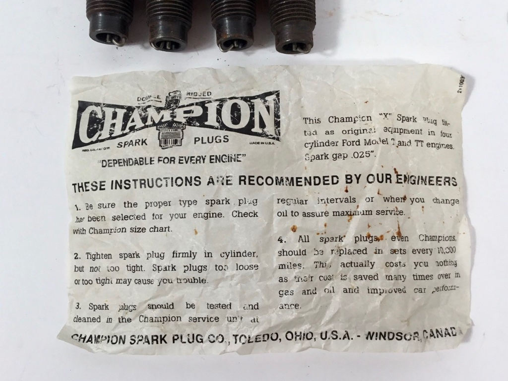

Post by jiminbartow » Sun May 08, 2022 11:12 pm
The directions for the Champion X spark plugs says .025. On the advice of a member of the forum in 2010, I had mine set at .030 for years and the engine did not run well. It was only when I re-read the instruction sheet that I realized they were set wrong. When I reset the gap at .025, the engine ran beautifully. Jim Patrick

Post by speedytinc » Sun May 08, 2022 11:51 pm
I found over .025 would spark intermittently using a champion plug tester @ 80#. Had 1 plug needed .024 to fire consistent. Champion used a25 plugs. Ran well after resetting for a 35V magneto output ignition. I do set distributor plugs @ .032
