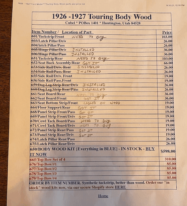

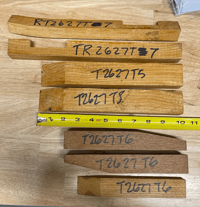

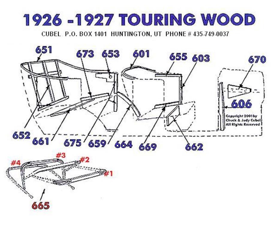

Now on to what I'm trying to figure out. Each part was labeled T2726T and had a number 1-16. I'm trying to take the list from FORD WOOD and match up the numbers so I can use their diagram and see where they go. Here is what I have. That last piece of wood labeled T2627 T6 is the same shape as the other two labeled T2727 T6 but a lot thiner.
and what I have Identified on the FORD WOOD list
Can someone tell me that for example T2627 T7 is number 603 and 604 Etc....
Thank you so much.

The top two pieces (-7) should match up with 603 & 604 in the list. The notches are for clearance with the door striker hardware.
