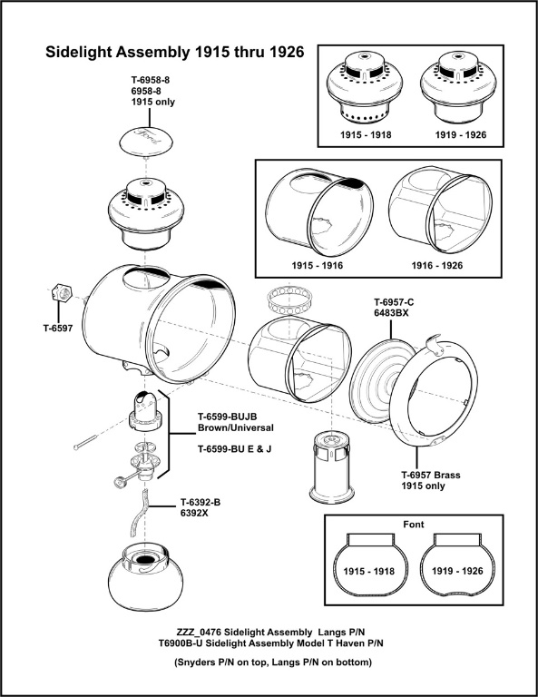

Believe this sketch has been reviewed and should be correct for the parts of those side lamps to date them.

Thank you Dan....that'll do it. Now I have to go look at my 15 to see if one maybe got swapped somewhere along the way and I missed it?

George, if it's any help, the round innards are usually brass, and i believe they were nickel plated over the mill finish, so not polished.

Dan, that one didn't go through a correction cycle because it wasn't necessary, I drew it from one off my car which had the squarish inside and I foolishly thought they were all that way, until Steve Jelf informed me as to the round interior of the 1915-16's. Also that the chimney and font's were different too.
I've been thinking of taking the Snyder's part numbers off because at the time of this drawing I was only doing them for myself, so I wanted part numbers from at least 2 vendors, but now I only deal with Lang's. I've also been looking for the factory numbers for the parts too, probably going to have to get the drawings (or at least as many of them as I can find) and get them from there for both the Side Lights and the Tail Light.

Thanks for the drawings Martin.
