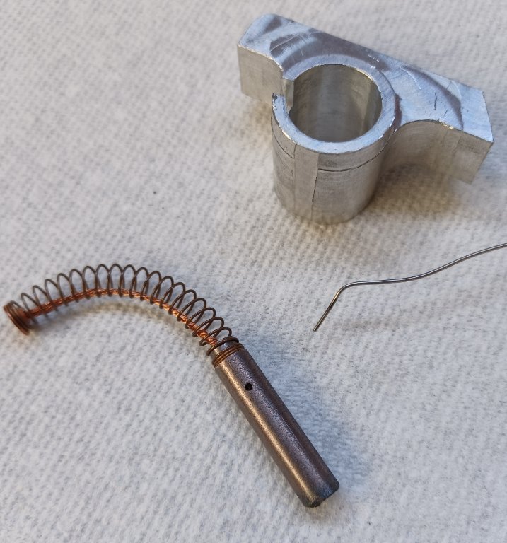

TW timer 1/4” round brush
Does anyone know the length of a new one. I love how my T runs with this timer. The brush is getting quite worn down. No brushes available anywhere, but I’m sure I can make a new one.
- Posts: 5129
Re: TW timer 1/4” round brush
Google their website. There is a picture. Scale it up. It looks to me about 1 1/4" long, not including the spring.
You should be able to tell by compressing the brush in its holder & doing a bit of math.
If you post a photo of the brush, I just may have one. I purchased a collection of timer brushes a year or so ago. While many are the standard brass or steel stock Ford ones, I also have several unique accessory ones.
Looks around an 1 inch long. Found several sources online. I’ll get one ordered and if it works I’ll post it.
I believe Tony used a brush from McMaster-Carr. Item #65705K48. A word of warning. If you can feel the edge of the contacts in the housing, it needs to be remachined. If not the brush will wear very quickly.
McMastercarr is where I found them. Order last
The McMaster-Carr brush part # above provided by Farmer J is made of graphite and I believe is too soft for timer application. I bought some and when drilling the small hole requierd for installation I found the brush was very soft. I suppose it will work but I wouldn't think it would last very long. The original TW brush was made of a copper/carbon or graphite composition.
The ones I got from McMaster-Carr are soft. I’m using my New Day timer until I find the right brushes.
