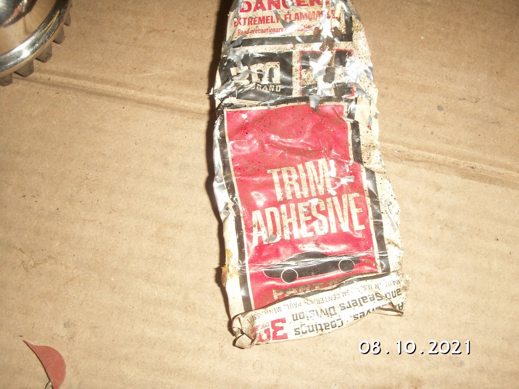

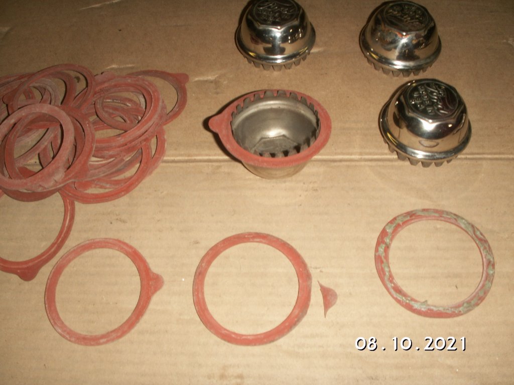

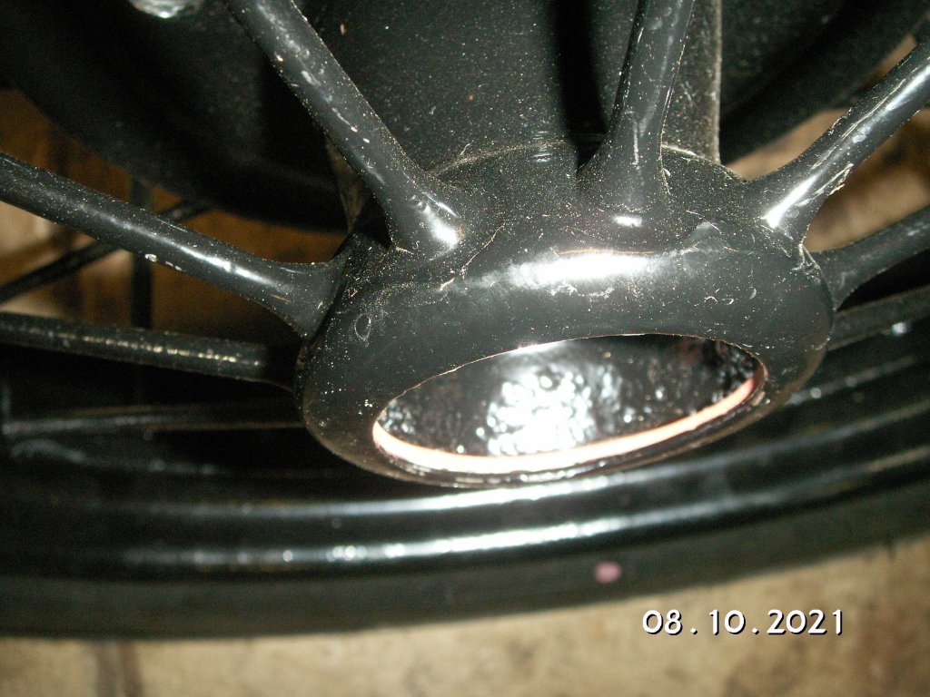

I did a kinda period correct fix on mine. I had some mason jar rubbers that I cut the tabs off of and glued to the inside of the hub opening then installed the caps bending four or six of the tabs over into the rubber, been a year now and so far no rattles. Jim
