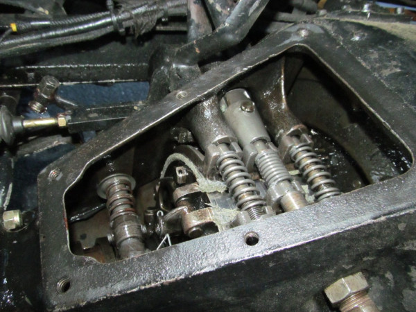

recently succeeded getting a '26 T running that came from an estate & know no history on (see thread "Distributor Question") Have not yet insured or registered car so only road tested on my dead end street. Engaging low & reverse creates a substantial chatter and braking is pretty poor. Removed trans inspection cover. Band linings appear Kevlar & are meaty. There is in place a transmission screen which was pretty clogged with greyish color lint. Screen has been cleaned and engine oil changed. I've had past experience with Jim Guinn's wood band linings which I liked. He recommends adding 4 oz Dextron trans fluid to engine oil to help chatter problem. What are pros & cons on doing same with Kevlar linings? I'm hoping to give the Kevlar a chance but would like smooth engagement Appreciate any input.

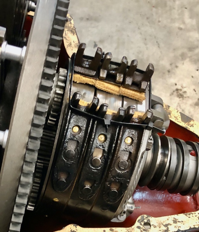

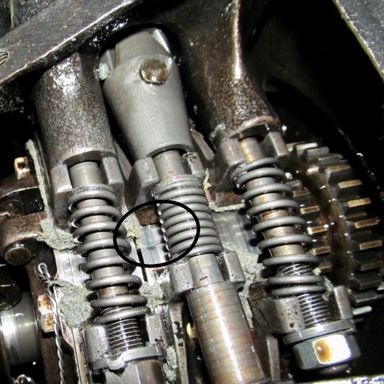

They must be badly glazed or burned. Good kevlars dont chatter & in fact feel like soft cotton lining. They can be removed & re riveted with the new side out. Hogs head must be removed . The worse news. That lint is a strong indication of a cracked drum shaving the band. Lift a wheel & have a friend turn the motor over whall you look @ the drum surfaces. That lint can get in the oil holes & prevent good internal lubrication. No additives are necessary & wont cure your problem.

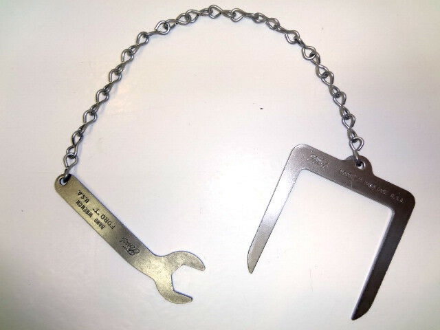

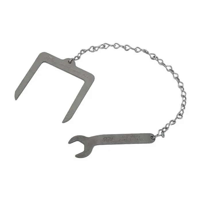

I don’t know why, but alot of people don’t like this tool, but I sure do. It prevents the bands from springing apart like Norman described and has prevented that from happening to me. I highly recommend it. Don’t forget the rags in the space to the right of the band nuts, all along the passenger side of the hogshead. Fill all spaces and take your time. Jim Patrick

This T on tour had hydraulic brakes, so band chatter was from low pedal, and poor low go, owner kept adjusting ‘worn’ lining til no more adjustment left. Taking off the inspection plate and looking close while hand cranking over showed cause of worn lining, years old worn down, sharp edged and now cracked drum eating that lining.

For one thing, Kevlar bands should never be refit through a hog's head door. They need to be PERFECT in roundness and not sprung at all. It is all but impossible to feed them through the door and not distort them...it is tricky enough to install them WITHOUT the hog's head and not spring them if it is your first time doing it. Kevlar is a miracle if you drive the car correctly and the hog's head is completely rebuilt and in perfect condition and the bands are completely round. Any deviation from the above description and you are headed for trouble and will become one of the folks who curse them for the damage they can cause.

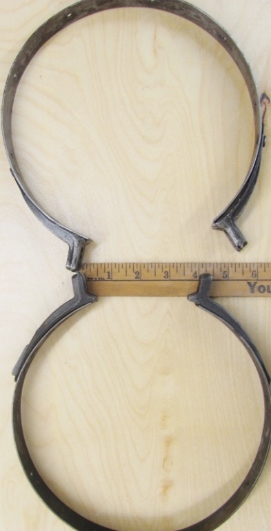

Today I removed the bands. I no longer believe they are Kevlar or meaty. 2 out of three have rivets worn a lot. To my surprise, all 3 drums & bands are narrow style. Brake drum has a score mark but not deep, no cracks in any of the drums and all the pedal ramps look good. I'm going to reline with Kevlar. What should the relaxed diameter of the bands be? As they came out, they measure about 9". My opinion is they should be formed to a slightly smaller diameter. Any suggestions?

When re-shaping bent or out-of-round bands, strive for a gap between the ears of the bands of 4" to 4.5". The band should be shaped to this contour prior to fitting the linings.
Band above in photo is prior to re-shaping.

All as Dan said...PLUS, when you gently pinch the ears "closed" the band should close as a PERFECT circle and not rub prematurely on the drum...even when ever so slightly larger than the drum, the bands must not have a preferential area where they rub...they must be totally free of the drum.
if at all possible borrow a used drum to use as a go-nogo fixture when making them circular
