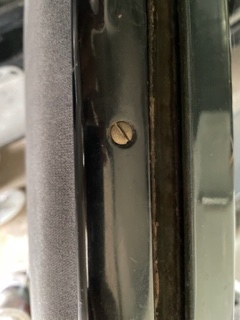

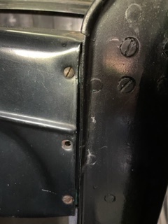

Hey folks. I am looking for some old stock interior screws for a 1926 T Coupe- matching existing well patina'ed slotted screws (flat and oval) for the door garnish and panel on which the amp meter sits (instrument panel). Does anyone have some old left overs out there in their garage, barn etc that they would be willing to part with for a price? Happy to buy them! Obviously I can go to ANY screw supplier but the new ones will stick out like a billboard. THANK YOU! Pictures attached.

Thank you Mr. Bartow. Every vendor sells the kits. I can even buy the #8 or #10s in some stores one off. Problem is I don't want new screws that look new and shiny in the car. It will look odd to me. I want to find some old well patina'ed machine screws lying around that will match what I have now. If I replace all the screws it will just seem odd to see all these shiny nickel things in my well aged 100 year old T. If I put in a few new ones next to the old ones, it will look even odder. I am hoping I can scrape together a few screws - 12 or less from a bunch of T folks on the Forum. Who else would have some - ie well patina'ed old screws they might have in their tool boxes over the years of doing repairs! You folks would!
Now if they were non visible screws - it would be a different story - but the Instrument Panel and Door Garnish are very visible.

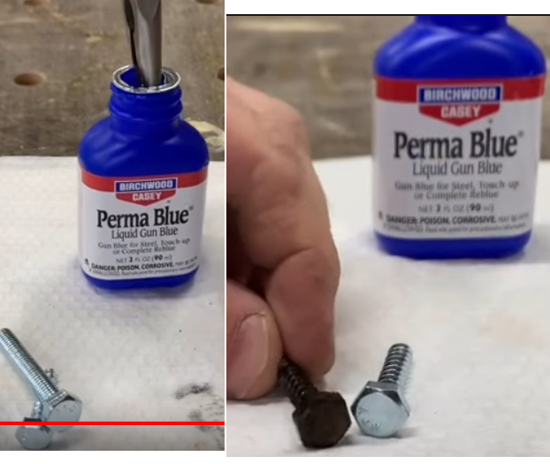

I was researching JUST that! I have seen the Bob Villa method and the permablue. The Perma will make things too dark. I will let you know on the screw sizes. I need to pull them out tonight or tomorrow. I am thinking oval headed #8 or #10. I will check the length. Guessing 5/8 or 3/4. But will pull a few of each that remain to make sure they were all same size. THANK YOUTRDxB2 wrote: ↑Sun May 15, 2022 2:14 pmIf you can find all of what you need you might try to chemically age them. I probably have what you need but sizes?
