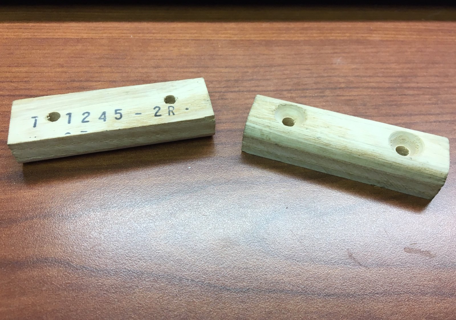

These came with the tack rail set for my 24 Touring.
They seem to line up with holes associated with the top pivots, but I can't figure out exactly where they go.
Can anyone shed some light on this?

Tack rail for the front or back seat?
My kit came with them too. I didn't use them but they are for attaching the rear tack rail section of the back seat to the two sides. I used metal ones.

I bought both front and rear tack rail sets at the same time.
But I think these were in the rear tack rail package.
