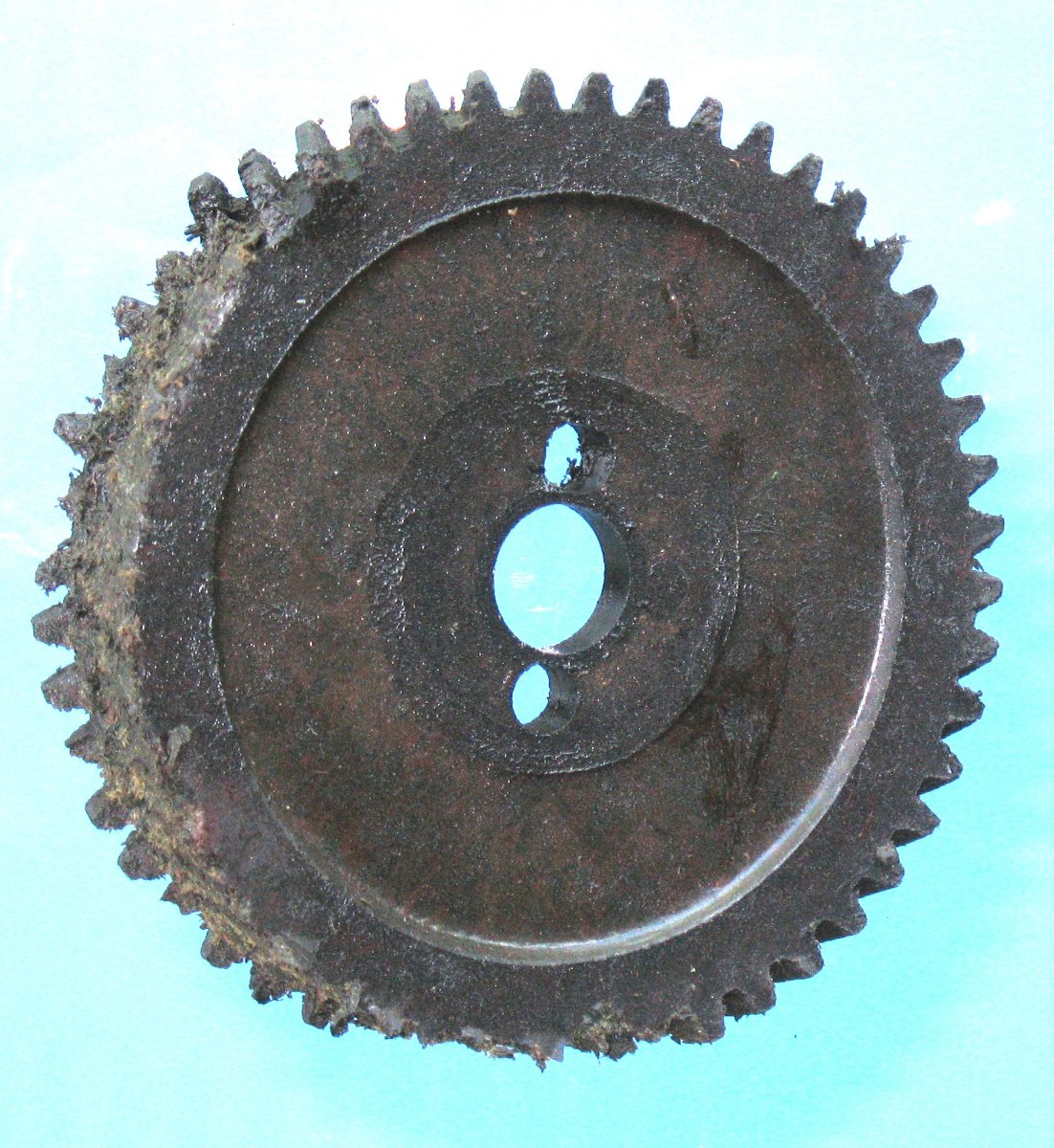

Concerning the fiber gear. That stood out to me as a potential problem. Might not be as big a problem on a car without a generator, but a big no no if you do have a generator. Also probably too soon for a timing gear problem.

The fiber gears I have from the 60’s have a slick finish and look nothing like the one in the picture. Why is the pictured one eaten off the side, must not have had mesh?? Ok here’s the tail— the Spring on the new timer roller broke and the roller was only making random contact. The fix was to bend a new loop on the spring and reinstall it. Ben messing with T’s for over 55 years and never had this happen before.
