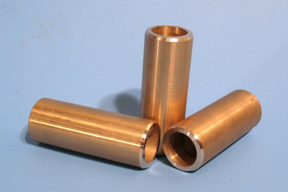

Once you get it out, I would suggest it is replaced with a bronze bushing. Drawing it in with a threaded rod is the least damaging way ti fit it,BUT be aware that the hole in the snout is much less than a precision piece of machining. You may well have to machine something off the OD of the bush.

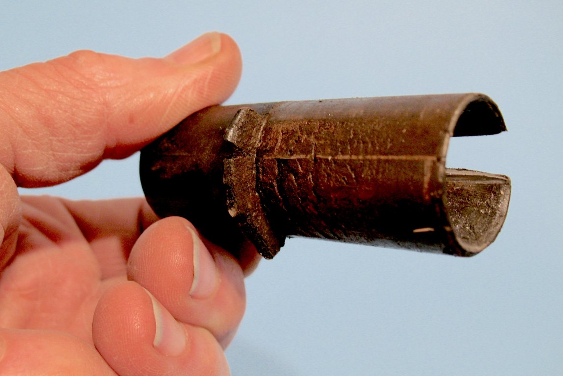

The old steel bushing on my 1915 was a wonder to behold.
Luckily I had a pneumatic hacksaw to split it and facilitate chisling out the carcass.

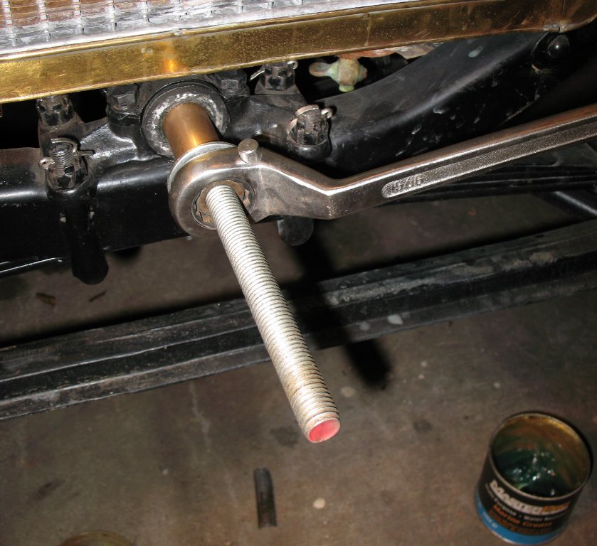

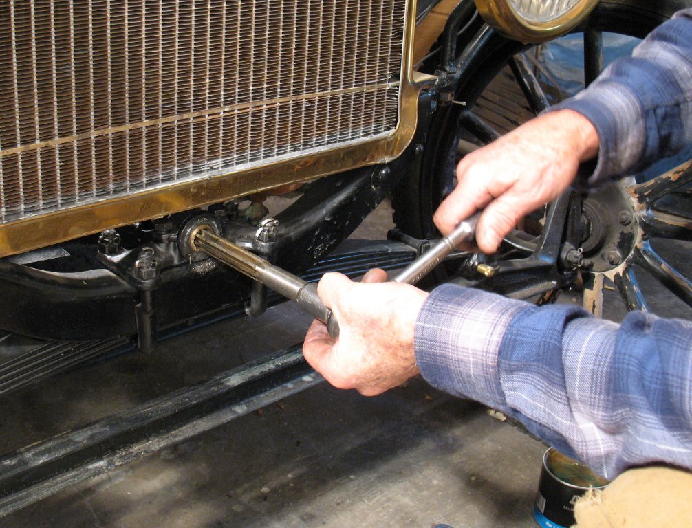

If you press in the new bushing with all thread you don't have to worry about accidentally bashing your radiator with a BFH.
After the new bushing is pressed in it may need reaming with a ¾" reamer for the crank to fit.
I prefer bronze bushings. I bevel the ends and grease the hole to help them in. If you shop online and order bushings by size, this may help:
Front perch bushings(#3820) are ⁹⁄₁₆" ID and ¹¹⁄₁₆" OD, 1½" long.
Rear perch bushings (#3844) are ⁹⁄₁₆" ID and ¾" OD, 2" long.
Hand crank bushings (#3909) are OD 1", ID ¾", 2⅝" long,
Spindle arm bushings (#2714) are OD ¹¹⁄₁₆", and ID ⁹⁄₁₆", 1" long.
Parking brake cam bushings(#2559*) are 1⅛" long, OD ¹¹⁄₁₆", and ID ½".

If you go with a replacement steel bushing, you will need to turn the O/D down to get it in with out damaging the pan. The steel bushings are way oversized on the O/D. Press in or use the threaded rod trick. NO BFH.

Steve your old bushing you removed looks like it was originally bashed in. Am I looking at it right? Maybe the guys at Ford used a BFH?

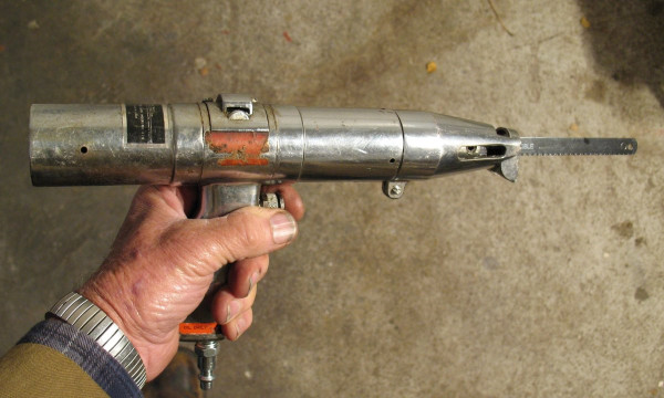

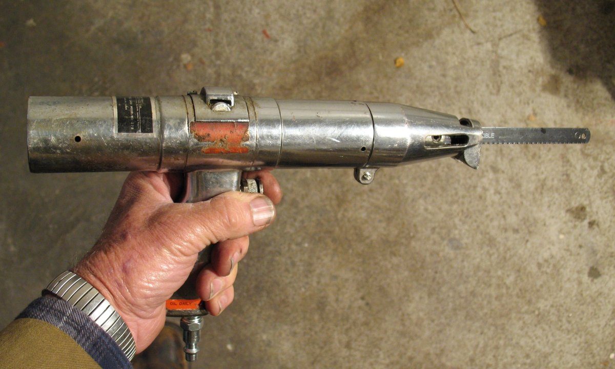

Steve.
Thanks for the bushing info, I have not seen a pneumatic saw like that in 30 years do they still make it?
Craig.

- Posts: 4638
Re: Starting crank bushing in front of pan removal
Harbour freight has them. Some like their stuff others don’t but the tools were OK for the price. https://www.harborfreight.com/high-spee ... 91753.html

I have this unit. It doesnt work very well. The least pressure stops the blade. not effective.John kuehn wrote: ↑Fri May 20, 2022 2:05 pmHarbour freight has them. Some like their stuff others don’t but the tools were OK for the price. https://www.harborfreight.com/high-spee ... 91753.html
I have used a hacksaw & sawsall.
I actually prefer carefully installing a new bushing with the pan still mounted in the frame. No chance of bending something. The key, though is to not force a too small bushing with a BFH.

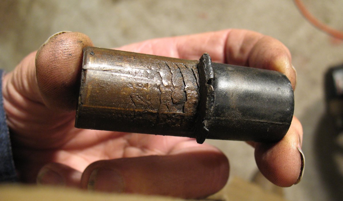

...your old bushing you removed looks like it was originally bashed in.
I don't know if it was bashed or mashed, but it sure was skinned. Here's another view.

Steve's original bushing is interesting. Clearly the bushings were fitted before the snout was added to the pan during manufacture. The experience of others having bushes of too small and too large OD's indicates that things were a bit hit and miss with those split steel bushes. On a couple I have replaced, the snout hole was undersized too, and I had to machine the bronze bush down on the OD.

John I have two of the harbor freight air saws but it is a PITA to get a hack saw blade to fit and they don't do very well usually I use saber saw blades if I need a longer blade. And yes some people don't like HB you have to be careful what you buy from them. I have purchased tools from them starting in 1977 contrary to popular belief they are a family owned company in California. I still have many of the tools that i purchased in 1977.
Hope this doesn't go off the rails!
Craig.

I wonder if an "oil-lite" bushing would be strong enough for this application. Craig
- Posts: 6730
an oillite bushing in that location would be a real mistake
they're excellent when used as intended, but for loose fits and cross-axis loading, because they are a sintered material, they will be prone to fracture/failure
a replacement rolled steel bush or a cast bronze bush would be appropriate here
