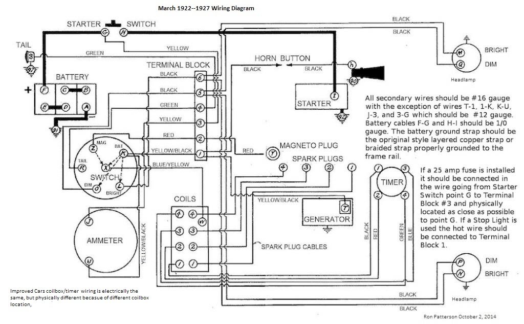

Re: New T electrical questions
Be careful!
There are many (incorrect) wiring diagrams floating around in Model T land. .
Attached is one I guarantee to be correct.
The fact that you have a TT is an additional wrinkle.
Before you start changing things check out how your care is wired comparing it to this diagram and give me a call.
I will be in the shop today.
Ron Patterson
231-348-5085
Ron Patterson
231-348-5085

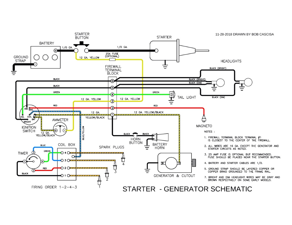

Here is a simple wiring diagram.
On the 26 coil box, the lower terminal on the bottom of the metal box is the positive input wire. That blue tracer wire goes only from that bottom terminal on the coil box to the 'coil' terminal of the ignition plate combo switch. That way the ignition switch, when the key is turned to BAT, the coil box is energized by the 6 volt DC battery, when the key is turned to MAG, the coil box is energized by the AC current of the flywheel magneto.
Having that magneto terminal red wire going directly to the coil box is pretty wrong. My guess is the back of that ignition switch is wired up wrong and allows only 6 v battery energy to the coil box.
Click on Image to enlarge

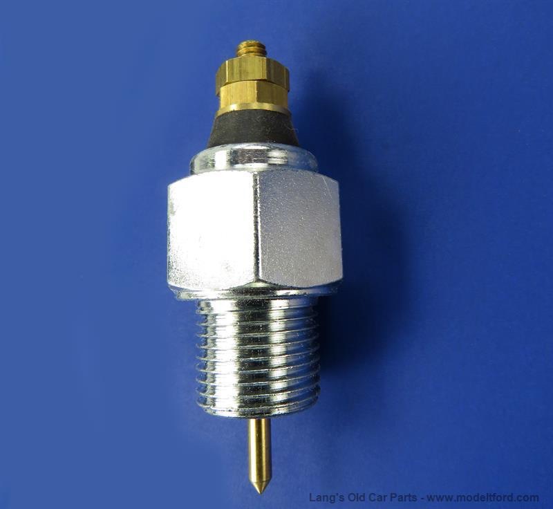

Since you don’t know much about this T, first be sure it has a magneto. A past owner may have elected to take it out, if it did not work. It is also possible that, if you do have a magneto, it may not work and needs to be rebuilt. If you do have a working magneto coil, the first thing I would try is to be sure the magneto post on top of the hogshead is making good contact with the magneto button. Unscrew the large hex head post and pull it out. There will be a small rod with a sharp point that, when positioned properly, Imbeds into a soft soldered button on top of the magneto coil, just below the hole. The small rod pivots, so be sure it is pointed straight down and screw it’s in until tight, then try it.
In 1982, I was driving my Model T on mag when I went over a rough ail road crossing. It immediately died and I had to drive home on BATT. Since I knew when it died, I checked the magneto contact and, sure enough, the magneto contact post had shaken off of the magneto button. I took the post out, sharpened and aligned the point, screwed it in and my T has run on mag ever since. Jim Patrick

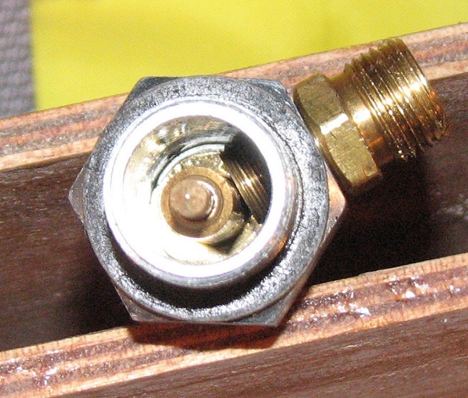

PS. If your T has a magneto post oiler, make sure the brass fitting is not screwed in so far as to make contact with the post housing inside the hex housing (second photo). If it is making contact it is grounding out the magneto. Take it out and grind a little off so it does not make contact.
