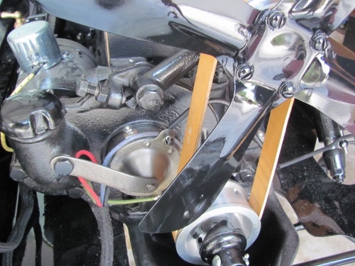

Does the linkage go under or over the lower radiator hose? When I got mine it was routed under. Currently the rod connection at the timer is rubbing against the belt when fully advanced and has been for awhile before I bought it. I’m assuming that I need to bend the rod to lengthen it. I have the tool to check the timing.

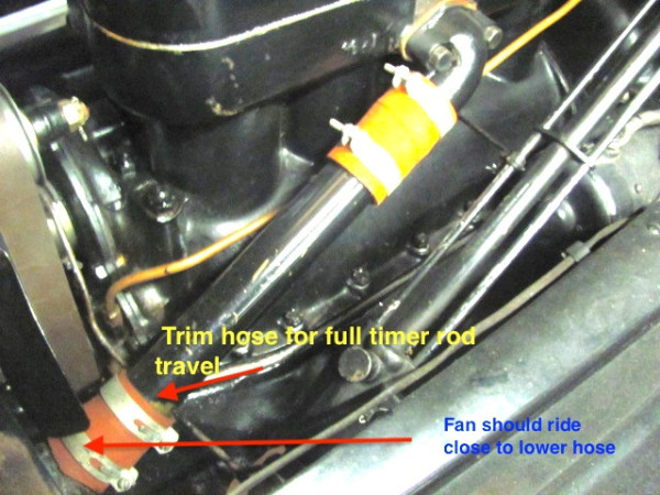

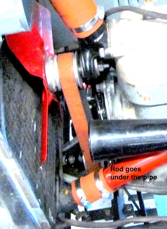

Scott gives good advice to carefully set your initial timing. That will place the timer case at the right spot. Then you fit the rod to the timer case, and to help keep that case locked in place, tighten the bolt on the case flat bar spring, so it doesn't move from that spot, as you fit the timer rod to it. Release tension slightly on the case spring when all is done.
The timer rod goes under the metal pipe, not the hose.
Trim that lower hose to 2 3/4" length as that is the correct factory, repro hoses can come in other lengths.
And for adjusting that timer rod to length, bend it only at the upper wide loop just over the timer case, easy to extend or shorter that long bend and never disturb the fit under the lower inlet pipe.
Here is the the set up for a pre-26
And here is your '26, the Improved car uses the same lower hose length too.

I forgot to mention this car has a water pump. I also just installed a new, factory roller timer.
