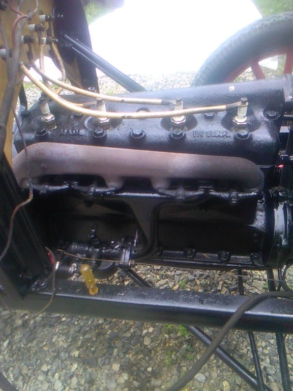

Post by andy2794 » Mon May 23, 2022 1:51 pm
I painted the engine & exhaust with Rustoleum 500 degree engine paint waited about a week and started the 1916 T and it burnt the paint off the manifold exhaust and tail pipe. Is that normal or do I have a problem?

Post by TXGOAT2 » Mon May 23, 2022 1:55 pm
Probably normal, but! Be sure your initial timing is correct and that you are using the spark advance lever correctly. Late timing will cause the exhaust manifold to run much hottor than normal. An excessively lean fuel mixture can contribute to excessive exhaust manifold temperature as well.

Post by speedytinc » Mon May 23, 2022 1:56 pm
500 degree paint on an exhaust manifold that glows red?? This is "engine paint" rated.
You need "exhaust manifold" paint. 1200-1500 degrees.
Absolutely normal. You used the wrong paint.

Post by Steve Jelf » Mon May 23, 2022 3:08 pm
John is correct. Even with the timing set right and the carburetor adjusted perfectly, the exhaust system is too hot for "normal" paint. You want manifold paint. I use the clear version. You do need to follow the instructions to cure it properly.

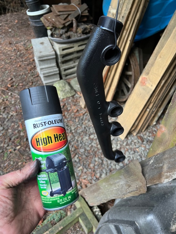

Re: engine paint
Post by KBurket » Mon May 23, 2022 10:38 pm
I’ve used Rustoleum High Heat after cleaning the rust off with my wire wheel. It’s held up well.
