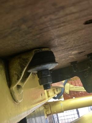

I built a Model A Speedster several years ago, in my build the plywood lay on the frame. Drilled holes through. I put some strips of rubber in between, but there were no additional brackets.

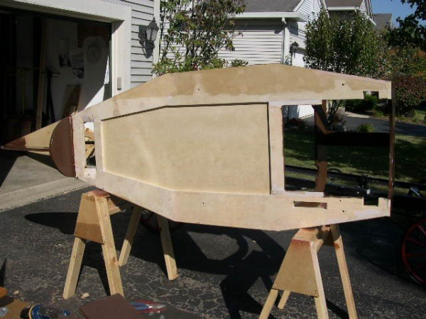

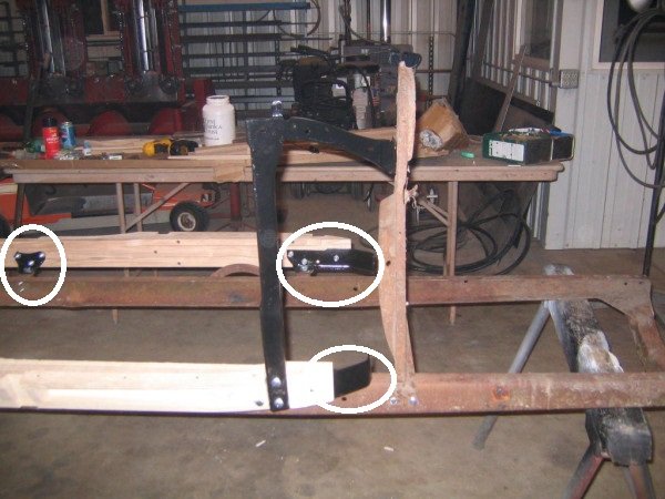

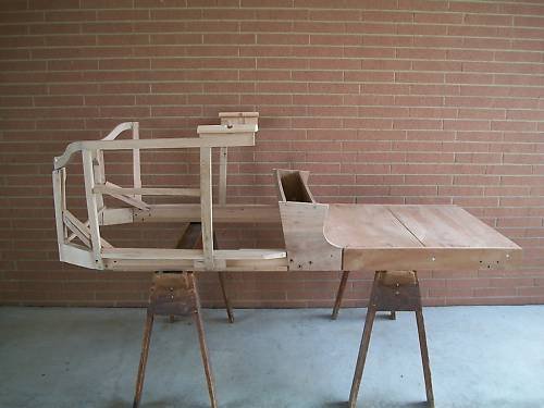

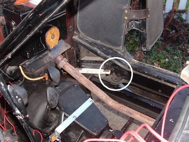

Four body brackets were used on the Model T to support a beam running outboard and parallel to frame upon which the plywood deck was laid. This method can also be used for a speedster and the beam use to attach supports for the body. This picture shows some body brackets/wood frame for a Model T. This allows the frame to flex as needed and eliminates some vibration. These photos just to sho the brackets in use --
Here are some other methods - but my induce frame vibration. These likely were bolted to the brackets riveted to the frame and not the additional bracket for the beam

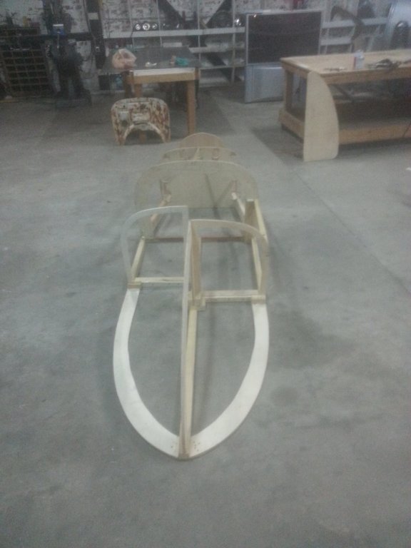

Hope the knee healing goes' well. I made my speedster body using 3/4" 10 ply plywood for the base. The local steel supply has 20 gauge angle in 1", 1 1/2" & 2" that can be easily formed to the plywood and spot or tack welded to the body giving a large area of support. I mounted mine to flat to the frame with rubber shock mounts under for cushion but rubber could be put between the mount and body keep in mind the frame is going to flex a lot.
