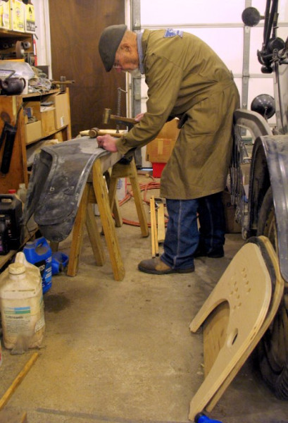

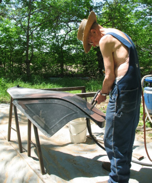

Nobody else has done it, so I'll start it off this month.

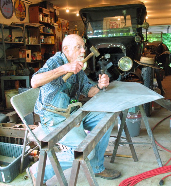

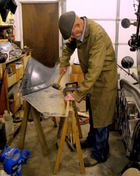

I'm not an experienced body man, but today I pounded on a bent front fender.
I got it straight so it doesn't pop back to bent. It's ready for finishing the sandblasting, and then soldering.

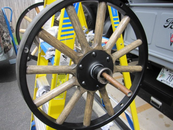

My other job of the day was straightening the dings on this front wheel from running on gravel after throwing a tire last fall.

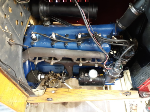

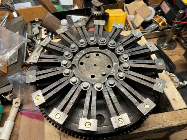

Completed the rebuild and fine tuning of a nice set of coils, then re-
-installed the e-timer I had on the truck briefly when the engine was
freshly rebuilt (removed while I worked out other bugs). Truck moved
out like a scalded dog, but died intermittently, leaving me to push it out
of traffic and ponder my problem. Seems the battery terminal in the switch
is breaking contact and requiring some love. A quick setting of the mag
wire to the feed terminal on the connection block got me back on the
road and home. Damn, would it pull hills ! I am impressed.

Steve, straightening the fender skirts can leave you with a fender with not quite the same side profile. I usually trace the outline of a good fender on some stiff card and cut the outline to use as a template for the other side fender. If the skirt was stretched when it was bent, and all you did was straighten it, you may still need to shrink it a little to get the profiles to match. This may lessen the grief of trying to get the front of each fender sitting at the same height.
Hope this helps.
Hope this helps.

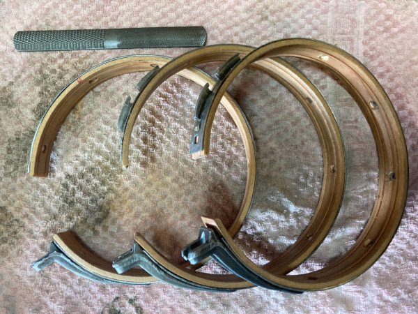

I do have to replace my transmission band linings (I realized the break band is starting to score the drum
, so we’re off the road for now.).
Then I have a cracked skirt on the right front fender, so I’ll have to spot weld a doubler on the inside to stop any flexing.

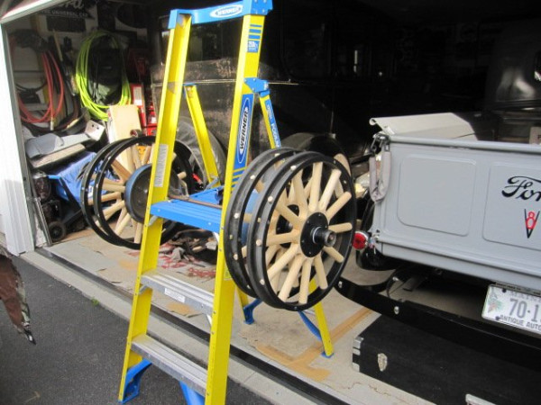

I have been getting wheel parts ready for my '14 to go to Calimer's wheel shop for new wood.

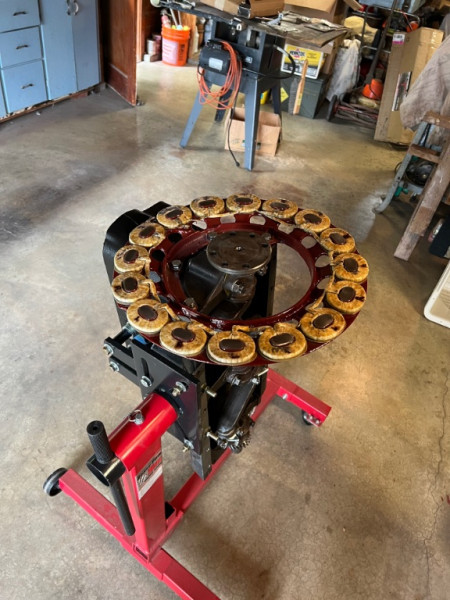

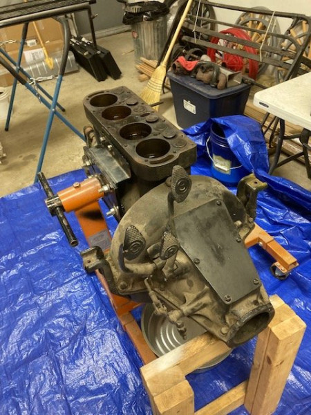

Started on the first leg of my 13 Touring project. The engine was out of the car and stored in a shed for many years and its stuck. Been soaking the pistons in Kroil for a week. Going to remove the the pan and transmission in a few days and start soaking pistons from the inside out. No obvious top end or water jacket cracks yet. Number two looks like it had some water in there for while. Really want to save this early June, '13 engine. Pics of the car and the engine.

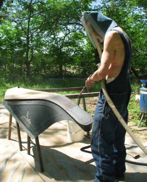

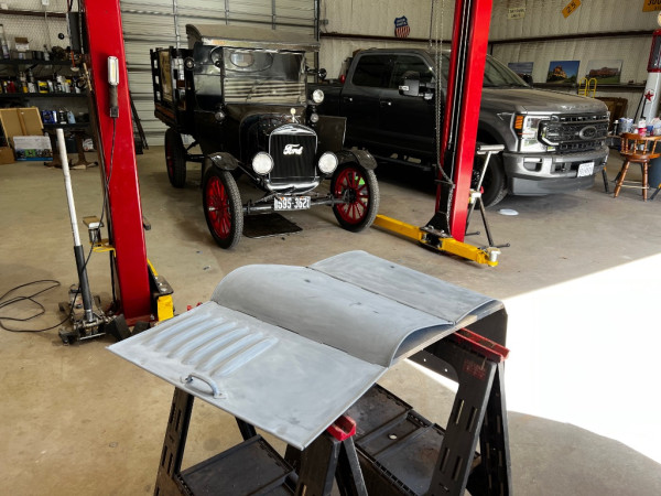

More front fender blasting.
The old lacquer was awfully tough, and it was mighty slow going until I remembered the pneumatic scaler.
That breaks up the lacquer and uncovers the red primer.
The primer comes off a lot faster.

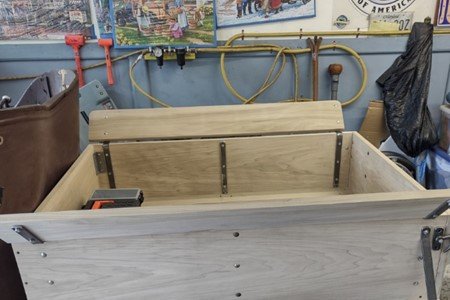

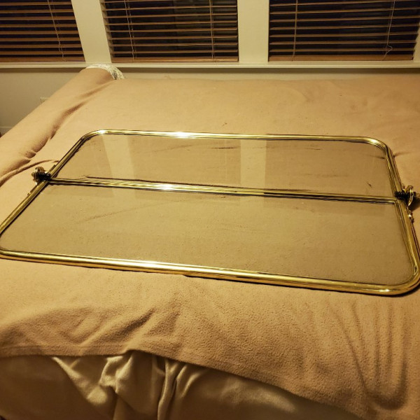

Just finished the brass windshield for a 1912 MIL roadster. The car was delivered to the painter so I'm finishing up odds and ends. The car was in an accident a few years ago and both panes of laminted glass were broken and the bottom frame and center channel were bent. I was able to straighten the frame and replace the center channel. The windshield was new 20 tears ago but was installed on two cars over the ensuing years up until the accident. It has a few niks that didn't polish out but I got it all to fit back together pretty nicely I think.

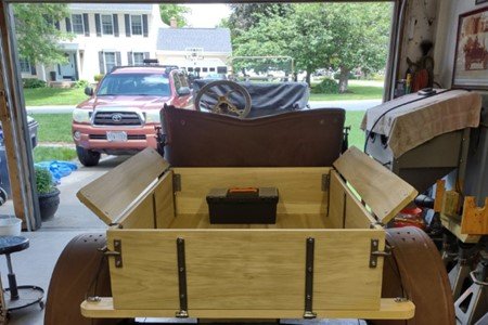

Maybe not a big deal but I took my barn-find (last October) "Barn-ey" 27 Tudor that had been parked since 1968 out on the road for it's first drive in 54 years. We didn't go far since we are still getting to know each other but Barney was very happy with his new wheels and rebuilt vaporizor. First ride was only 3 miles but second drive was 4. Still smiling because I think those that know me thought I was crazy for dragging it home. Got a long way to go with it but it is a functional car again. I bought a sewing machine and teaching myself how to sew so I can put an interior back in it. Working on putting together a rebuilt rear axle to swap out to avoid any thrust washer problems. Having a ball piecing it back together, and learning a lot. Going to be a fun summer!

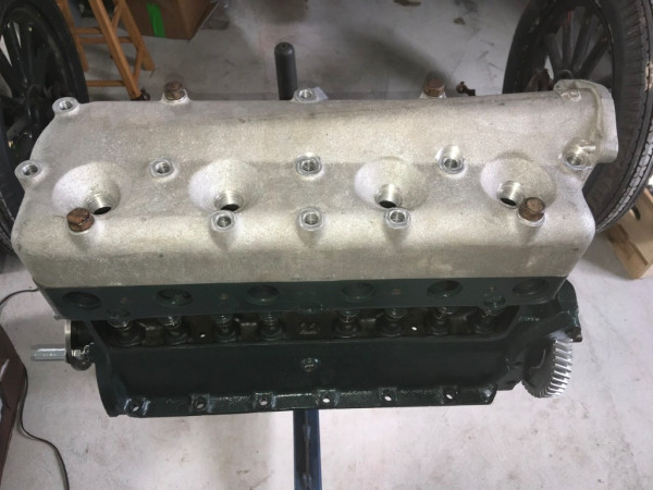

Got the motor for the 12 towncar back from Joe Bell, it’s back in the car but have a few more things to button up before starting. Installed a rebuilt ruckstell, reset the Rocky Mountain brakes, combined two rear leaf springs, added a leaf to possibly strengthen the rear bounce. Bought a new front spring but have to rebuild a new to me DB front axle with new hassler shocks to put under the car. During the winter, while no motor, built a rear luggage rack for looks, pretty happy with it. These cars were either used as a limousines or taxi cabs and I figured a luggage rack in the back is somewhat appropriate. Once it is back on the road, I want to install led directional and brake lights into the existing light fixtures so they are not noticeable till in use. It seems I have rebuilt everything on this car again for the third time but it is finally the way I want it. I think I am like a lot of T owners, like tinkering and working on the cars more than driving them but with two in the garage that is going to have to change. Our club has a tour every month and I enjoy it every time.

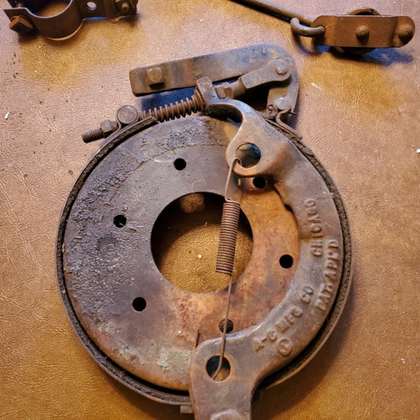

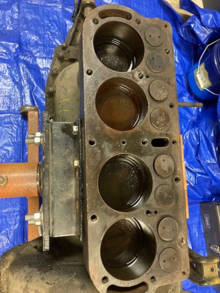

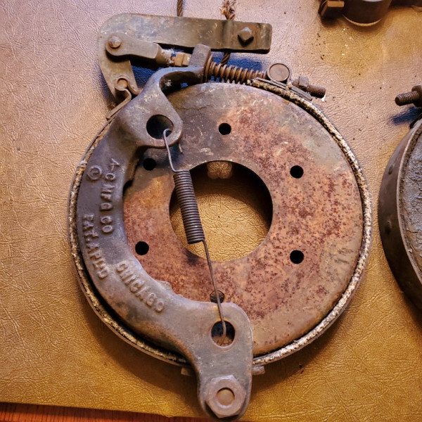

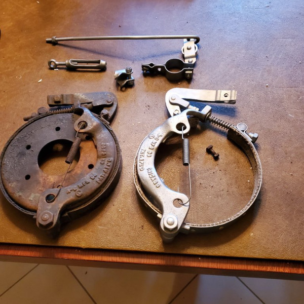

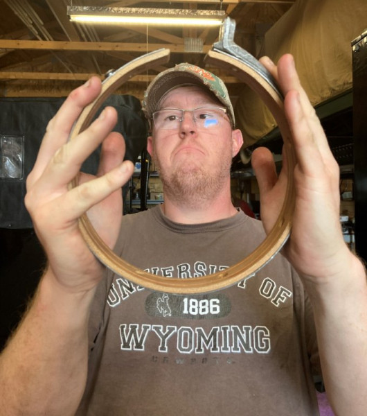

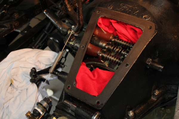

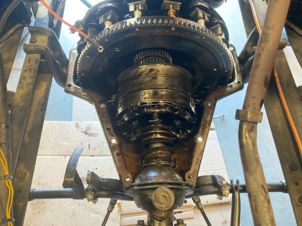

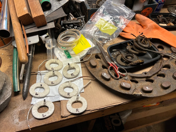

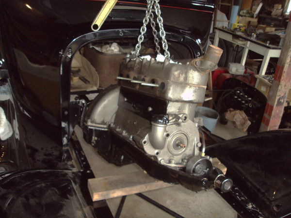

At long last I set the engine back in the Tudor. We lost the bands on a tour last Fall. I managed to repair the damage and after some illness, the Winter weather and some yard work, I have gotten back to it.
viewtopic.php?t=23886#p183662
The Kevlar band lining didn't smooth out like it should after riveting the ends flush. It worked well on the last batch but this one left some humps. I installed them and tightened them to the max hoping the lining would compress. Then I loosened them to give clearance for breaking in.
Rather than fight the transmission cover in the car I decided to install it on the test stand along with the starter. Removing the firewall was necessary for this. It went in easily except for the usual go round lining up the U-joint. I will work up the courage to put the firewall back in place later today.
As Larry mentioned a few days ago, it is very rewarding to and remember the work in putting the car together the first time. Those extra details to make it as right as possible are soon forgotten and a treat to see again.
Keeping my fingers crossed.
- Posts: 4839
Re: What have you done on your Model T in May?
What you have done with kevlar bands is a transmission disaster in the making. Those hi spots will create constant heat/friction. Take em out & properly re-rivet the lining. For the cost of a few rivets & a little time, you are going to loose some drums & pull the motor again.Rich Eagle wrote: ↑Fri May 13, 2022 12:06 pmAt long last I set the engine back in the Tudor. We lost the bands on a tour last Fall. I managed to repair the damage and after some illness, the Winter weather and some yard work, I have gotten back to it.
Kevlar lining is great stuff when done properly, but is very unforgiving. It must be respected.

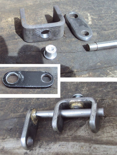

Fixed the starter bending on the ‘25 roadster. I had postponed doing this for several years fearing what I might find when I got the old bendix out. Turns out it was just the long bendix bolt that was broken, and the missing piece was still in the bendix cover when I removed it. No harm to the rest of the motor. Still, I had to deal with my least favorite part of a Model T: the inside bendix cover screw. The getting it out part wasn’t too bad, but the getting it back in part is what strains my patience.

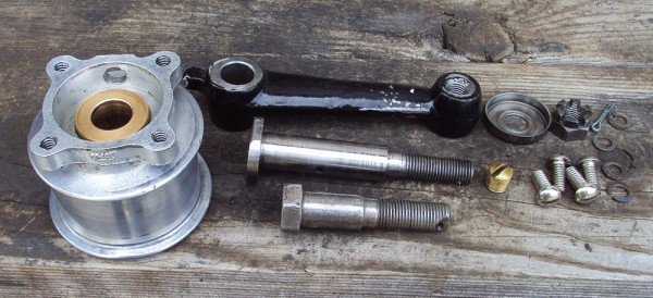

My ‘24 touring came with a water pump, and was cooling fine. I went to add some grease to the shaft cups and what was inside looked more like candle wax than grease, so I pulled the pump to clean it up and found it locked up tighter than Dick’s hat band and a nice polished section on the pulley where the belt had been slipping. I have a new inlet elbow, pipe, hoses, clamps, and belt to go back original. I figure if cooled well enough with a stuck pump, it should do even better without it.

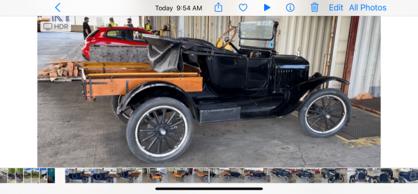

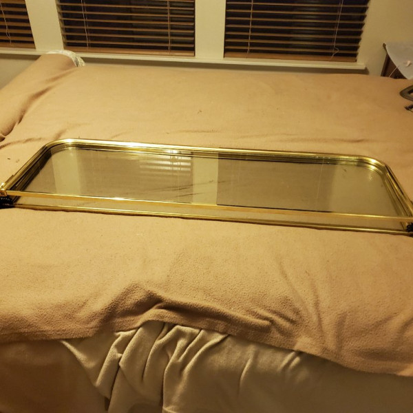

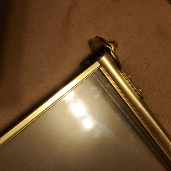

Finally got new windshield glass installed (plate glass had cracked due to sagging windshield frame). Then finally got headlights wired and running properly. When I restored the headlight buckets, I left paint on the surfaces where metal to metal contact is necessary for grounding. One headlight worked, the other was barely on. When cleaned of paint they both worked fine. Next is the horn wiring. I have a Fox locking keyed wheel and the inner contact ring needed some restoration as some of the plastic insulation was gone. Solution? Black liquid tape. We'll see how that comes out. Thanks MTFCA for all the family help.

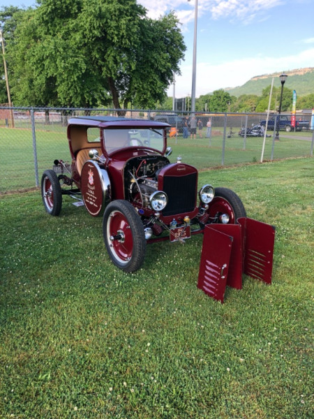

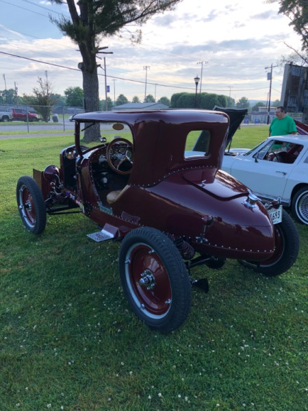

Benefit car show for a young man (37 years old) Fighting an aggressive cancer! This is my first car show..., imagine that. Really!

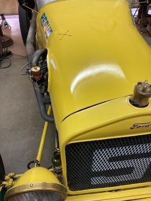

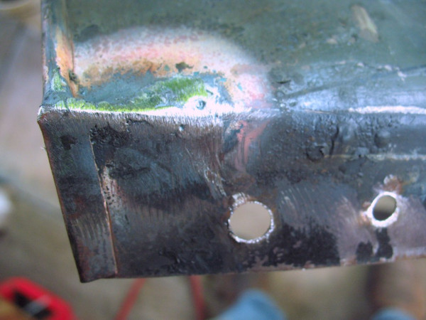

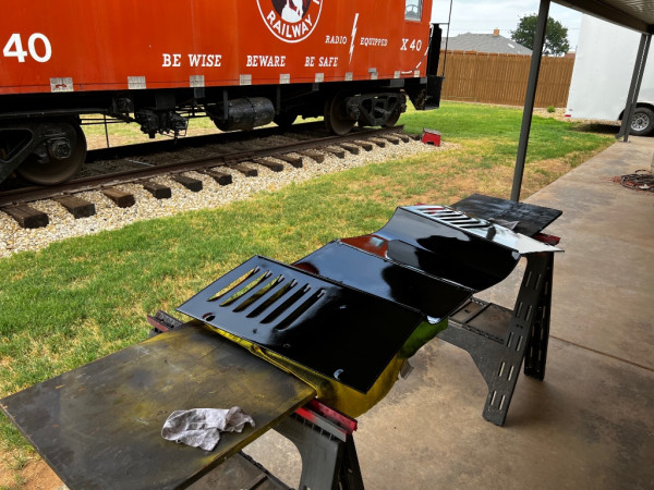

Did more pounding on my fender-straightening job, and welded up a split. My attempt to learn wire welding did not go well, so I used acetylene and a 000 tip. I think I did it well enough to hold together.

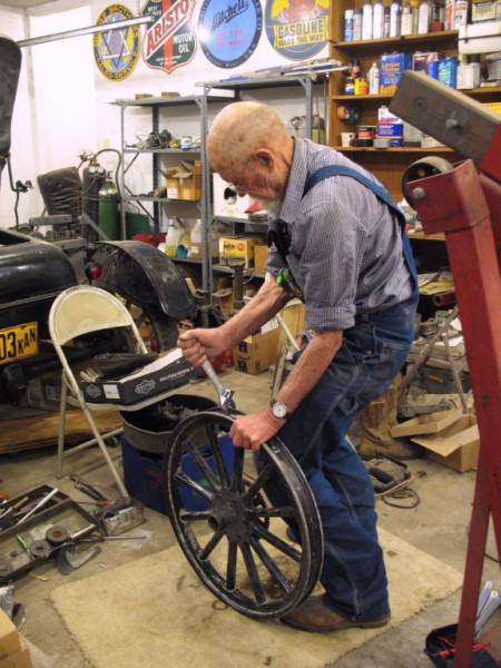

Working on replacing the clincher tires on my 1923. I have one more to go and I plan to tackle it tomorrow. My hands are beat, patience is thin but the goal line is in sight. What an incredibly difficult job. I wonder how they did hundreds of tire mounts each day at the factory......
- Posts: 5263
This is a "manual" machine but get's one off of the floor - it works quite well ! I can do clinchers, demountables & split rims.
Topic author - Posts: 7330
If you're not already doing them, try these three things:
1 Lay the tire out in the sun to let it get warm and soft.
2 Lubricate the tire with dish soap or baby powder. I use powder.
3 Use long irons. Model T irons make tire changing the job from Hell. I use three HF two-footers.

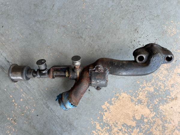

My rebuilt NH went from an easy-start and purring-idle to needing a lot of choking and several tries to start. I pulled it apart yesterday and found a lot of sediment. I suspected that the idle passages were clogged too. I'm glad I installed set screws in place of the brass plugs to make cleaning easier. I have not started the car yet but I am hopeful.

In the process of disassembling and bead blasting a set of original and complete AC brakes. Surprised me how nice they cleaned up. I doubt if I'll even have to to reline them. Purchased a few years ago from Mark at Chaffins. Thanks Mark!

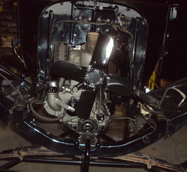

Work continues on the Tudor repair as time and ambition permit. This has been a good opportunity to clean and service everything especially parts that came off in removing the engine. It's nice to see the Dulux Black has survived the 20 years it has endured. I'm taking pictures while it is still clean.
I was also pleased to find the fan bushings fitting the shaft so well. A .001 shim produces definite drag. It was still well oiled but cleaning and fresh oil will help it last longer.
I know full well that a fan belt guide is not necessary but they are cute and I like to make them. The previous one had escaped it's mount and was long gone when I tore things down. I made a new one from materials on hand. This time I swaged the parts and then silver soldered them. I was happy to see that the one that failed was an original accessory rather than one of the several I had made. I can afford to made mine a bit heavier.
They tell me that if your fan pulleys are properly crowned the belt will run true and "never" come off. If that is true then this guide won't wear the belt much.When did I do that?

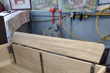

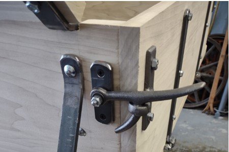

Just picked up the buckboard I had made by the Lancaster area Amish wagon builder ($500). I am converting a 1912 roadster torpedo
to a pick up. It is challenging and fun to creatively put a 1914 gas tank under the seat, drill holes for the battery box, 1927 engine from Ed Henline,
selling the 1912 rear to replace with a ruckstell, disc breaks were put on last fall, demountable,.............
I bought the car as a project car which came with many parts. I sold many parts at Luray and made just about enough to buy a Ruckstell.
I don't want my estate to sell my parts. I am selling my parts now to make money and to put back into the T!

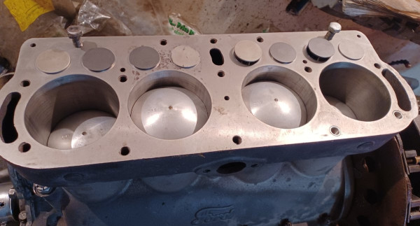

Still waiting on the machine shop to call and tell me the '22 Coupe block has been bored out and to come and get it. I'm hoping to have it back up and running by July 18th it's 100th birthday.

Rickd, I have seen engines with cylinder bores far worse then yours brought back.

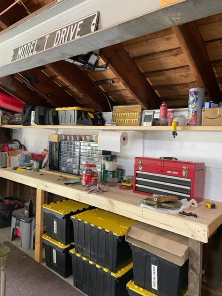

With the 15 stewardship changing to my youngest son…and the 25 likewise to my oldest son….what do you do to a two deep garage bay if you’re not planning on something new?
Build a new workbench…lol. And organize the house garage for the first time since the 80’s!! (Still a work in process, this is the left side…)

Took Nellie to a local street rod show, and lots of folks enjoyed seeing an old Ford. There was just one other '23 Ford there, a fiberglas roadster with 350 chev motor!
Anyway got the trophy, there were 51 cars in attendance, and trophy given to the Top 25....woo hoo!

I just drove 1,100 miles to get my new 22 runabout pickup (whose name is “Burt”) and dropped it off at the freight company to ship to Alaska. The picture is a snap of a video I took just before they rolled him into the container.
He has not been driven in a few years so there is some tinkering to do, but once it gets to Anchorage in a week or so the fun will start. Bert is joining my speedster project “Thelma” in the garage.
