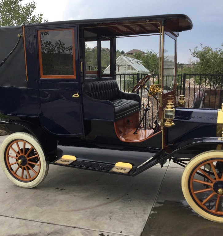

Re: Midnight Blue
The hood and body on mine is dark blue with black fenders and splash aprons. The blue looks darker in that light than it really is, but,I love it. All the leather and top is black.

Re: Midnight Blue
That's a gorgeous color, Frank, just beautiful. I think you really nailed it. I remember being impressed by it when you first posted pictures of that car.

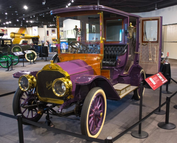

Tim, Mrs. Potter Palmer's custom-painted heliotrope Studebaker-Garford limousine shows there are always some exceptions, even if it takes a wealthy Chicago hotel widow to do it. Fortunately Garford limousines came standard with more conventional color options.

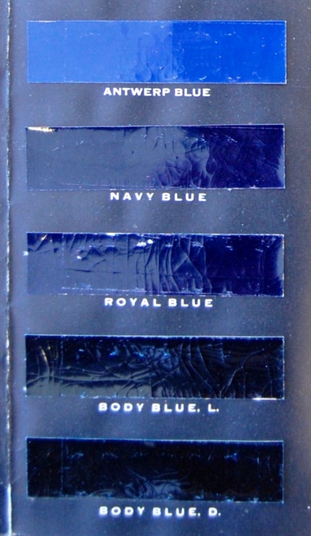

Here are a few blues from a c 1910 catalog. The darker blues are closer to what Ford appears to have adopted in 1911.

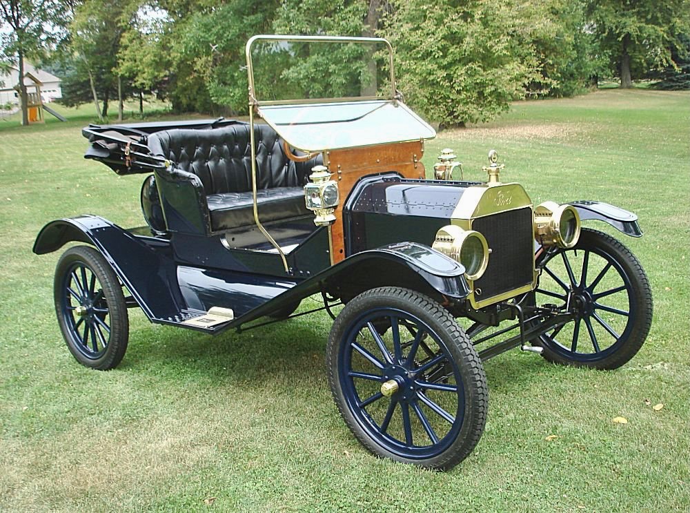

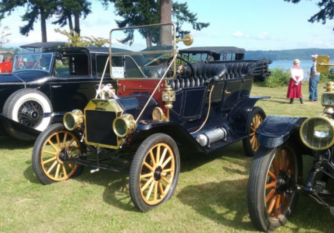

Hey Jay,
People with dark blue cars have posted a few of their recommendations. They are:
Mercedes DB-332 (Diamont Uno 4635 A)
Mercedes DB-904
All of these look great, and from photos of the cars posted you could use them with confidence. Keith Townsend's beautiful fore-door 1911 is DB-332 (also known as Diamont Uno 4635 A), while Roger Byrne's handsome runabout is DB-904. You might consider DB-904 for a car in the 1913-14 range (wheels and body, the rest black) or one of the other dark blues like DB-332 for an earlier 1911-12 car. They might be able to give their experience using the colors.
Here are some photos of Keith and Roger's cars that they posted here before. Also, a 1913 article describing brand new Fords as "blue black, with black enamel and brass fittings."

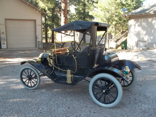

I've commented previously about the blue color used by Ford in 1911-1913 and I want to include some interesting color covers from 1911 "Ford Times" magazines. I know these covers are artist renditions of the Ford Torpedo and Ford Touring, BUT the drawings clearly show that the blue used on these cars was a dark blue, and not really a black-blue as has been discussed on this posting. Note the color difference between the top, which is black, and the body color. We don't have any Ford color charts available, so I believe these artist renditions are all we have from 1911. I've also included a photo of my Torpedo as a comparison. I hope this helps. Russ Furstnow

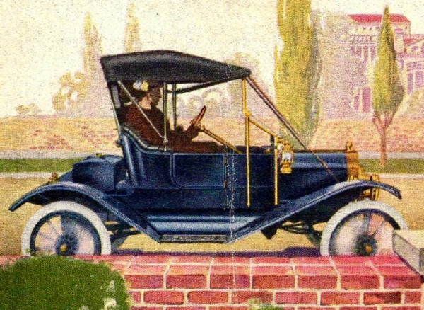

Here's a cleaned up version of that beautiful torpedo and touring.
Russ, the 1913 article describes blue-black, so could there have been a slightly lighter shade used in, say, 1911-12?

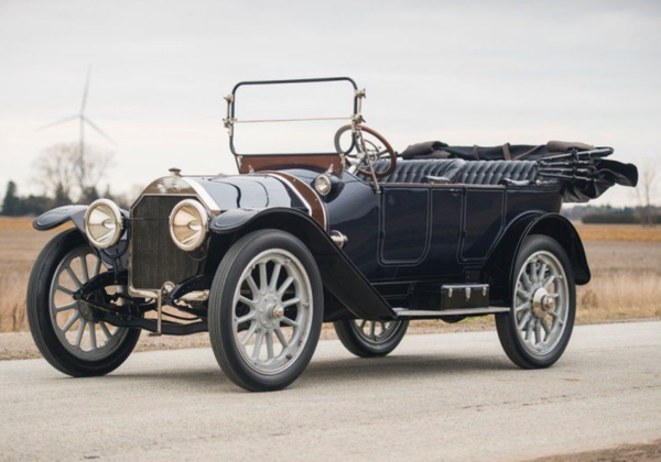

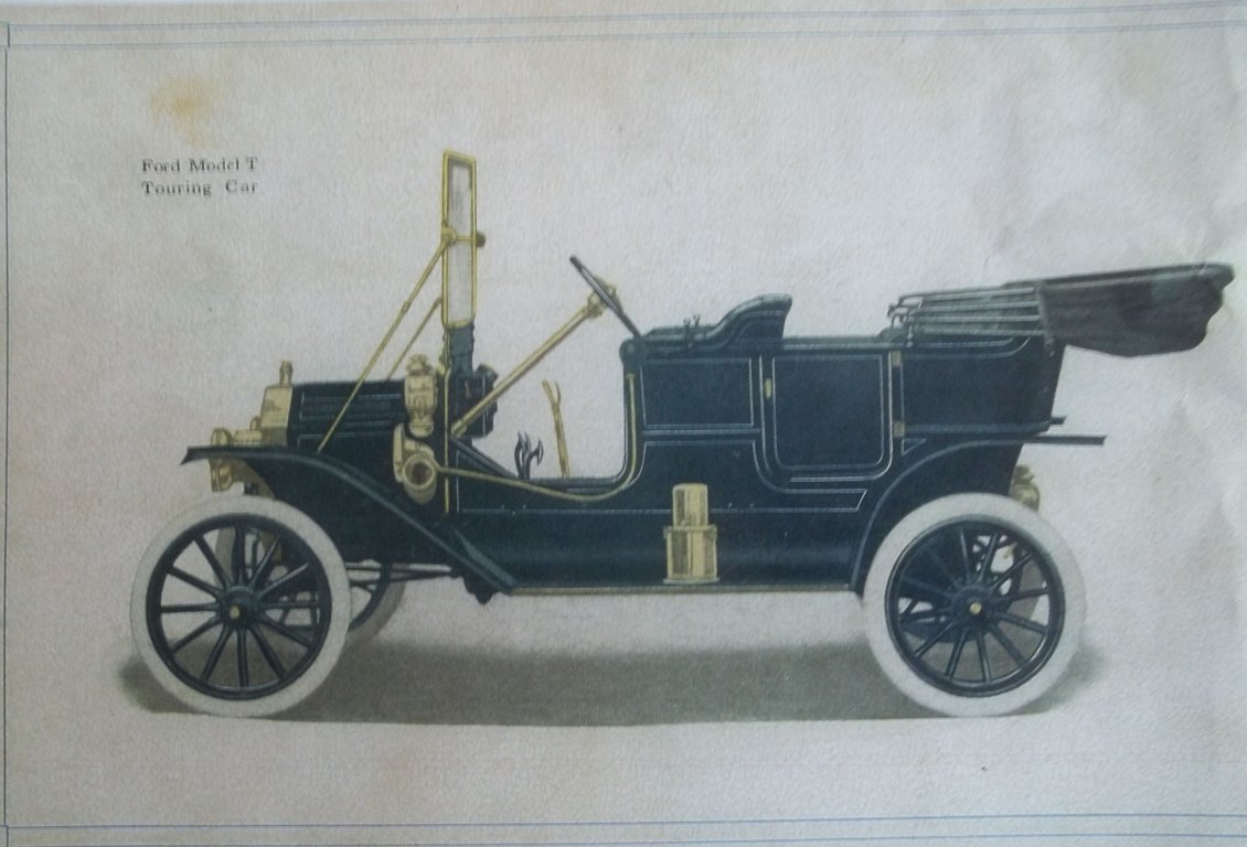

Here is a beauty, IMHO. Sorry, can’t give credit , just a pic I stole. I’ll say it again…..why would a company paint a body an almost black color?? It just makes no sense. Age and oxidation make the few surviving examples appear so dark. Again, just my opinion. Still waiting for slim to post some FoMoCo archival info. Thanks for your examples, Russ! . I

Just a note, the color that Keith used is DB 332, and I've updated the previous post with the new and correct designation.

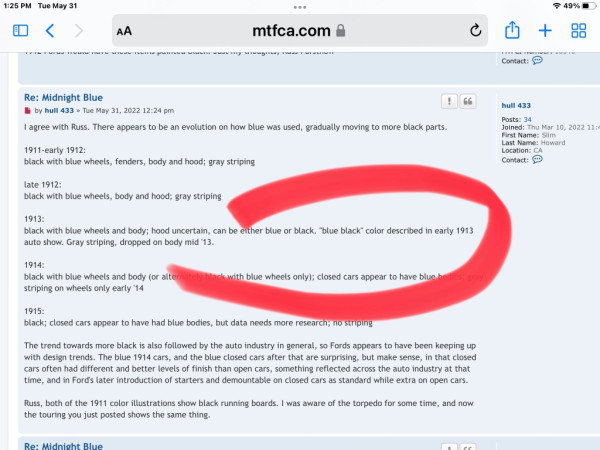

Again, Slim………I see a whole lot of your definitive info put forth with little or no info other than your opinion. You do know factory literature is notoriously unreliable. AND , even worse is a small blurb from a magazine writer. There is another “researcher” who loves to rely on 3rd or 4th party magazine articles and factory propaganda for history. The “ blue black” line could have just as well been “blue over black” or “ blue and black” AND where in any ford literature does it call the paint “midnight blue” ?? Midnight Blue is meaningless. There wasn’t a ford dealer anywhere to go and buy midnight blue, as far as I’m aware of. I’m not from Missouri , but show me some original paint under a hinge or some other protected place, and I’ll believe it. Thousands and thousands of autos painted the same exact “almost black blue” I’m not buying what you are selling.
It’s funny, this club split many years ago over this type of judgment issues, right or wrong, and I’ve always believed Bruce when he wrote so many times over so many decades that some things aren’t knowable. For every fact, there are plenty of contradictions. I say enjoy and embrace your T. If you restore it, do it with love.

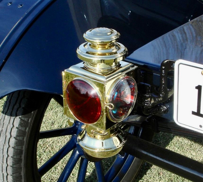

Re: Midnight Blue

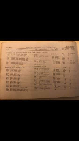

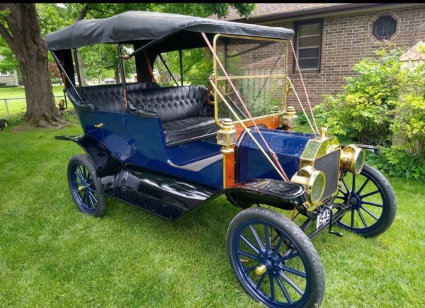

I have stayed out of this discussion, because I have a dog in the fight. I chose DB 332 for my car and am happy with it based upon a variety of sources of anecdotal evidence, articles, as well as sage elders who are no longer with us.

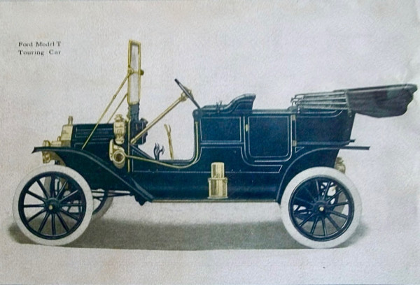

Regarding the artist's rendition of the 1911 touring, I have never seen a period photo of a 1911 that shows pinstripe on the flat panel below the seat riser, nor "boxes" pinstriped on the hood. The drawings also show what looks like brass plated steering column and hand brake. I believe that artistic liberties were taken to enhance the aesthetics of the illustration, including the brighter paint color, to make the picture pop!

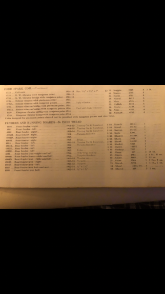

The 1912 Ford parts book list fenders and running boards for 1911 and 1912 available in blue. Black is not a option listed.
On wheels, they ask that you specify color: red, green, blue or gray (French or Pearl).
That information tells me that 1911 and 1912 cars were ALL blue. I don't believe black fenders, running boards, and splash shields were an option in 1911 and 1912. If someone wants their fenders, running boards, and splash shields black, that is would be their choice, although historically inaccurate in my interpretation.
I'm not picking a fight with anyone, it is just my interpretation of the Ford facts and I chose to be as historically accurate with my 1911 as possible.
My 1919 touring is a completely different story and historically inaccurate. I definitely colored outside the lines when I chose to paint it sky blue with black fenders, running boards, and splash shields!

Price list of parts doesn’t specify a color for 56” tread but specifies blue for the 60” tread all years. The hood section reads,”specify color”.

I hadn't looked at this thread since the two initial posts. Did not know this discussion was going on.
I had made comments about colors of cars on two of Tom Rootlieb's photos threads, totally unaware of this discussion! I hope I don't come to regret that?

Was 56" tread the standard car dimensions?

Was 56" tread the standard dimension for most of the cars?Corey Walker wrote: ↑Wed Jun 01, 2022 11:35 pmPrice list of parts doesn’t specify a color for 56” tread but specifies blue for the 60” tread all years.

Neal-
Standard tread is 56". Southern "wide track" is 60"
Here is a link for all years' parts book, manuals, and promotional material:
http://www.cimorelli.com/mtdl/default.htm
