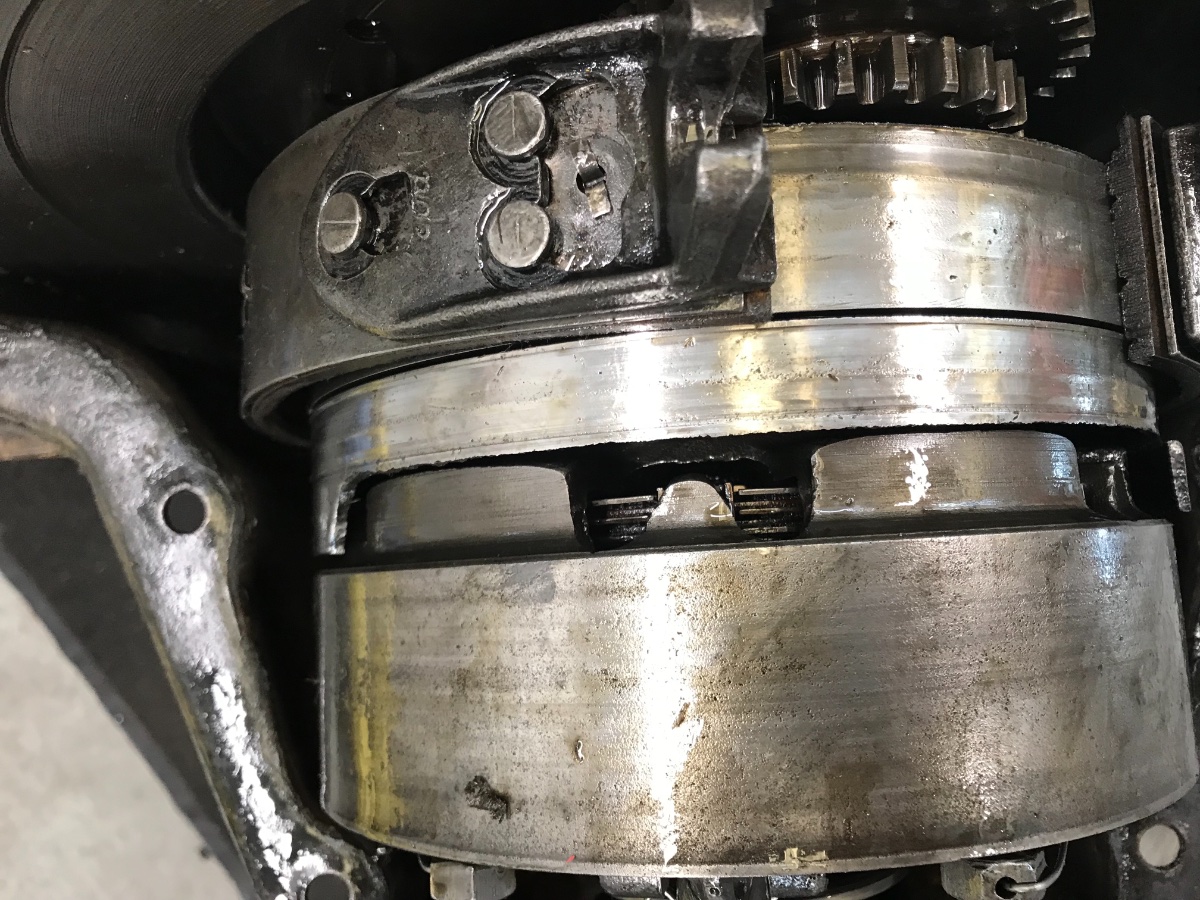

So I’m almost home today from my drive and the motor makes a bunch of grinding noises and then the engine locks up. Like won’t turn. At all.
I start pulling the motor and get to the bendix cover and find this inside. The big piece with the hole was wedged so the starter wouldn’t turn. Wtf is all that stuff? Motor turns freely with that stuff out now.
I think I need to keep going and get the motor out and clean out the bottom of the hogshead. Great. A week away from the Paso tour...

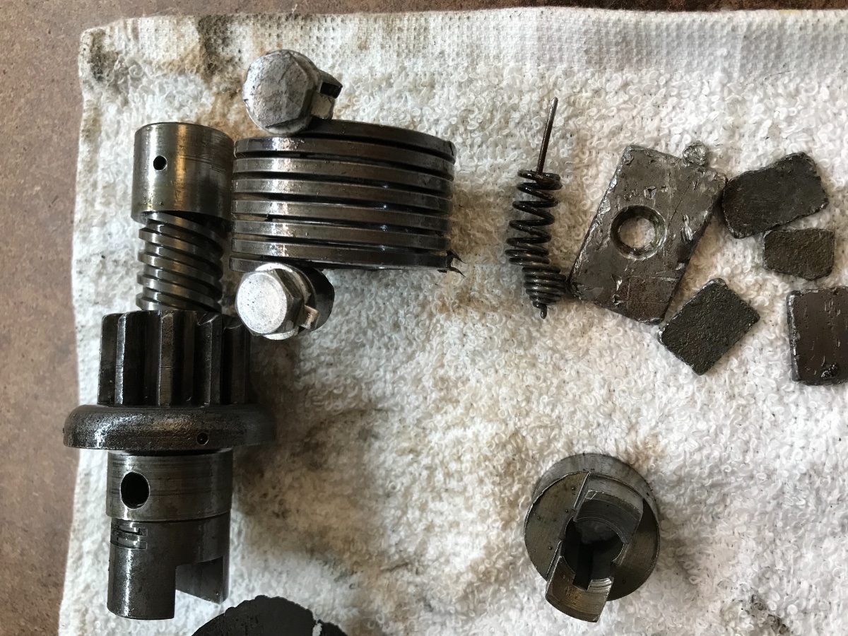

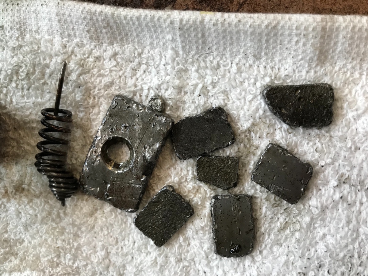

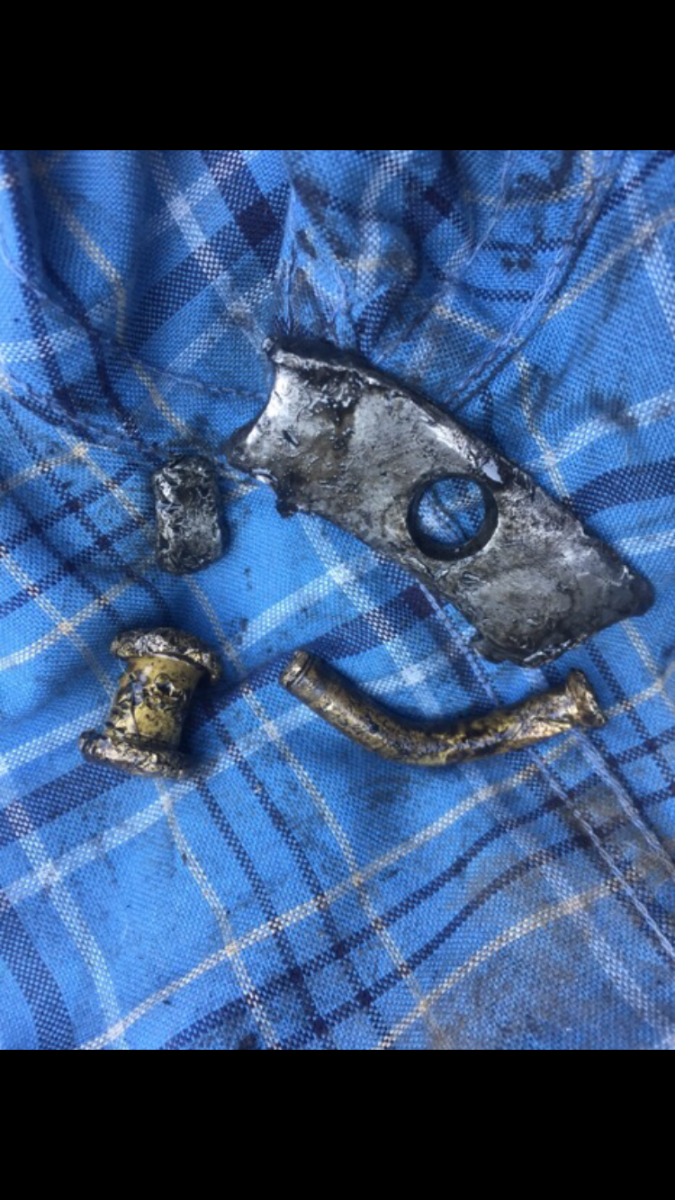

Remains of magnet pieces, keeper and strands of copper windings from field coil.

And keep looking! There is the flat head of a brass screw yet to be found (at the very least). I'm with Dan

I agree with the work statement. But the coil looks like the bottom of the magneto pickup. The magneto has never been used on this car as it has a fuel pump. I once took the mag pickup out to inspect it bc it was leaking. There was nothing on the bottom of it.
Funny thing is I heard something rattling around in the trans during the last tour but it didn’t last long. Sort of like it was being picked up by the flywheel and thrown around. Might have been that coil. This time it might have broken loose from its resting place and done some real damage?

I wonder if you maybe stepped on the starter switch when the engine was running and didn’t realize it. It looks like that sort of damage.

Small spring is from your mag post. Hate to see this and hope you are as good with tools as you are with keyboards.

Jeff, Someone replaced the Babbitt bearing in the starter nose with a brass bushing that failed, first 2 pictures. As others have said, the spring like thing is the contact for the mag post. I see all the starter drive parts except the key, make sure it didn't drop into the engine when you pulled the starter. Next is a mag pole and some odd pieces of rectangle shaped metal. You said you car doesn't run on mag, does it have the field coil and flywheel magnets installed ? If yes then you are going to have to check the flywheel to see if it has a missing mag pole or other damage. With the starter and hogs head transmission door off,( the band adj door ), check the flywheel for damage using the hand crank to rotate the engine. If any damage is found or missing mag pole then you will need to pull the engine and take it apart and assess. If your engine doesn't have the field coil and magnets installed then check the flywheel to see if those odd pieces of rectangle shaped metal are from broken oil splashers,if yes then pull engine. If no and all else looks OK and all is cleaned out you may be alright for the time being. Make starter block-offs, add oil and hand crank to start.

from the parts shown, there are magnets on the flywheel, and the flywheel assembly is damaged. It will be coming off...there's no way around it.

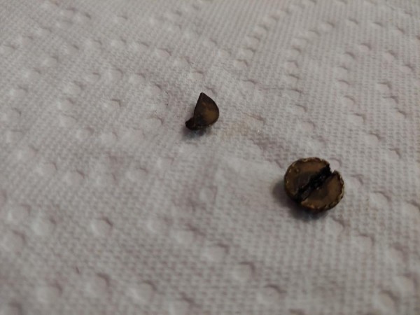

That damage to the bearing was done by the flying bits. But “starter drive parts”....how would they make it past the sealed starter nose?kmatt wrote: ↑Thu Apr 11, 2019 3:42 amJeff, Someone replaced the Babbitt bearing in the starter nose with a brass bushing that failed, first 2 pictures. As others have said, the spring like thing is the contact for the mag post. I see all the starter drive parts except the key, make sure it didn't drop into the engine when you pulled the starter.
And I’m convinced that the rouge mag pole is the ultimate culprit here. As I previously stated it’s been missing for a looong time. When I first got the car it was gone and leaked from the mag post. I heard it inside the engine once before but it went away. Andit finallly shows up now? And it’s mangled, so it likely started a chain reaction. To be continued...
It’s a mystery wrapped in a conundrum surrounded by an enigma.
This just in From Steve Tomaso:
“ I would venture to guess one or more of the brass magnet screws broke first and released the magnet clamp/s - that intact flat steel piece w/hole is a magnet clamp - there are/was 16 of them ! I'm also going to "guess" that the field coil bobbins are unwound like spaghetti in there ! ”

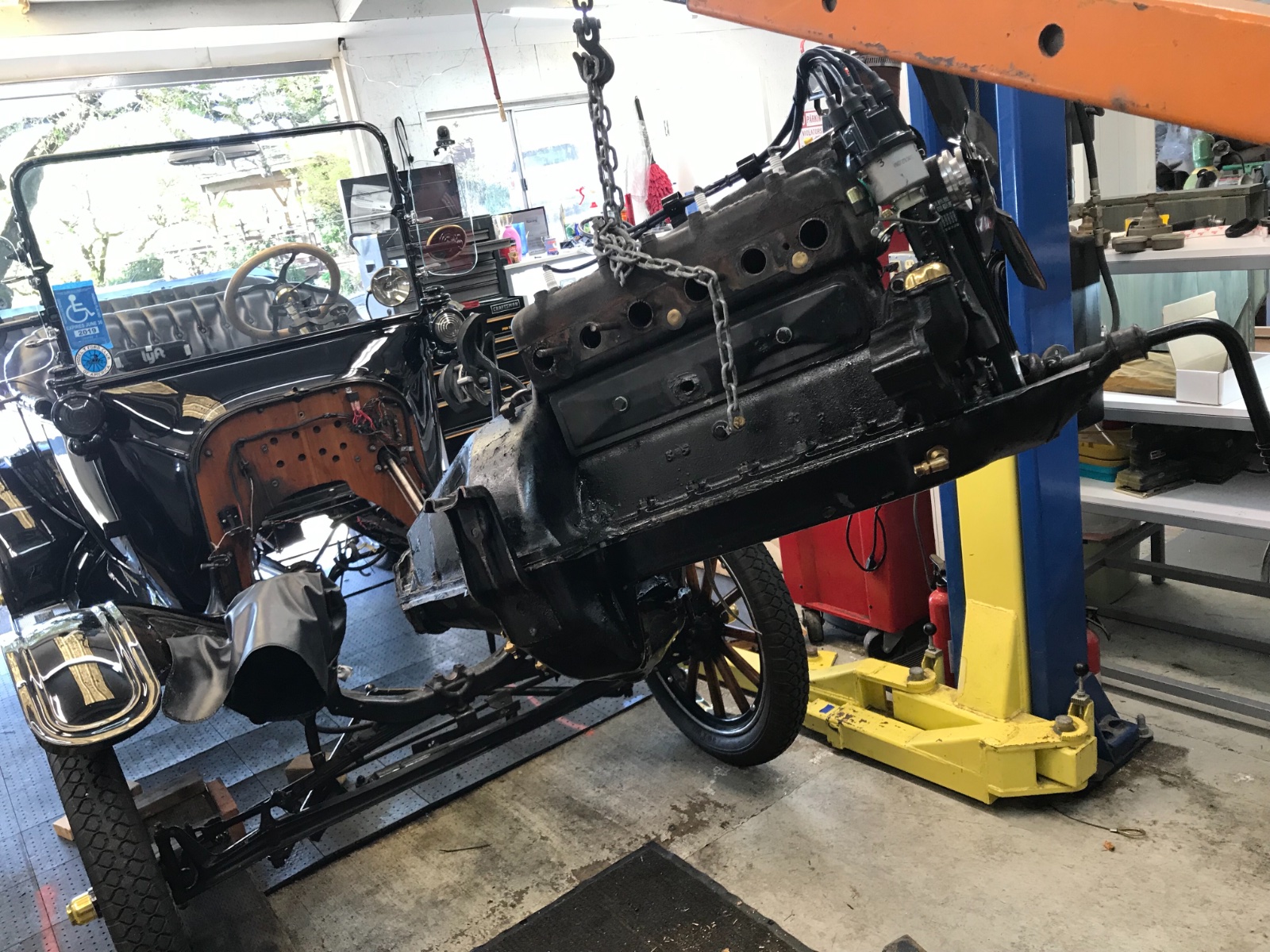

Now this finally makes sense! Motor comes out today.

You don't need to inspect anything else until you get the engine out of the car. Those parts are from the magneto and a few from the starter which probably got damaged when the magneto parts came off. You will need to pull the engine and remove the crankcase. Then you will be able to find all the loose parts. You are very fortunate that no magnets broke through the hogs head.
While it's out would be a good time to go through the engine and check anything else which might need to be replaced or repaired. And also check the transmission and re-line the bands.
You will need to repair or replace all the starter parts involved in this problem. And also check the starter ring on the flywheel for chipped or worn teeth and replace if needed.
Whether or not you replace the magneto is up to you, but if there is any possibility that you might need a magneto or someone in the future might want one, now would be the time to do so.

Step 1 complete.more soon.Erik Barrett wrote: ↑Thu Apr 11, 2019 4:40 pmThat’s a bummer dude. Your engine is coming out. Sloe Bob and I will expect to hear from you.

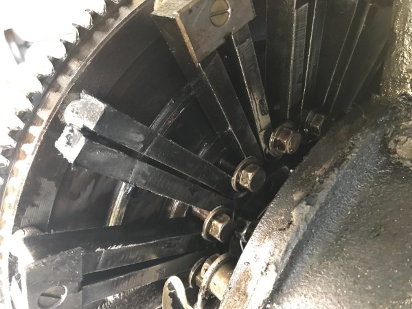

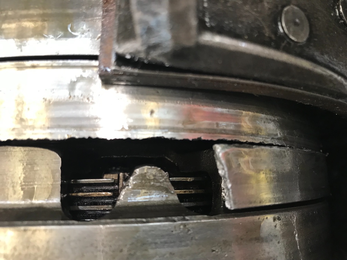

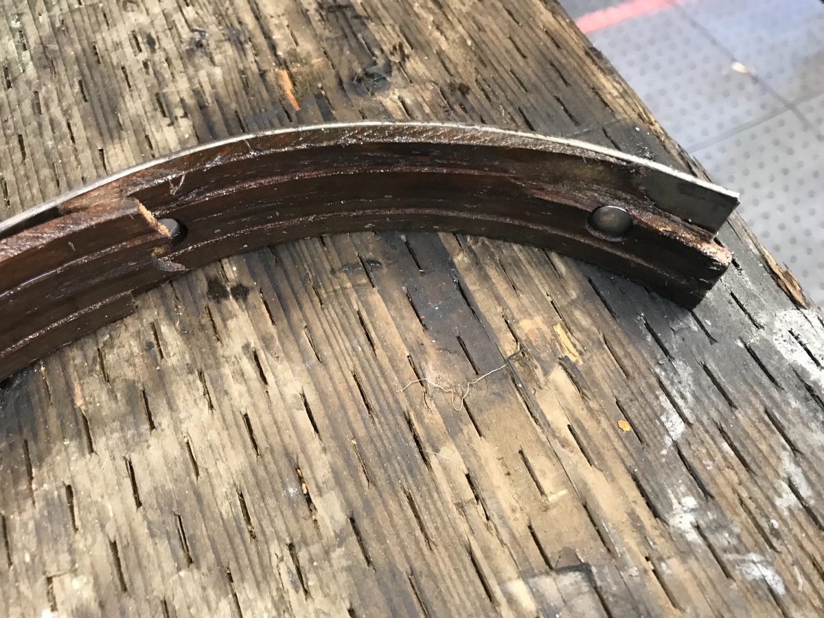

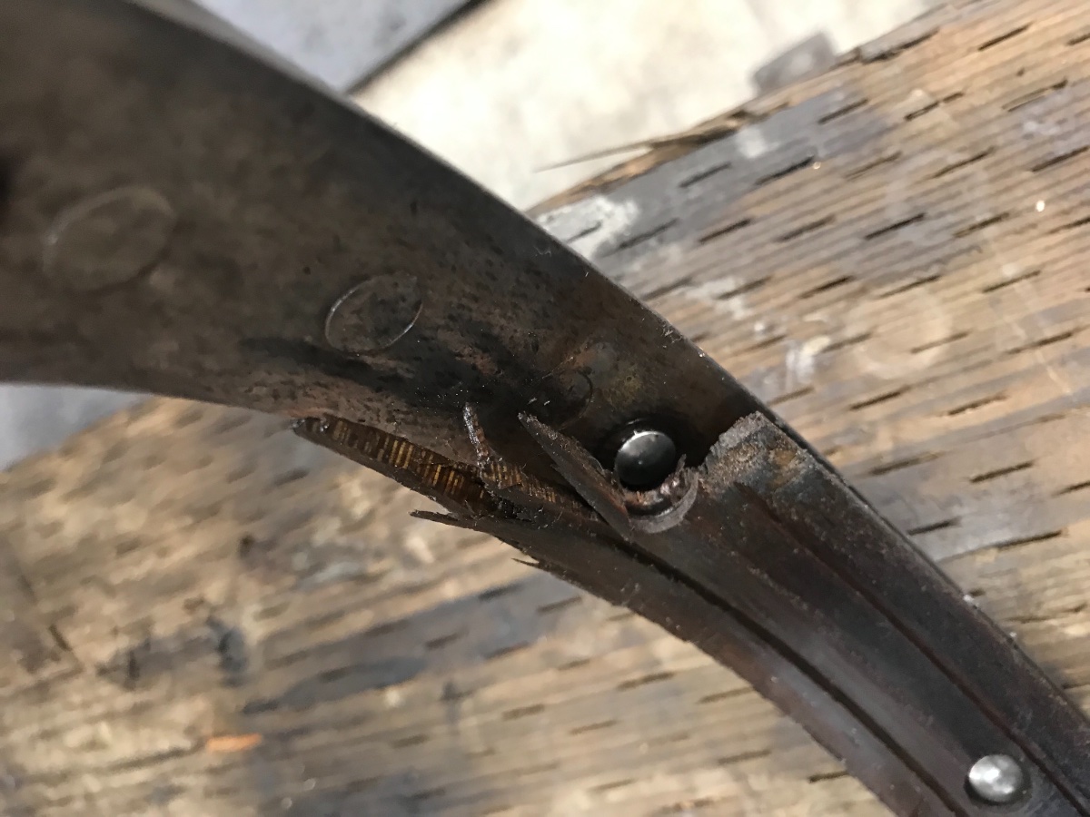

Mystery solved. Time for a new transmission...
Ok this sucks... These bands don’t look anything like cotton to me... which is what I was told when I bought the car. Kevlar?
- Posts: 2837
- First Name: Dallas
- Last Name: Landers
- Location: N.E. Indiana
Re: Major engine problem
Ouch!
Looks like wood bands.

Judging by your pictures, it looks like your low drum let go and then proceeded to take out a magnet keeper along the way.

Jeff, that is a real bummer! If it's any consolation, I believe the damage started with the broken drum, not the mag contact spring which you sort of ignored. Bits of drum certainly could initiate the chain reaction that led to this much damage. Hard to see the magnet keeper leading to a broken drum, but the busted drum pieces certainly could be thrown around enough to take out the keeper. All a bit academic really. Just let those able to help be of service, and you'll be right again.

With all due respect, the starter did not cause this damage.
I bought a sad little barn find roadster some years back and it started and ran great...in fact it had the quietest transmission you'd ever hear...but no magneto. 2400 bouncing miles to WY on a trailer and when we got here, it was locked up. Taking it apart, I found a blown up magnet assembly. I cannot imagine where the parts secreted themselves for my few successful drives, but the merciless pounding it got on the trailer trip here loosened all the debris until it all went to the bottom and locked things up. Odd things happen.
This is a cautionary tail to all new T owners to STOP driving if a loud crack or bang comes from the transmission. That is usually a keeper coming off a magnet and it only gets worse.
I feel for you friend.
some time back was the initial failure and it cascaded into this. Model T's sometimes do this, and the faster you're going when it does, usually the worse the results. This is a minor to medium blow up. Certainly not the worst by far as an observer, but always a disaster to the owner.I heard it inside the engine once before but it went away

Jeff
- Posts: 6710
Jeff
sounds like some good luck headed your way, but in any event a positive attitude should carry the day. Best wishes for an enjoyable tour.
AdminJeff
Right on Mark. It really is amazing what a drive in the T in the afternoon does for the soul and how it calms my brain. The people you meet along the way, the kids (and parents) who wave endlessly, the sun on your face, the countless rattles that come and go. The horn honking from passers by still gets me now and then. Folks can’t seem to help themselves to try and get your attention when they see a T, but it alway causes me to do a double-take.Mark Osterman wrote: ↑Fri Apr 12, 2019 6:24 amJeff, I’m so sorry this happened. I drive my T nearly every day for the very same theraputic reasons. I hope you can get a couple of T guys to come over like a Amish barn rasing and get it fixed up as soon as possible to get you up and going again.
The Amish barn-raise may happen Sunday. Fingers crossed.

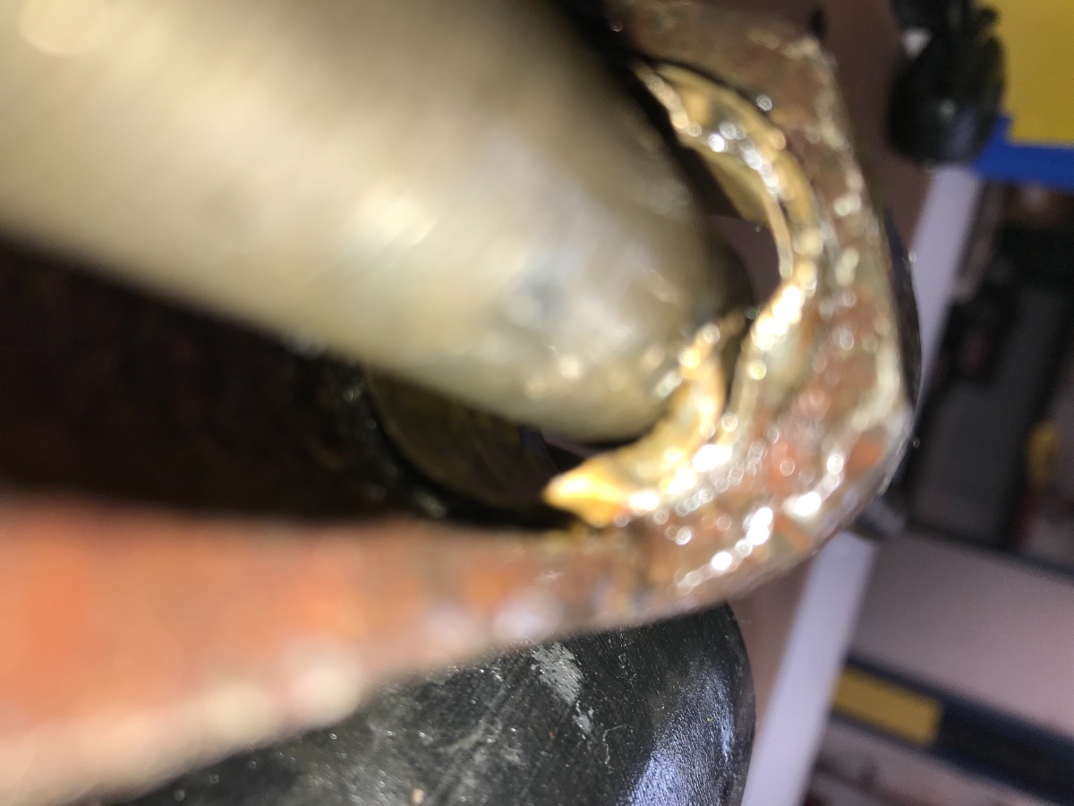

Jeff,
It just happens that I am currently dealing with a similar situation, exception being nothing as catastrophic yet. I decided to change the break in oil on my '24 roadster project and found a couple of brass bits in the drain plug. I'll bet you can guess where they belong.
The engine has been running splendidly but is about to be removed and inspected. I'm hoping to find less damage than you have encountered, but you never know what lurks inside a Model T engine until you break it down!

Randy, before you tear into it, I suggest you investigate further. Those bits may well have been lying under the plate in the bottom of the pan for ages. With luck, they may have been replaced long ago but the bits never retrieved. If all the keepers are still in place, the screws should have been replaced. Hard to believe that you could lose a screw head, let a keeper loose and not have any idea that it had happened until you dropped the oil.
Best of luck, Allan from down under.

Alan,
Thank you for the heads up! Before I go to extremes, I will do some further investigations. The engine is a complete unknown to me. This car sat in the back of an auto body repair shop for more than 30 years, lacking only the body to be reassembled. I will post the outcome later.
RB
