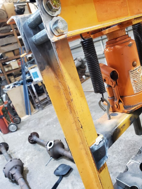

I reinforced my axles before pressing gears with 2 pieces of angle iron, about 24" long. I put them around the axle and used radiator clamps to hold them in place.

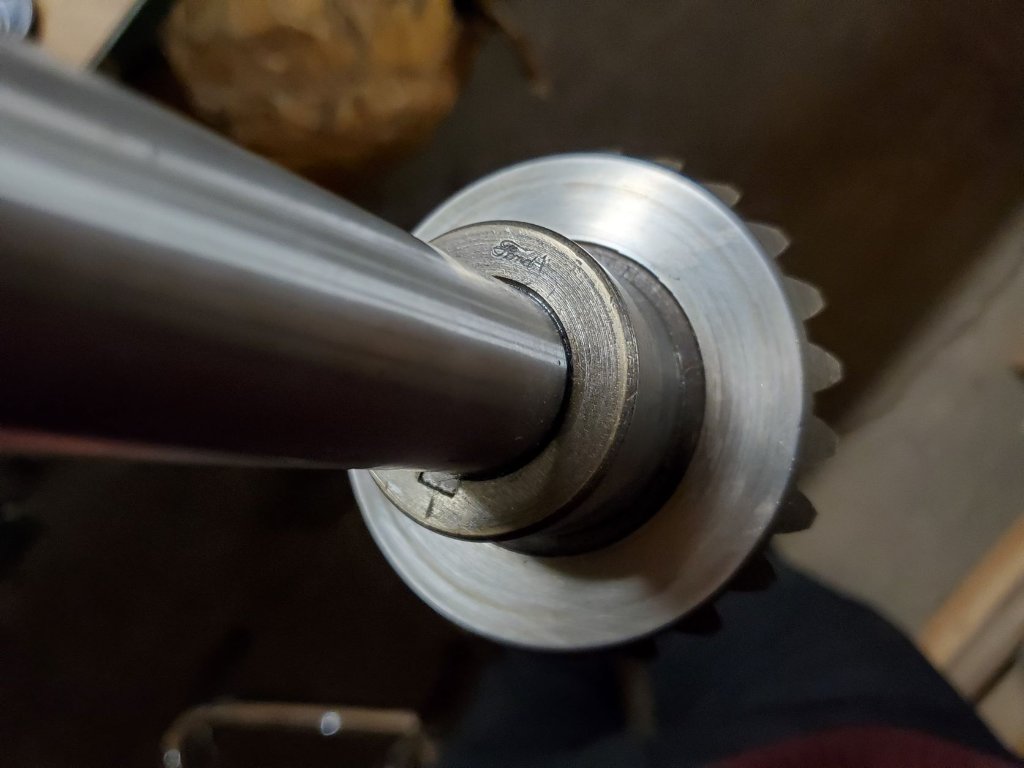

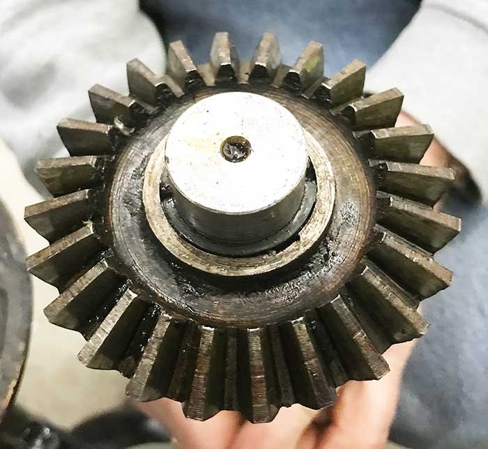

I must really be dense. When you describe getting a "a piece of short pipe the diameter which fits inside the recessed area inside the axle gear teeth" wouldn't the pipe block access to the clips that need to be removed?
Or is it that once you've pushed the gear down to clear the clips, the gear stays down after you remove the pressure so you can lift the pipe and remove the clips?

Re: Axle Gears
A picture is worth a thousand words....
