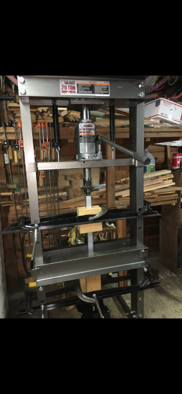

I broke an axle in 2019 and bought two new ones from Chaffins garage. I bought a 20 ton press from HF. I used a 1” tube as a safety brace. One gear was stubborn but both came off with this set up. I used a large socket, augmented with a stack of right sized washers to press the gear on so I could get the lock off. Then a smaller deep socket to press the axle off the gear.

Post by Oldav8tor » Mon Jun 06, 2022 3:19 pm
A picture is worth a thousand words....
