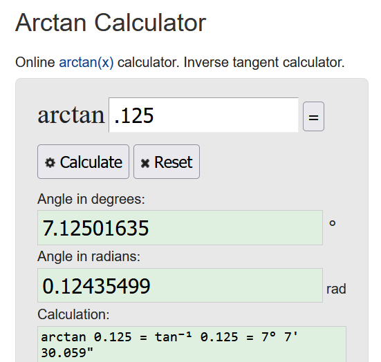

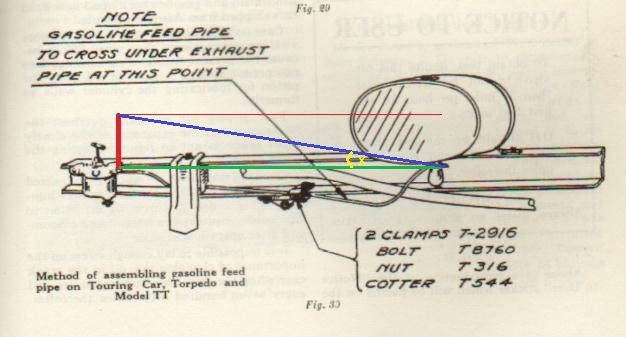

To calculate the approximate angle use this calculation tan (X) = opposite side/ adjacent side and then convert that value to degrees
The angle X is the slope of the hill and that depends on the height of the fuel (opposite side) in the tank because that can vary and the distance from the carb to the sediment bulb (adjacent side) is fixed
Foe example
the RED line represents when the carburetor is higher than the fuel in the tank
the GREEN line is the distance from the carburetor to the sediment bulb So these numbers are just to show the example
The fuel height = 6 inches and the distance between the carb & sediment bulb = 48 inches
So 6/48 = .125 which is the Tangent of the angle x.
To convert that is easiest to use the internet calculator https://www.rapidtables.com/calc/math/A ... lator.html
Foe example

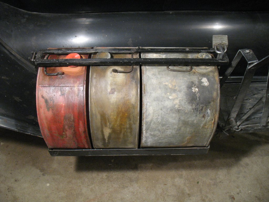

- Posts: 7395
Re: Minimum gas in tank to be on safe side?
"Two gallons is plenty. One is not enough."

- Posts: 7395
You don't have to worry about it if you never leave home without these. They have saved me an unscheduled long walk more than once.
