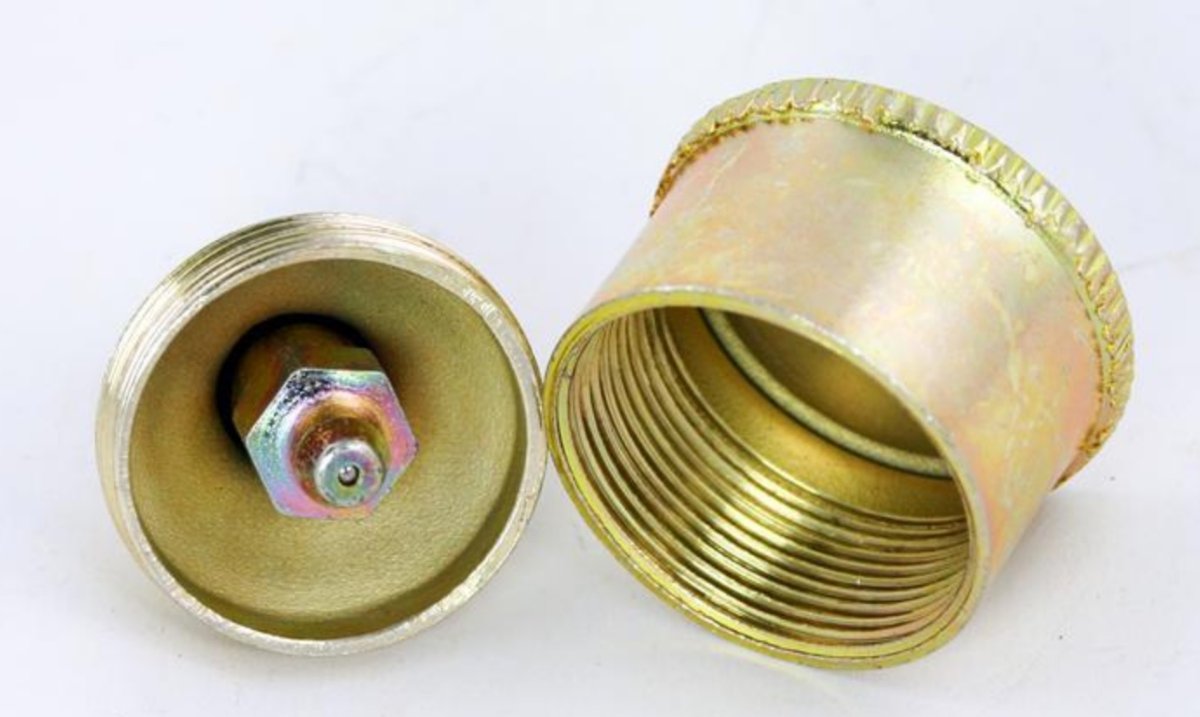

Previous posters gave you very good advice. The "ball" is one area I service (with Timken red bearing grease) prior to any tour and during regular maintenance. It doesn't seal that well and grease tends to disappear. Do yourself a favor and get the grease cup with the hidden zerk fitting (Lang's 2579GR $8.95) - The vendors also carry the smaller cups with hidden zerks and you'd be well-advised to replace them all. Photo 1

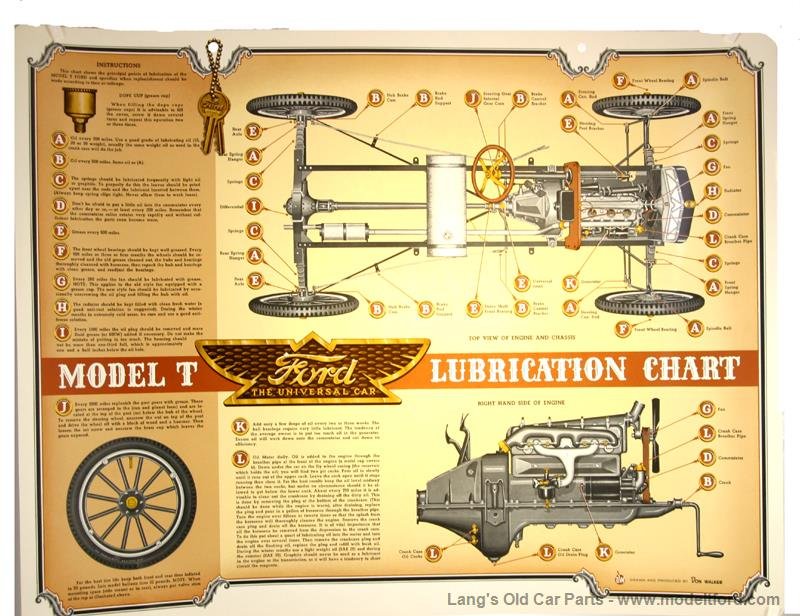

The oil in the ball may be there for the reasons previously expressed. In addition, sometimes people neglect to install the "Transmission Driving Plate shaft plug" where the differential plugs into the 4th main. Photo 2. If you ever pull the rear end take a look up there and see if the plug is in place.
(Lang's 3324B $0.95)
