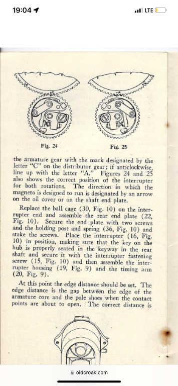

I was just suggesting the safety spark gap as it was a means in the manual to test for function. It said if it was installed on vehicle, to remove all wires and ground, and turn engine over briskly and you should see a spark in that area if functioning correctly. I don’t want to mess it up so definitely will avoid that!
There are no rotation arrows, but it seems that it is a clockwise setup for the Model T, with an anti clockwise points set, (since it turns opposite from the gear end). When assembling, I made sure to line up the timing marks, C for clockwise on the distributor gear with the dot on the shaft gear. I tried following the manual as close as possible. This is the manual I used: https://oldcroak.com/magneto-service-ma ... osch-1928/
And here is the pic of the timing assembly part, I basically matched the picture (on the left since that’s the point plat direction I have):
I’m at work now so I was unable to adjust before leaving. But with everything how it is now, turning the shaft and if I touch the end where ground wire goes to switch you can feel a tingle…but I’m barely turning by hand. Once I adjust points I’m gonna put a socket and long ratchet on it and spin it quickly with the plug wires and plugs connected. Unless it needs to have a ground connected then I’ll figure that out for countertop testing. I switched out the armature as the collector ring was broken on the old one, but it seemed to fit fine (not to mention a lot cleaner). Lol

This is the points set for the side drive like yours or the cross shaft front drive eismann, matco, Columbo, others. “ C” denotes clockwise…..** note the gap, ****

This points set is for the 3 gear splitdorf aluminum front plate with mag mounted shelf on the side. NOT YOUR STYLE …… It’s marked “A” for anti clockwise or counterclockwise. Points are interchangeable, so never pass up a junker, it may be low mileage and have some good usable parts.

DISREGARD ANY STAMPED LETTER(s) ON THE front side of the points set…..the C and A are stamped on the backside where I’m pointing. Yes, it’s confusing, but you will soon be an expert, and amaze and thrill your friends and associates with a great ignition system! Let us know when you pee your pants!
