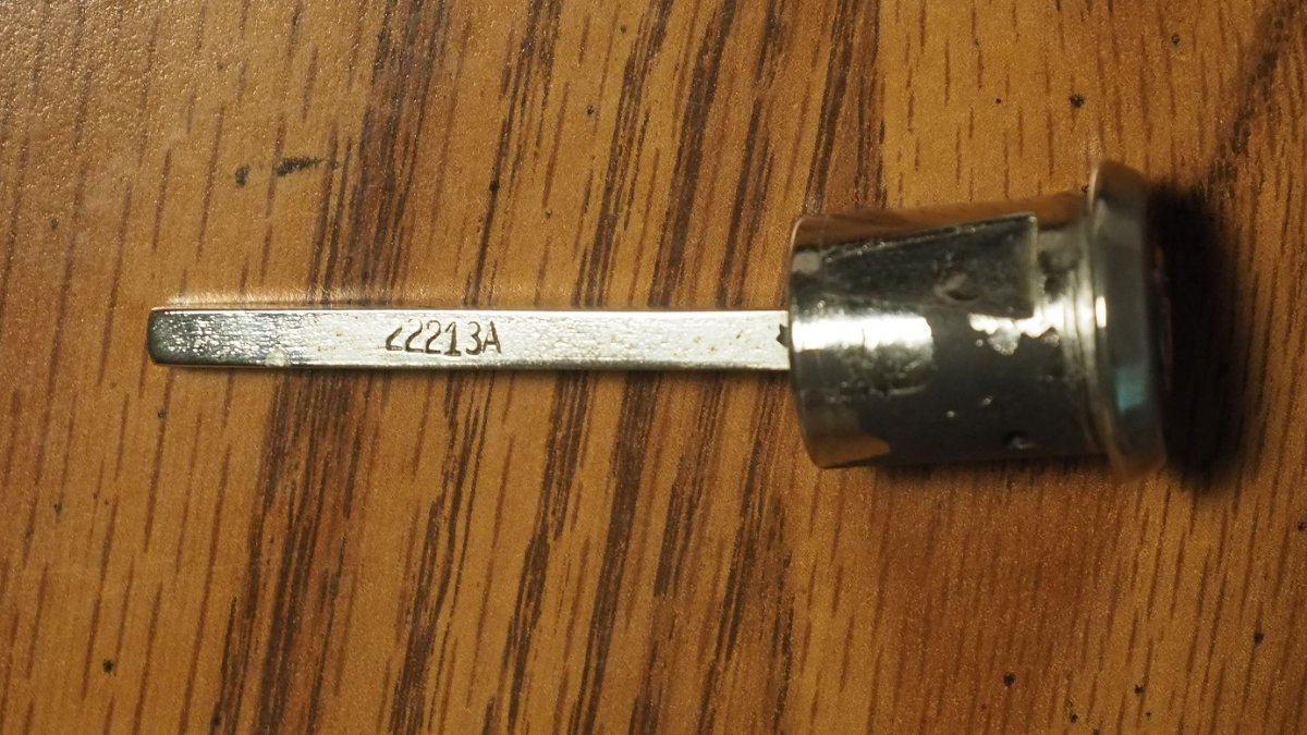

The original lock has a number stamped on it that is slightly different than the number I found in the service manual.

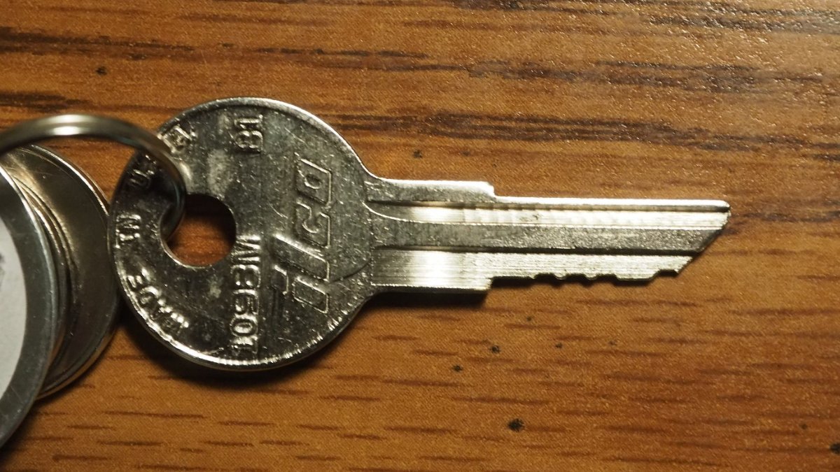

It looks like 2 numbers are switched around. I had a key made with the code on the original lock, but it doesn't work.

The 1 is the full key width with no notch.
The 1 in the sample suggests the 2 and 3 notches are not cut quite deep enough.
J1MGOLDEN
- Posts: 1314
- Last Name: Golden
- Location: Bowie, MD
Re: Door Lock Question
The 3 notch looks just a little too deep for the 2 notches.
The 2 notches should be half the distance and in between the 1 and 3 notch depth.
I don't recall the depth ratios, but you can measure any original Yale key not badly worn and find the answer.
