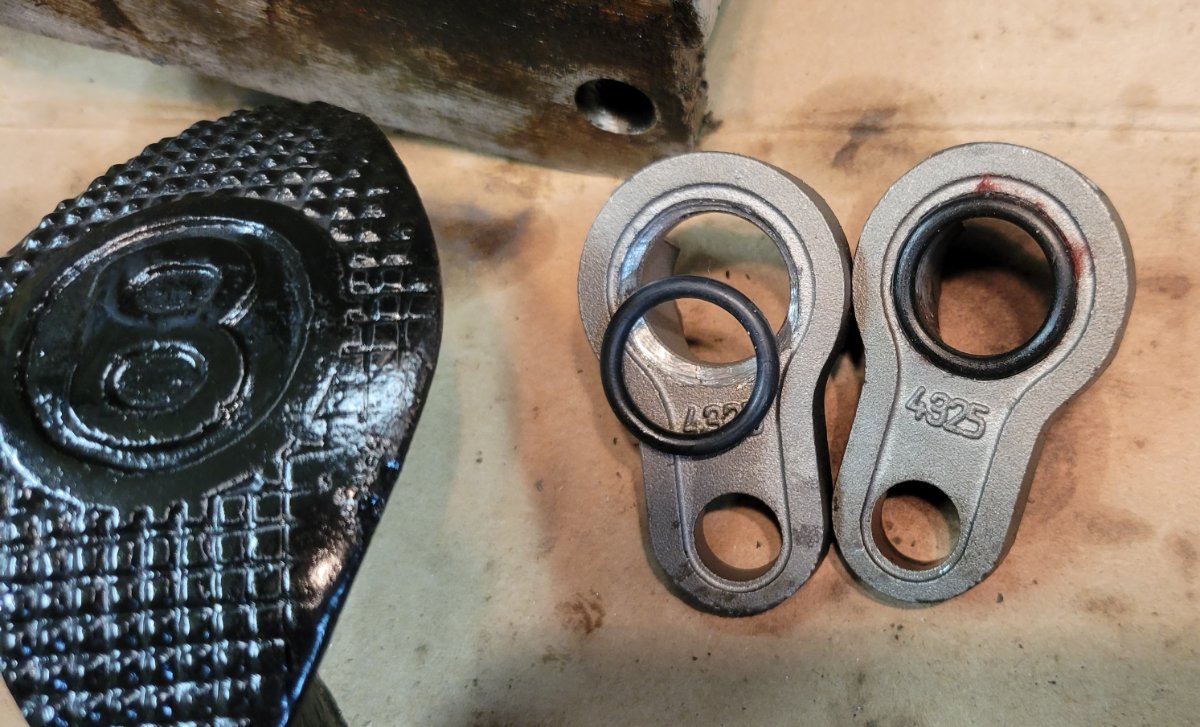

I'm going to have the happiest hogshead on the block with these new pedal cams!

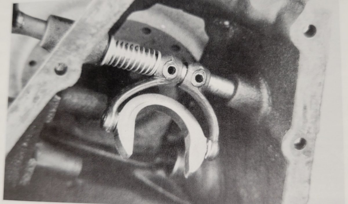

I'm putting in O rings to help with the oil leaks at the pedals.
The transmission book shows how an O ring, spring, and washer can be installed on the clutch control shaft to stop the oil leak there.
Has anyone done this? Is it effective (or really needed)? Or just something to get carried away about? Any reasons not to do it?
Of course for the early hogshead the clutch control shaft goes all the way through to the outside on both sides, so I'd have to use two O rings, springs, and washers.
Should I do it? Yes or no?

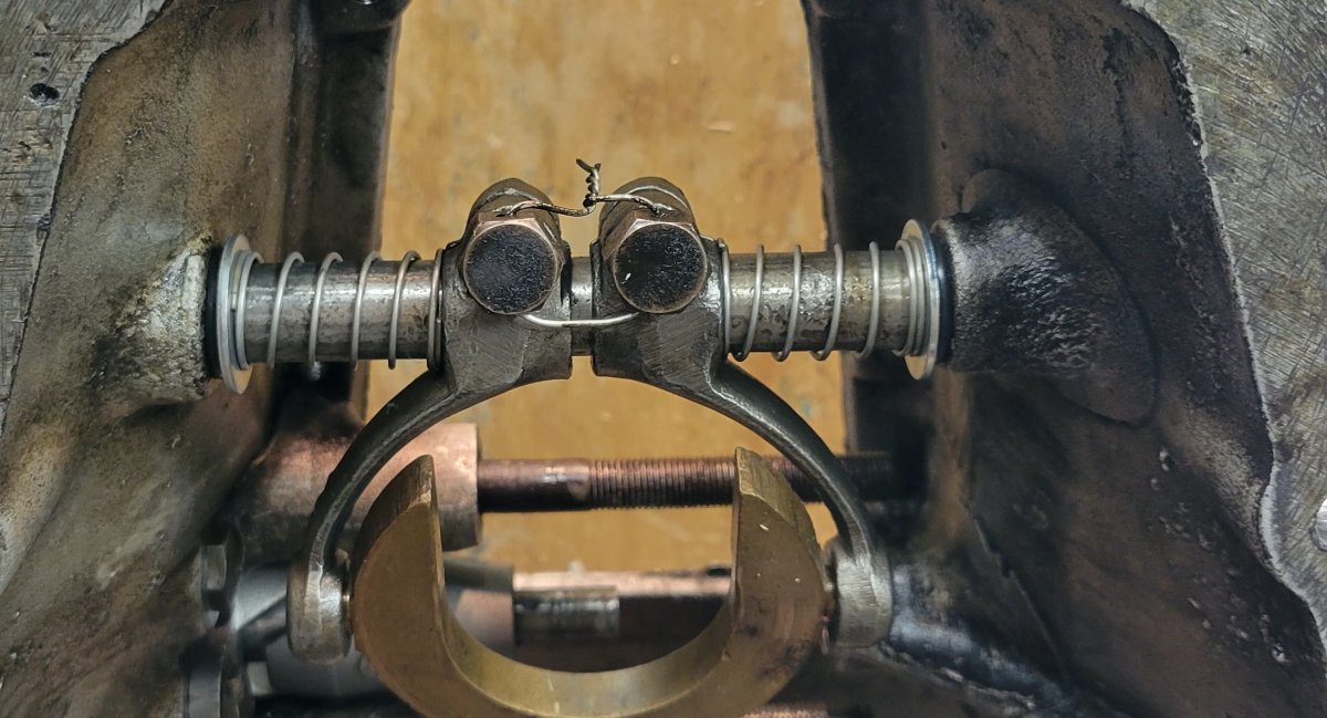

I would Keith, considering the early clutch throw-out arms use bolts which make the task that much easier !

I've done this as well on my '22 and it's worked quite well. For anyone considering doing the same on the later hogsheads where the shaft doesn't go through, it may not matter but it makes sense to me to use a spring on both sides of the clutch fork to keep the fork centered.

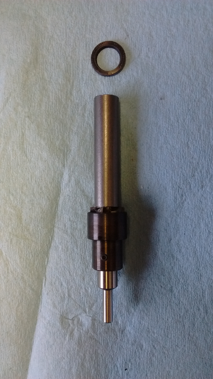

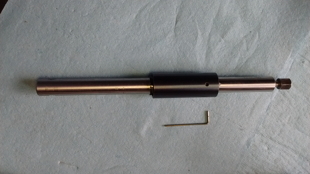

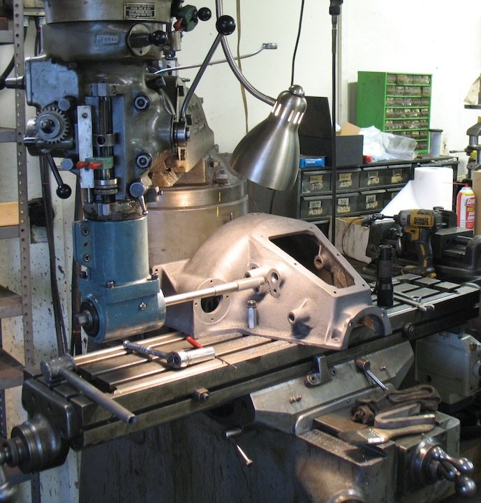

An O ring is an easy fix, of dubious effectiveness, especially in an alloy cover. Most times the holes are well worn and the shafts also, meaning the clearance between shaft and cover is way over spec. I hand ream the cover holes to take a thin walled bronze bush to get the size back to spec. I have made a tool with a fly cutter to cut a seal land in the outside of the cover. It is driven with a carpenter's brace. The I use use a proper oil seal, as John does. This allows the shafts to still be oiled. When new shafts are used, this makes really nice job of it.
An added bonus is the open end on the clutch fork rod can be properly sealed. I leave that bush protruding outside the cover, and plug it with a cup type freeze plug. All this is achievable with hand tools.

I've done it a few times. A second spring is unnecessary unless the right side of the shaft goes all the was through. There isn't enough pressure on the spring to cause wear on the fork.

DON’T DO IT ! The spring & o-ring on the clutch shaft is a poor choice if you drive much. The spring keeps the bronze ring loaded against the steel collar in one direction instead of “floating” and wears out its inner diameter.

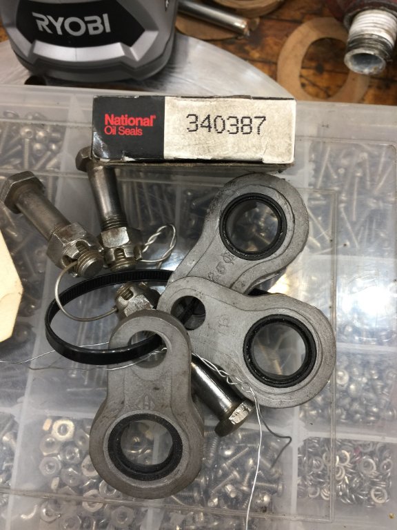

I concur with John and Allan. Mike Bender had an informative post on doing the job with lip seals but I can't seem to turn it up. Attached are a couple of his pictures. I use a mill as well but don't have an angle head. I stand the cover on its side bolted to a large angle plate. Be sure to retain alignment, especially on the clutch shaft. And, as John mentioned, take care that the outer pedal cams are lubricated. The Timken seal is #253747. Can be cross referenced to any brand.

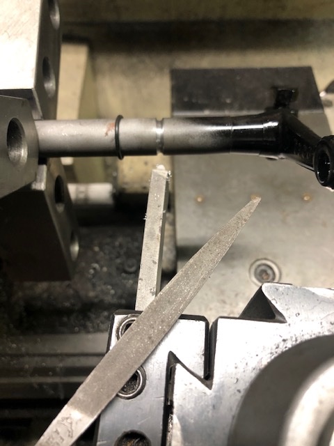

Use a 5/8” Id X 1/16 Oring. Chamfer the edge of the bore. Grease and install.
Use a long reach cutter and make a groove leaving the Oring proud on the shaft.

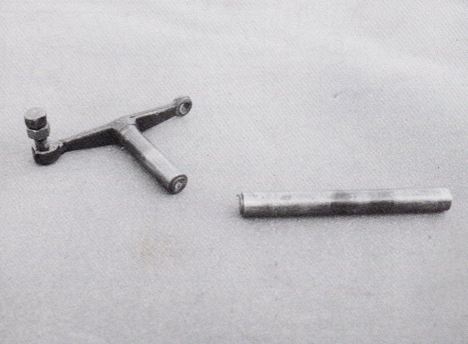

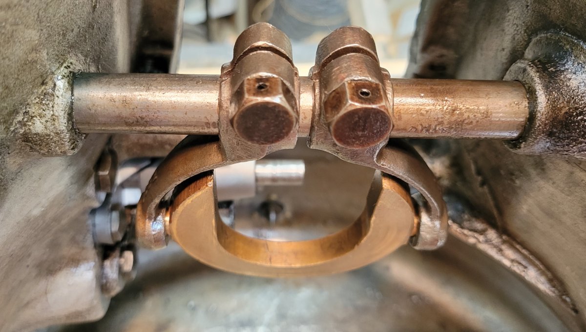

Have seen this once or twice on a grooved shaft.

This is what I feared cutting a clutch or pedal shaft. Common sense warned me away.
I had not seen an actual failure until now. Thanks.

O -rings installed. I had to do both sides because on the passenger side the shaft goes all the way through. It also gives equal spring force on each side. I like that. All safety wired and ready for installation.
