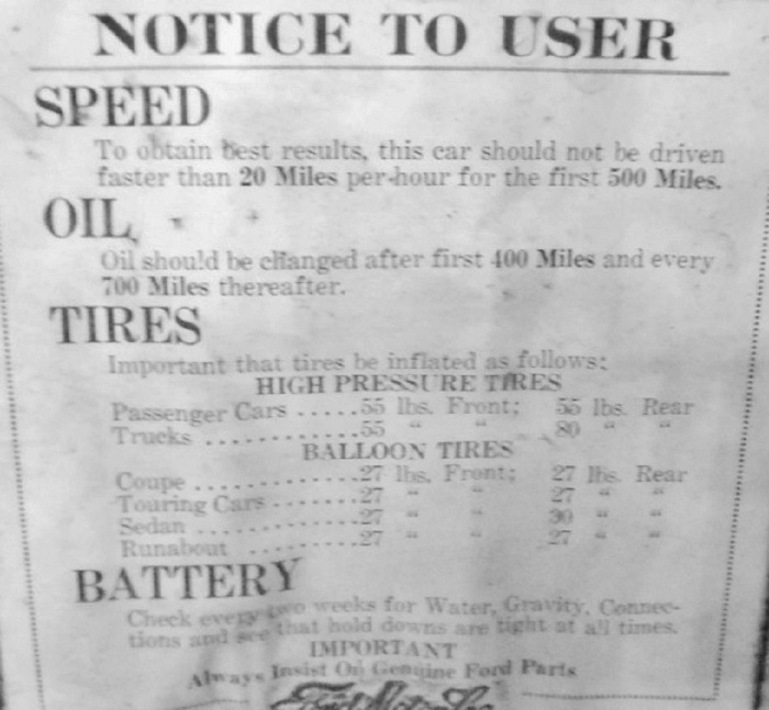

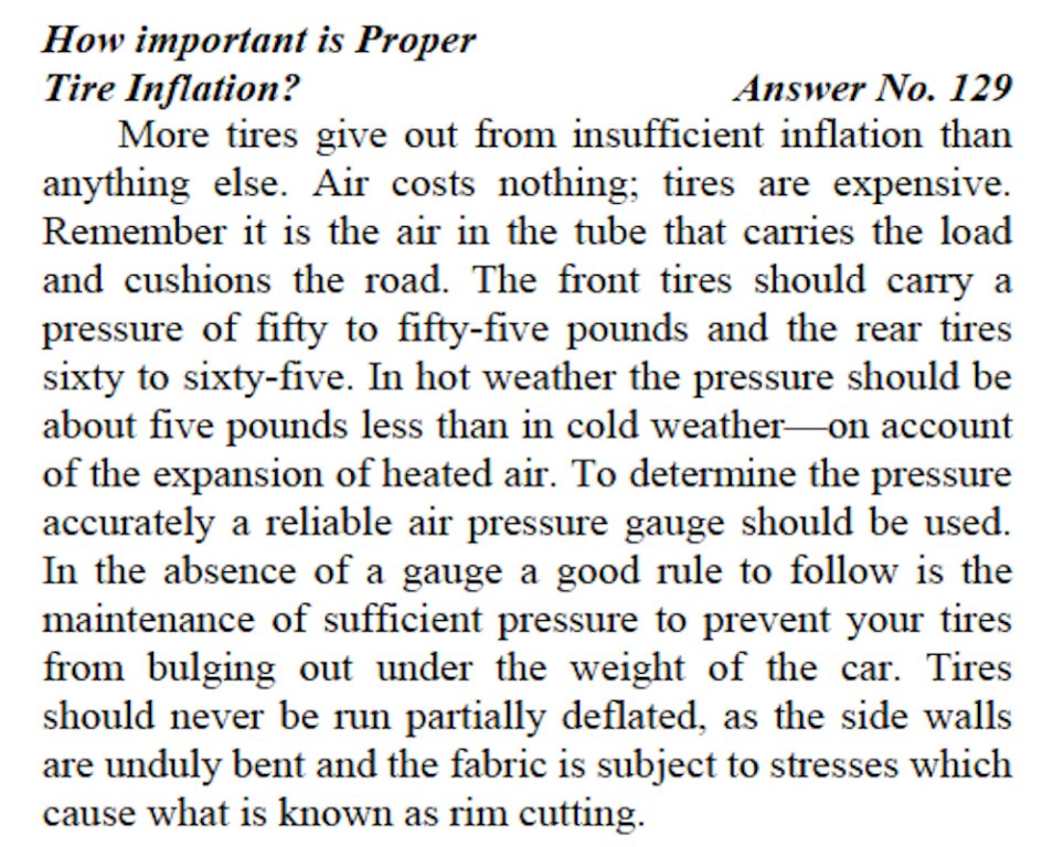

Here is what Ford stated.
55 psi for clinchers, 30 x 3 1/2". Normally put in 60 and don't let it fall past 55 for safety.
Re: Clincher air pressure?
Thanks Dan.
This is from Floyd Clymer's reprint of a Tire and Rim Book. (1915 to 1927) While the new tires are better in many ways than those made in the teens and twenties it serves as a guideline. Note that it says "minimum" inflation. I have been running 40 in the front and 45 in the rear with good luck. I can see more may be better.

Seeing Dan's illustration, I recalled that Bruce's encyclopedia comes with owners' manuals for all years. This is from the 1915 book.

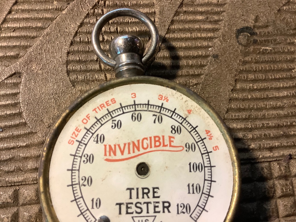

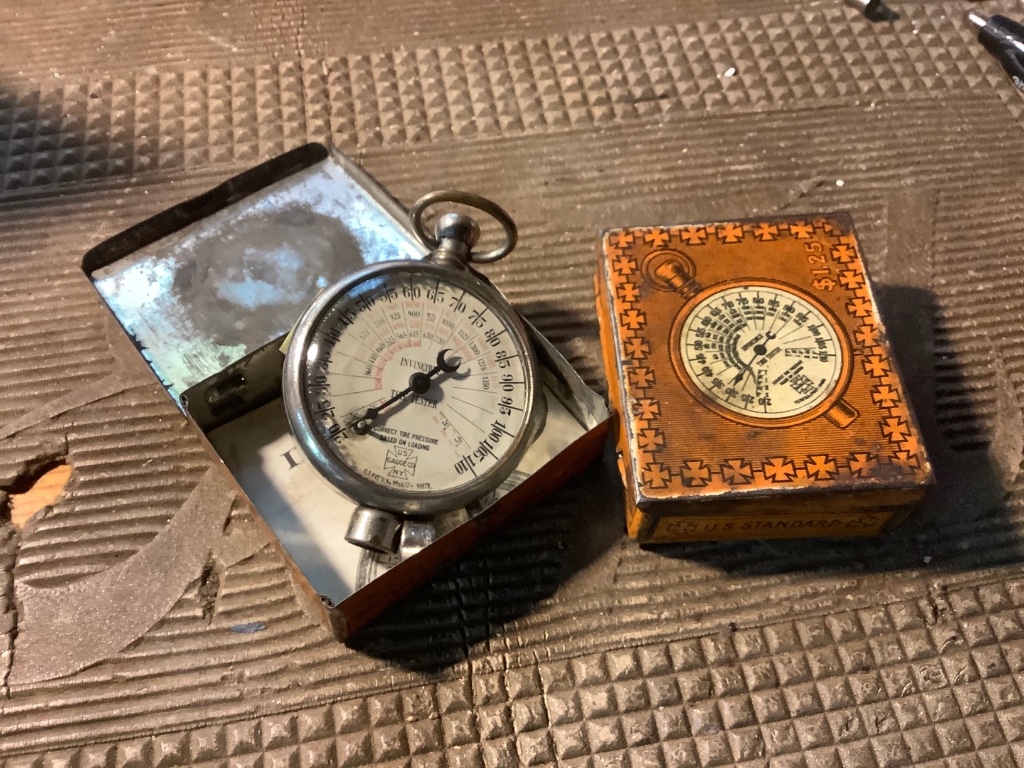

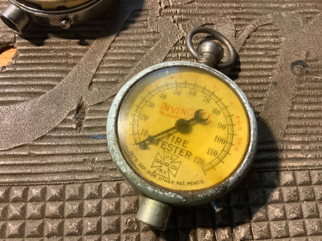

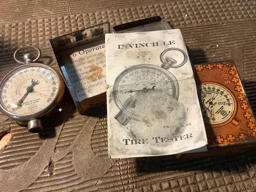

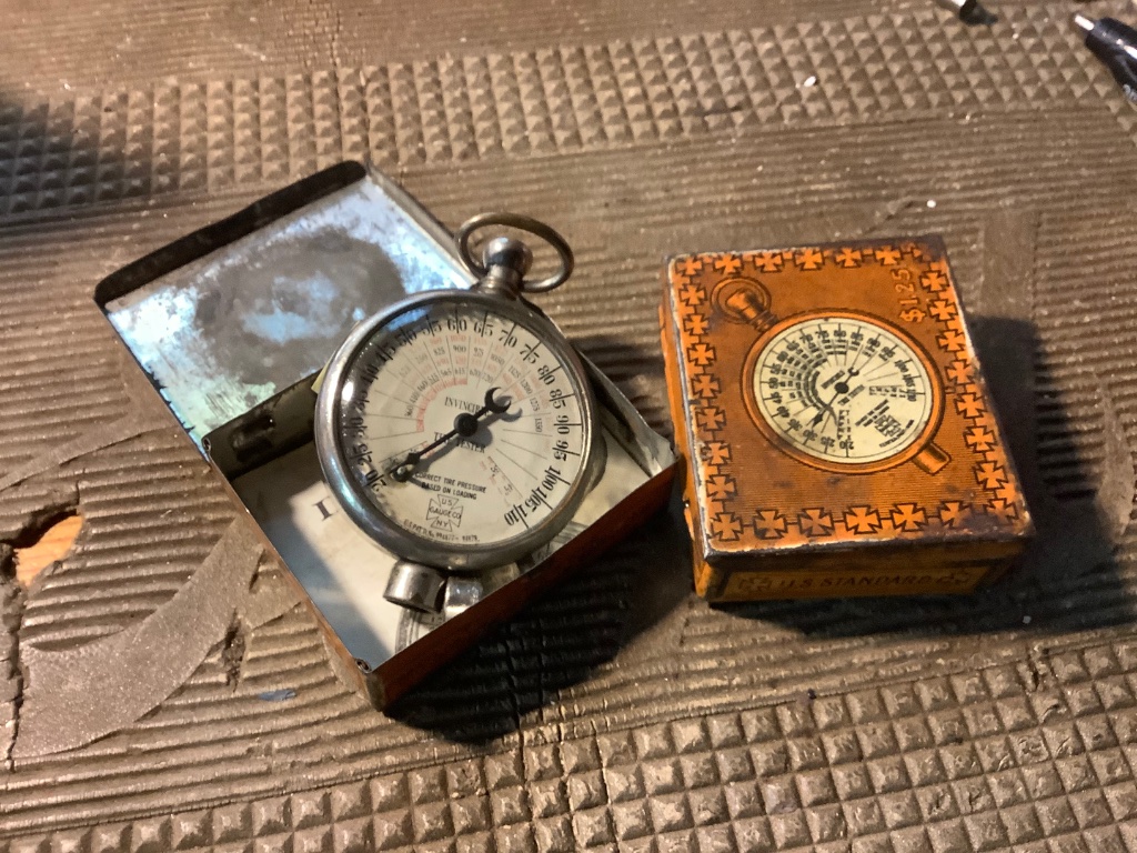

In the first couple years of motoring, you would want to purchase this tin litho encased beauty. You would then need to do some serious ‘ciphering’ before heading out.
Dropacent
- Posts: 3384
- Last Name: Morsher
- Location: Norwalk Ohio

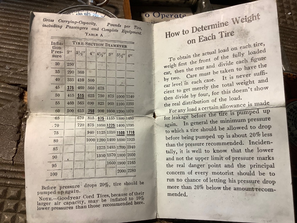

By the time of model Ts birth, things got a bit easier, at least to US Gauge standards. 60psi for 30”, 70psi for 30x3 1/2 . The invincible was patented in 1906 , so just perfect for the early T.

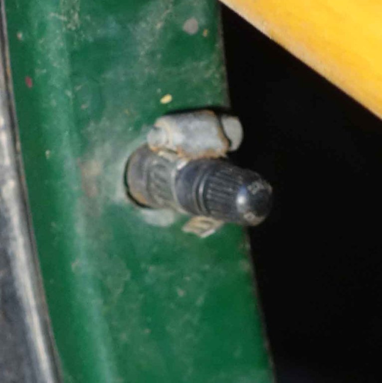

At 55-60 I have never sheared a valve stem with 30 X 3-1/2's.

The tire rotating & shearing the valve stem is most common with powder coated rims.Mark Gregush wrote: ↑Tue Jun 14, 2022 10:32 pmAt 55-60 I have never sheared a valve stem with 30 X 3-1/2's.![]()

I would assume that using a metal valve stem, bridge washer and retaining washers @ the rim would protect against tube rotation and that most of the shear issues are coming from using rubber valve stems. Is this a good assumption? I've been running mine at 55-60# with no issues as of yet.
- Posts: 5155
Fair assumption. The metal stem locked in will stop the shear.Retro54 wrote: ↑Wed Jun 15, 2022 8:48 amI would assume that using a metal valve stem, bridge washer and retaining washers @ the rim would protect against tube rotation and that most of the shear issues are coming from using rubber valve stems. Is this a good assumption? I've been running mine at 55-60# with no issues as of yet.
You want to have some talc in the tire case. If the tire does move a bit, no harm.

Just for the heck of it...thought I'd mention it...an old way of measuring the weight on each tire was to take four 3x5 cards and 'box' where the tread meets the road tight against the rubber. Mark them, remove them and figure out the square inches of rubber on the road.
Tire pressure gauge and take pressure reading...
Multiply the PSI seen by the square inches...and...walla, walla.... magic!

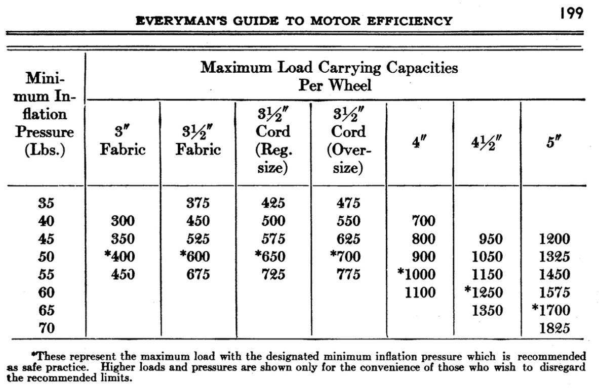

How are we coming to the conclusion that the skinnier 30 x 3 tires, (fronts), need less air pressure than the 30 x 3-1/2 tires, (rears)? That runs counter to everything I've ever heard about tire inflation. By this thinking, the 21" balloon tires should have what, 100 psi? (of course not)
If we assume even weight distribution and we look at one of the charts above, we'll see that for a 450 lb. load, a 3" tire should be inflated to 55 psi and for that same load, a 3-1/2" tire requires only 40 psi. That's based on tire data from the Model T era of course. I would inflate the 3-1/2" tires to at least 50, (but wouuld scared to do 70!!).

This chart doesnt mention clincher or non clincher. The higher pressure keeps the tire in the clincher rim. Remember also, back then clincher beads even overlapped in the middle. Todays tires do not. There is a high risk of the tire coming out of the clinch. Along comes balloon tires. Air pressure was determined by load, not a standard 32psi. Charts show much lower pressures.
Clinchers ride hard. Thats got to be why they went to balloon tires. You can get a safe soft ride. You that have both on different T's can attest.

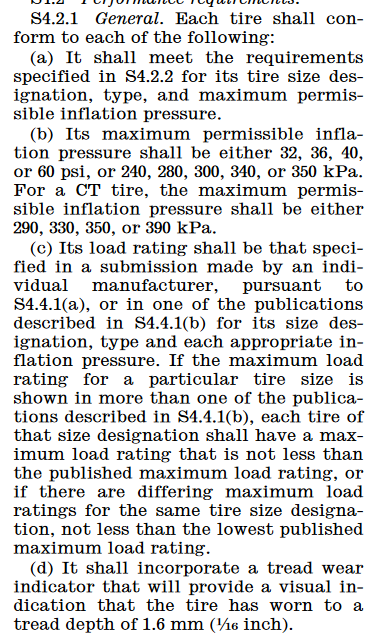

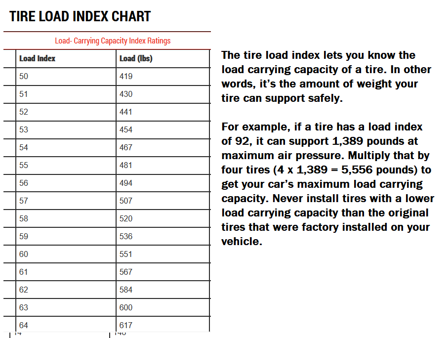

- Posts: 6545
Today's tire construction and material is quite different than those made in the past. So using 100 old pressure charts arn't likely to be applicable. Current DOT laws https://www.govinfo.gov/content/pkg/CFR ... 71-109.pdf
Example --
Load Chart https://www.tiresplus.com/tires/tire-bu ... dex-chart/ --
So what's it say on your tires - values vary by brand so its not one value fits all

John K, Thanks for the reply, as you can see from Allan's great answer what you were seeing was the result of incorrect installation of the tire and tube.
Some tires were so small in diameter if one side was stretched onto the rim first it was so tight on the base of the rim it was impossible to move it to under the rim bead, so it covered the valve stem hole, until both sides are in the rim and air is pumped in to force the beads of the tire out to the side the valve hole was blocked off, hence the cutting away of the bead for the valve stem.
While I'm here I should mention also that the rubber stem valves now on tubes are "not fit for purpose" another cost cutting problem the suppliers have inflicted on us. The rubber valve stems can't take the high pressure as they are only vulcanized at the very end of stem and the air pressure forces it's way up to the end. If you are lucky you may get a slow leak whilst parked but if you are driving and it starts to leak the tire will lose its ability to grip the rim and driving or braking will allow the tire to move around with the valve stem being ripping it off and sometimes a few seconds of no control until you come to a stop ( or worse)
Here is a photo taken of such a valve stem cut open, note the chalk powder along the metal tube and the right hand end of the stem where the thread begins, the white mark is the small vulcanized seal of the rubber to the metal stem. That happened on the Pincher Creek tour in 2011, The immediate fix was to put small clamps around the valve stem on the other tubes below the threaded end. I still have one on a wheel 11 years later holding air. The best answer is obviously to replace the rubber stems with metal ones which everyone has intimated before.
