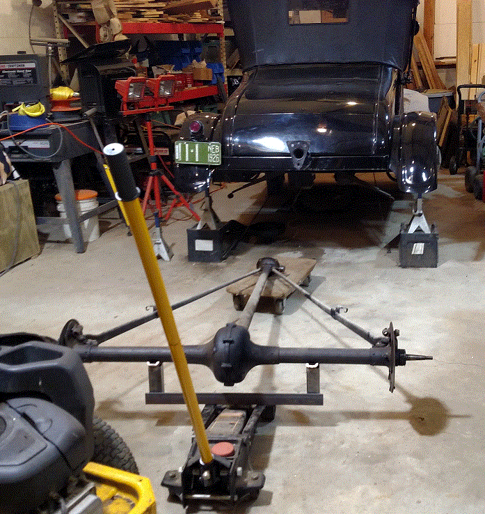

The way I remove them is to jack up the car and put high stands under the frame just in front of the rear radius rods. Be sure to chock both front wheels so the car won't roll. then with the u joint 4 bolts out, I lower the axle enough so I can put a small 2x4 under the end of the spring. I pull out the shackles and lower the axle and roll back. If the wheels are off it is easier to roll and can be lowered enough to pull out easily. To put back on, first I pack the ball joint with grease and then If I am lucky can install the u joint in the back of the transmission. If not so lucky, I might need to wire up the spline to the grease cap behind the joint. Then turn the axle a little at a time till it lines up and goes in. A helper makes this easier. The gasket goes between the 4th main and the hogs head. There is no gasket on the side where the U joint ball is installed. Install a shackle on one end and then put the 2x4's under both ends and jack up the axle enough to spread the spring to get the other shackle in. Then I install both wheels and lower the frame. On a light weight body, you might also need to put weight in the back of the car.

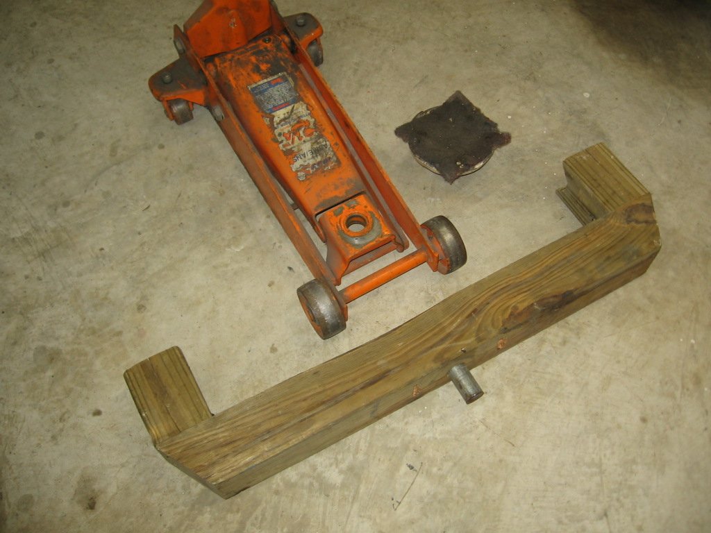

I made a spreader for a floor jack using Steve Jelf's method.
- Posts: 4972
Re: Rear end swap over, how would you do it?
Looking @ the jack adapter, I would make it much wider to pick up the castings for the backing plates. Thats a lot of strain on those tubes in the middle. That was my thinking when I built mine.

A jack attachment doesn't have to be steel. It sure makes the job a lot easier however you do it !
Get a horse !
- Posts: 2539
- Last Name: Strange
- Location: Hillsboro, MO
- Board Member Since: 2013

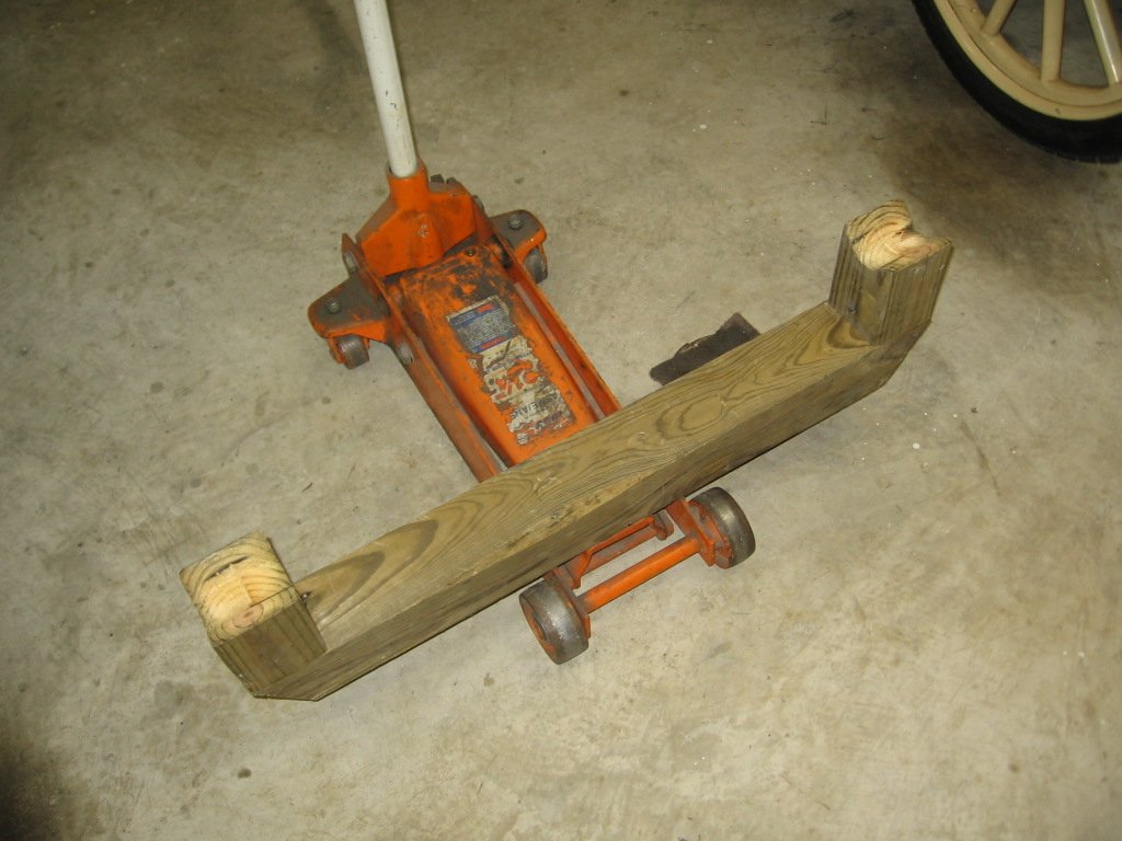

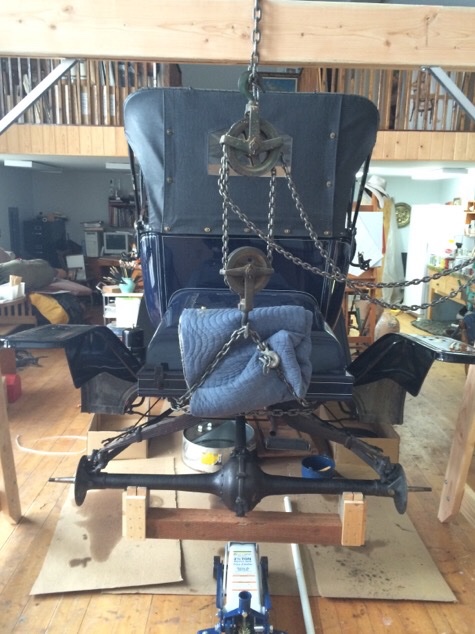

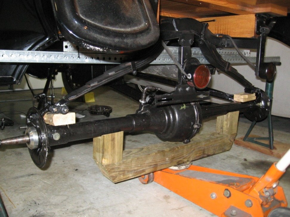

Rich is correct, here is my wood jack adapter. If you make one, be sure to put a piece of pipe in the middle to fit into the jack socket. Otherwise, the adapter can roll off the jack (I learned the hard way). I used wood blocks under the spring eyes to spread the spring as I jacked up the rear axle so I could slip in the shackles. You have to loosen (but not remove) the nuts on the spring perches to allow the shackles to slip in.
Thanks for noting that, Mark !! I epoxied a chunk of pipe into the hole I bored in the timber for a dowel pin that fit the jack. Very necessary !
Can you clarify or show a pic of how you adapted it to ensure it can't fall off the jack please
- Posts: 2539
Here you go.
I see now, Thanks Mark
