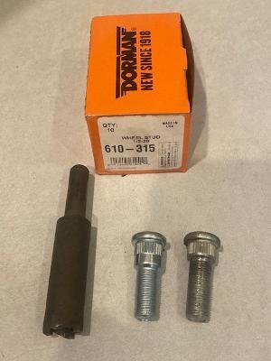

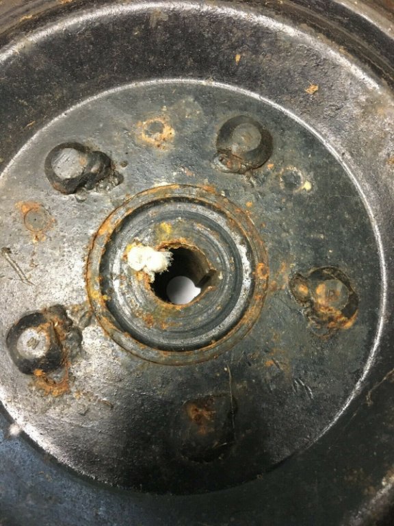

The wire wheel studs are splined and have a flat side to mate with a tab on the inside on the hub. So the question is if the hole that the stud goes has been compromised. So before anyone can answer it would be best to see the backside of the drum and what the issues are.
Good studs -
Good try but......
Good studs -
Good try but......
- Posts: 5252
Re: Wheel Studs
Studs drop in. They get pressed on a stepped lip under the threads. Takes a hollow press tool to slip over the threads & hit the stepped shoulder. That shoulder gets smashed/expanded to hold in place. Same as model A's.

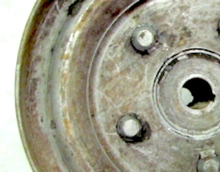

Re: Wheel Studs
That second picture represents what the back of the front hubs look like.
- Posts: 6581
Re: Wheel Studs
If the studs are loose will they pull out or spin? Trying to understand what is meant by loose. What do the lug holes in your wheels look like. The backside of should have a lip
- Posts: 8641
Re: Wheel Studs
Your car may have been run with the lug nuts loose. Or someone may not have known the right way to replace the studs. Or they may not be the right studs. When you say the studs are loose, do you mean they are so loose that they turn in the hub when you try to tighten the lug nuts? You should be able to run the lug nuts on with your fingers until they contact the wheel hub.

They are loose in the holes of the hubs. I can't tighten down the lug nuts. They won't pull straight out. On the front ones I can reach behind and press on them with my fingers and get them reasonably tight, but not the back ones.

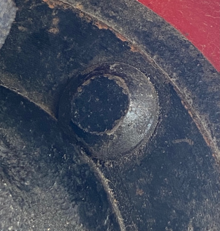

- Posts: 4084
Re: Wheel Studs

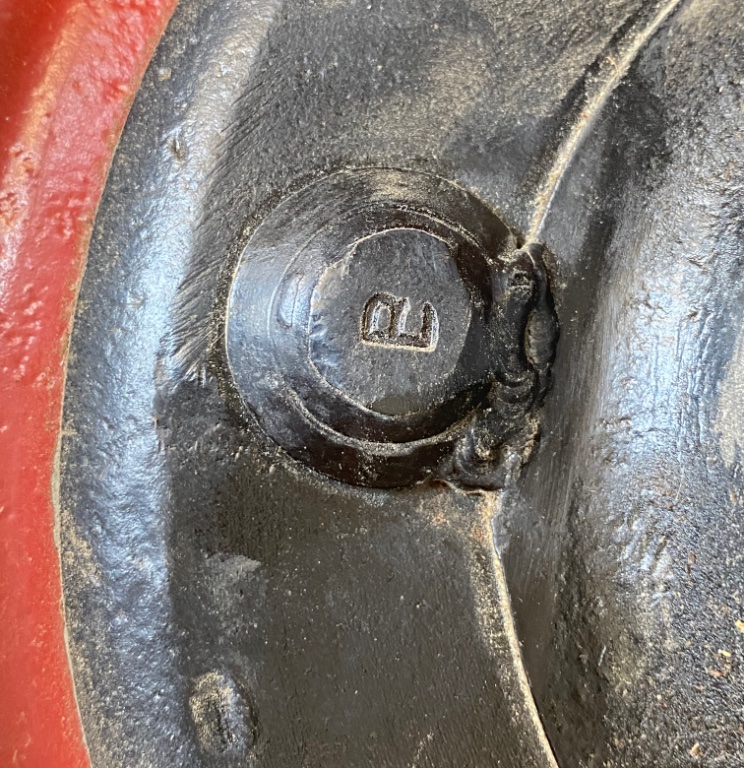

The front studs with the flange is designed to press in the hub hole, and the cut flange head rests against the hub inner rim, and is to prevent twisting should the stud was to spin. Sometimes they spin, (note the one in the photo) and weld is one fix. The repair is a new stud with flange head and with splines to bite into the worn hole when pressed in the hub.

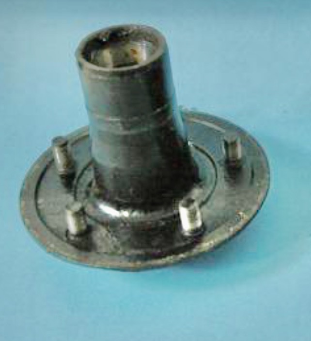

The rear wire wheel hub uses similar, pressed in studs, but the flange of the stud back is nested in the tab of the rear drum.

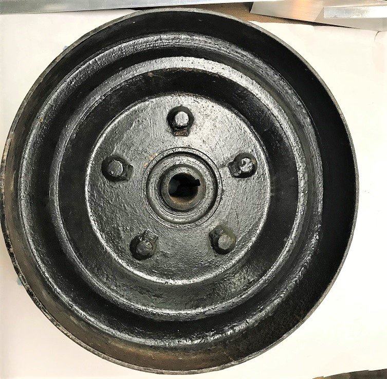

Re: Wheel Studs
CatGuy - I found a couple loose wheel studs on the front wire wheel hubs on my ‘26. My hub holes were not wallowed out - just the stud heads and the swedge surfaces worn enough to keep me from tightening the wheel nuts. The top photo shows that even a stud that’s tight does not have a lot material keeping the stud head from turning. The bottom photo shows the small tig weld I used to allow tightening the nut.
