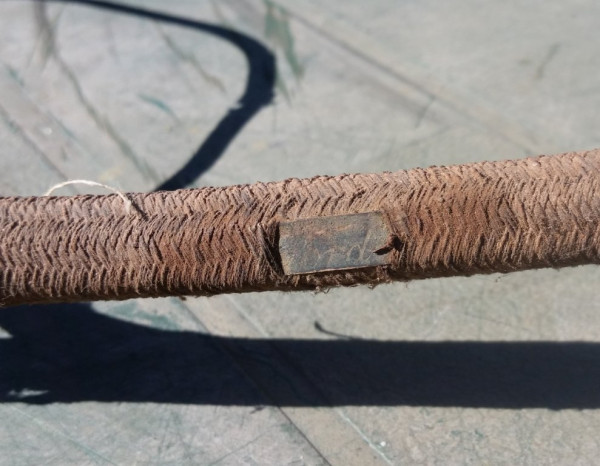

The loom tags are removable and can be refitted with no damage if you are careful. On Henrietta all three looms still had the original tags, two aluminium ones and a brass one. Her looms were not usable, so I eased them out of the loom sleeve by lifting the centre of them with a screwdriver and pulling the tag out from under the covering.
Replacing the meant bending the tags up in a U shape, parting the loom covering fabric without damaging it and then inserting the ends of the tag into slots created in the covering. Then the U shaped bend is flattened out and the legs on the tag are captive under the loom cover.
They are quite a conversation piece. I did orient all of mine so they were in the original position on the loom, but clearly visible, rather than on the underside.

Could someone post a picture? I've never seen the wiring looms with metal tags on them. Just curious.

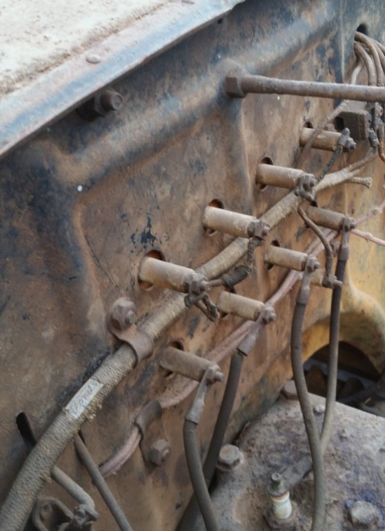

Here are two on Henrietta. The aluminium one is embossed. The brass one is stamped in. The brown areas either side of the brass one show the extent of the legs tucked into the loom.
