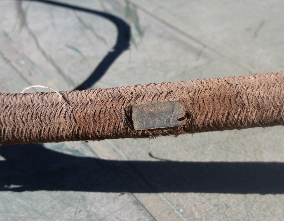

Re: Ford marked wiring harness (rare?)
Could someone post a picture? I've never seen the wiring looms with metal tags on them. Just curious.

- Posts: 6743
Here are two on Henrietta. The aluminium one is embossed. The brass one is stamped in. The brown areas either side of the brass one show the extent of the legs tucked into the loom.
