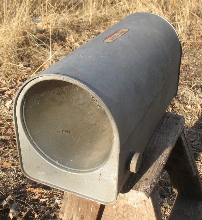

Have you tried one of these? 1941 Plymouth, Arizona desert. It was in the right front window. Mom may have gotten a little cool air, as she was sitting right beside it pulling the strings to keep the cloth wet. But my little brother and I, riding in the back seat, were dying of the heat. :)
