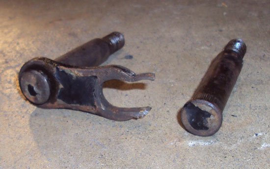

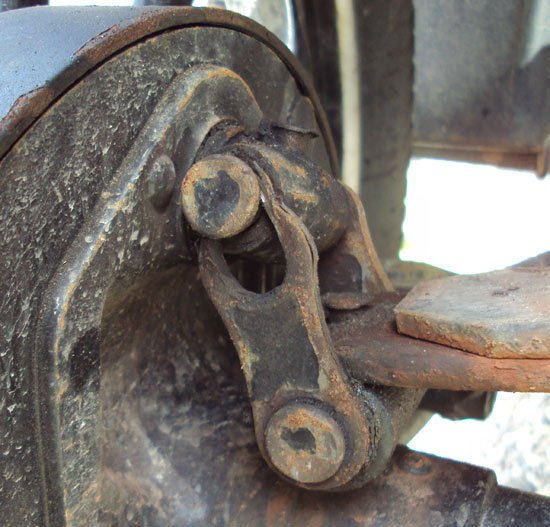

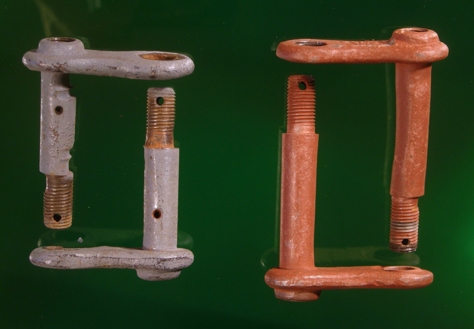

Wednesday I paid a visit to Denny Newman here in Michigan and had the front axle rehabilitated. It was straightened, top bushings and one thread insert in added with a Steven's tool, along with new brass bushings in the spindles. We also decided to replace the spring and spring perch bushings and the shackles themselves. The shackles showed dimensional wear and were somewhat oval in shape.

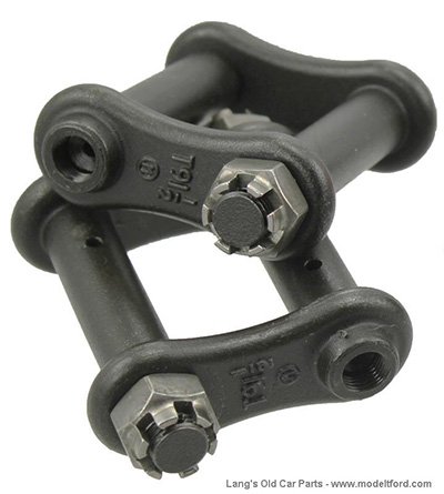

I was able to order everything I needed except the shackles ---- nobody seems to have them, at least the affordable version I was looking for. Langs reported theirs were on backorder from May 2018!
The shackles I need are the type that have an oiler on the end of the bolt - not the type where the oiler is on the perch.
If anyone has some shackles that are surplus to your needs, please email me. I especially need the shackles for the front end but all of them are worn.
The ones on there now look like those pictured below, with brass oilers installed on the head of the bolt. HELP!

Although figure eight-shackles with oilers are correct for an early 1917 Ford, unless you going for a prize, I would get some NOS "L" shackles and drill the spring and perches for flip-top oilers if they aren't already drilled.

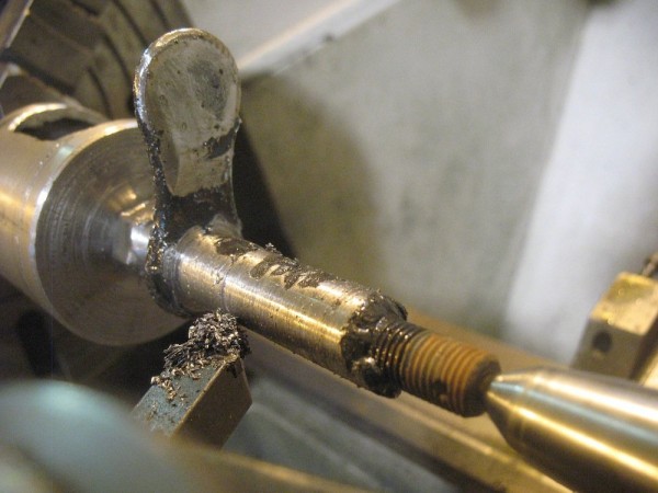

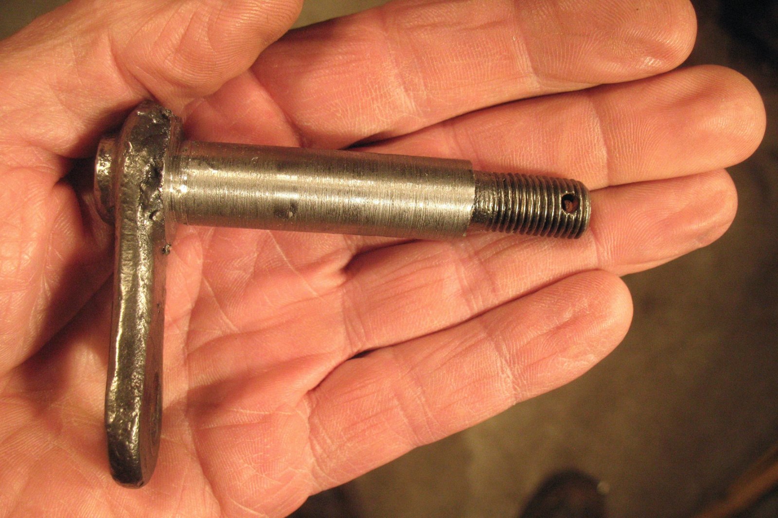

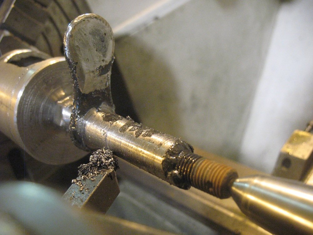

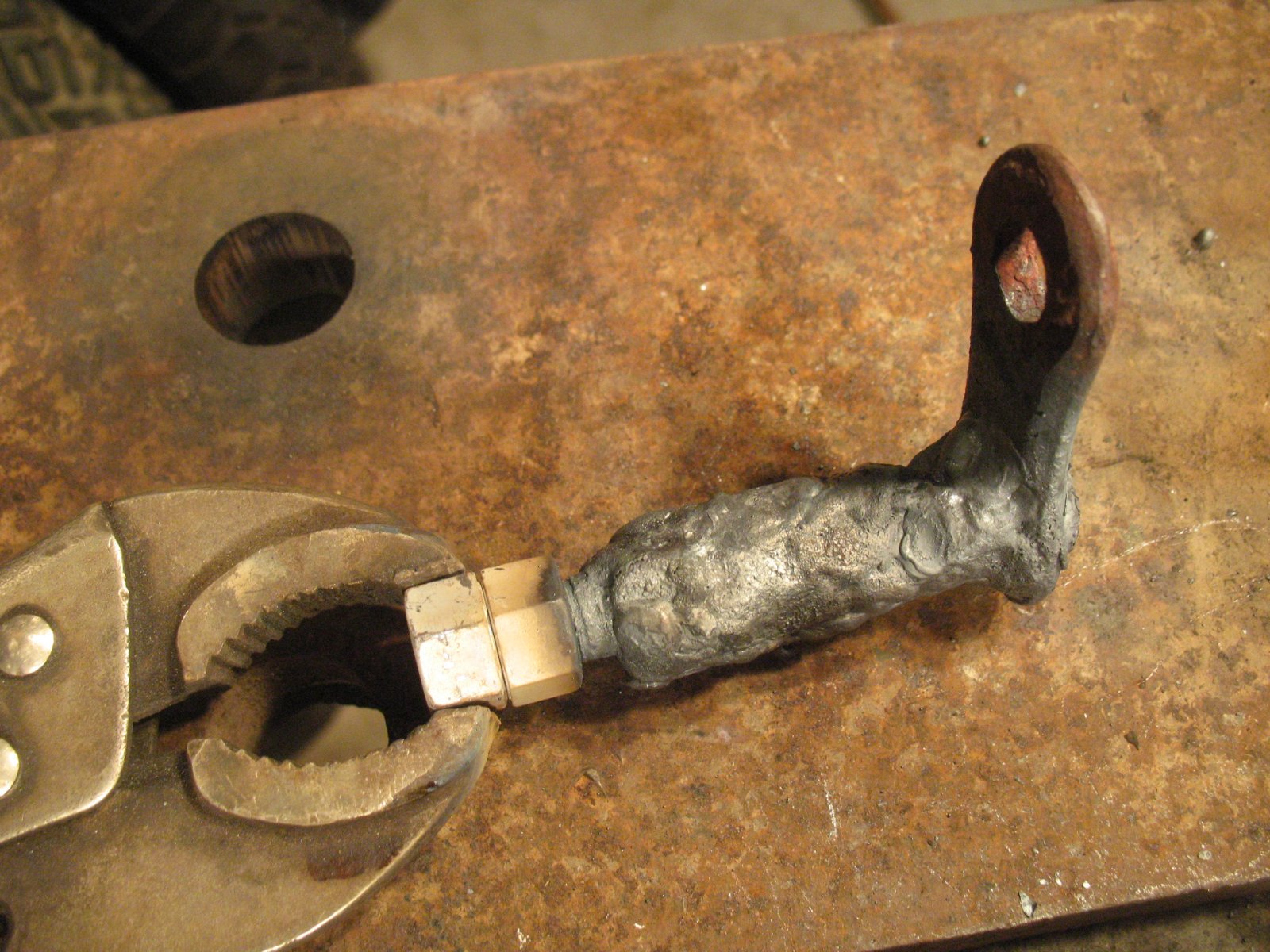

I had some that were pretty bad.
So I did as Erik says. I thought they turned out pretty well. The holes were wallowed out, so I had to fill those and redrill them, and drill new oil holes.

Things can go south very quickly when a suspension part breaks, and anything close to that bad belongs in a trash bin.
Does that mean my built-up shackles are likely to fail?
Adam
- Posts: 1602
- First Name: Adam
- Last Name: Doleshal
- Location: Wisconsin
Re: Shackle Dilema
Steve; If you were a certified welder and you had the shackles annealed & heat treated, and maybe x-rayed, then you could be reasonably sure they are safe to use...
Uneven heating and cooling, hard spots, embrittlement, base material versus filler difference, potential voids, bubbles, and cold-shuts in the weld, final material hardness, hardness differences in various areas of the part... Any of these situations could cause a sudden, unexpected part failure.
If anyone is running with “welded-up” shackles, at the very least, PLEASE keep a very close eye on them and inspect them very closely and very frequently!

I'm not certified and I didn't have them heat treated or x-rayed, so I'll check them often. While figure eight shackles are not terribly rare, NOS or very good ones seem to be. New ones are $60 each. My thought about these was similar to Scott's. The shafts on these shackles were mostly present and unbroken, and the built-up material is in effect a permanent shim to fill the space. I would never try to weld up a broken shackle, but I expect the build-up will be OK. In any case, I'll watch to see if they wear any faster than I'd expect a new one to go.

If your shackles are badly worn, I would have them welded up, and turned to the proper size. I think Ken Kopsky does this. I would stay away from cast reproductions. That gives me the shakes just thinking about it!
