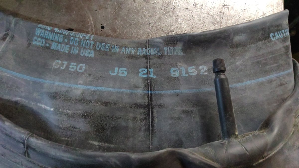

Going thru my stash of parts, that I have just purchased this spring from a local estate. Found some more new tubes. Which have no brand but say made in the USA. But I have no Idea how old they are. But I do not see any dry cracks around stems or creases. So now, what do I do? Use the EEC's or these Made in USA.
- Posts: 8428
Re: Question on Innertube Quality
The USA tube in the picture looks OK to use. I would look each one over very carefully before installing. The best practice would be to buy fresh new high quality tubes. Rubber decays over time.

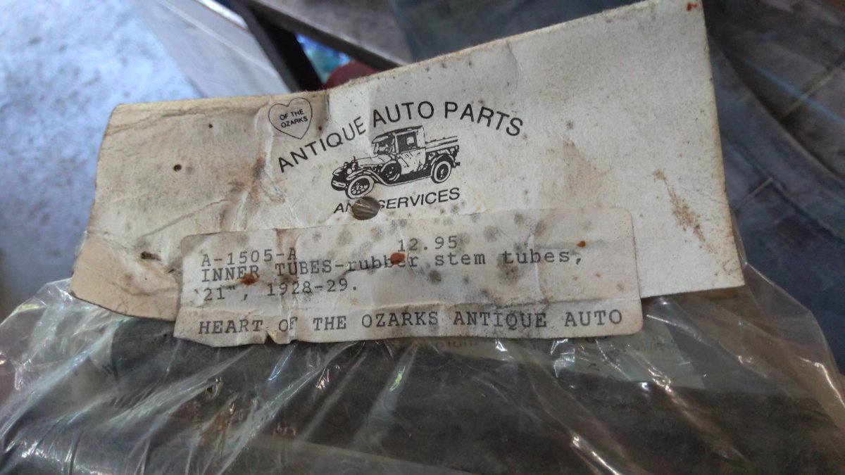

Mark Nunn
- Posts: 1287
- Last Name: Nunn
- Location: Bennington, NE
Heart of the Ozarks Antique Auto Parts was in Marshfield Missouri and has not sold new Model T parts in decades. I think I still have one of their catalogs from the early 1990's. I would not be surprised if those tubes are from that vintage.
