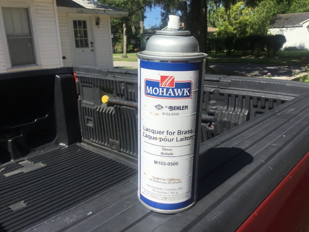

Recently, I tried a spray-on lacquer that is the best I have ever found. “Mohawk Brass Pritectant Lacquer by Behlen”. It sprays on beautifully and does not change the appearance of your polished brass in any way, except to harden into a crystal clear finish that protects the finish from dulling, or discoloring. It couldn’t be any clearer if sprayed with water.

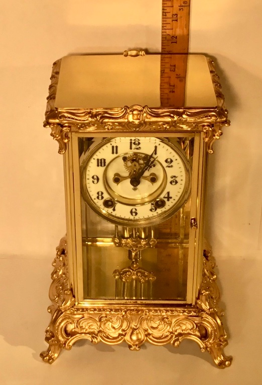

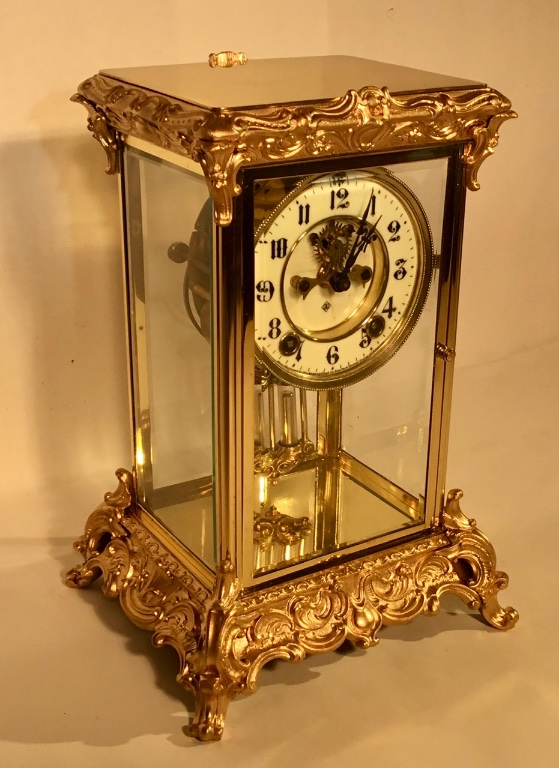

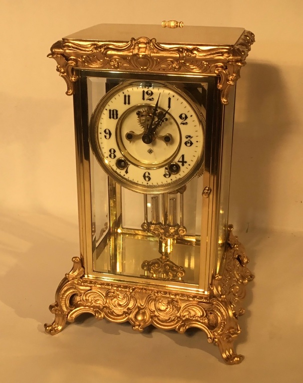

I have posted a picture of an antique solid brass clock that I polished with Maguiar’s rubbing compound and sprayed with the Mohawk brass protectant lacquer which I have also included a photo of. Examine the clock closely and see how reflective the polished brass shows through the crystal clear lacquer and you will understand why I recommend it so highly. Jim Patrick
PS. I purchased it from “www.woodcraft.com”. Type “Mohawk brass lacquer aerosol” in the search box.
