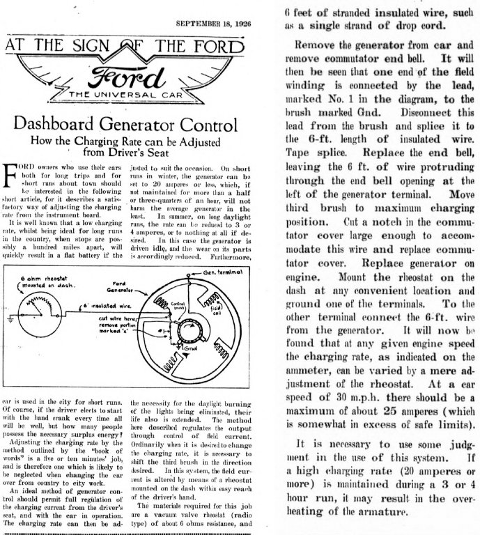

A resistor put in series for the field can be used to adjust output — some of the higher priced cars used the headlight switch to also switch in a resistance in the field circuit when the headlights were off

If I ever take the generator apart, I intend to put a field terminal on it. In the meantime....

Re: T Generator
Putting resistance between the cutout and battery will cause the generator voltage to increase as it tries to restore the same amount of charge current it produced before. Not only might this damage the windings in the generator, but assuming a mechanical cutout, the voltage coil might burn out. The generator is a constant current device. A shunt resistor can be used between the generator terminal and ground to divert a certain amount of charge current, but it's inefficient. At least once commercially made device did just this:
A more efficent control is a resistor or rheostat in series with the field coil.
(Setting the charge current to 25Ah as suggested in that article is way too high)
Best option is to simply set the charge current to 5A and leave it. A conventional wet lead acid battery won't be damaged by that amount of current.
And let's get rid of this fallacy that the battery must always be charging when the headlights are on - there's 50 to 100Ah of capacity in the battery. If generator charge current is 5A, and headlights draw 7A, then only 2A is pulled from the battery, and there's a lot of hours before the battery is discharged. Who, in a Model T, drives for hours upon hours, night after night?
Topic author - Posts: 8439
Re: T Generator
The Bradleystat does about what turning on the lights does. Is it correct that grounding the output terminal completey disables the generator? If so, adding a switched ground connected to the output terminal of the generator would work for me. I assume the generator would retain enough residual magnetism to ramp up without further attention once the ground switch was opened. I also assume that closing the ground switch with the ammeter indicating 0 charge or a discharge would not result in fireworks.
