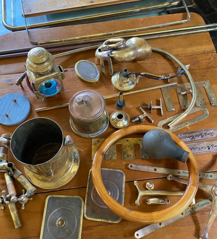

Planning on using a paint stripper to remove what appears to be a lacquer finish on brass lamps before polishing.
I've used paint stripper on furniture but never on brass.
Any issues or cautions I should be aware of?
Is there a better way?
Stripping lacquer from brass lamps
