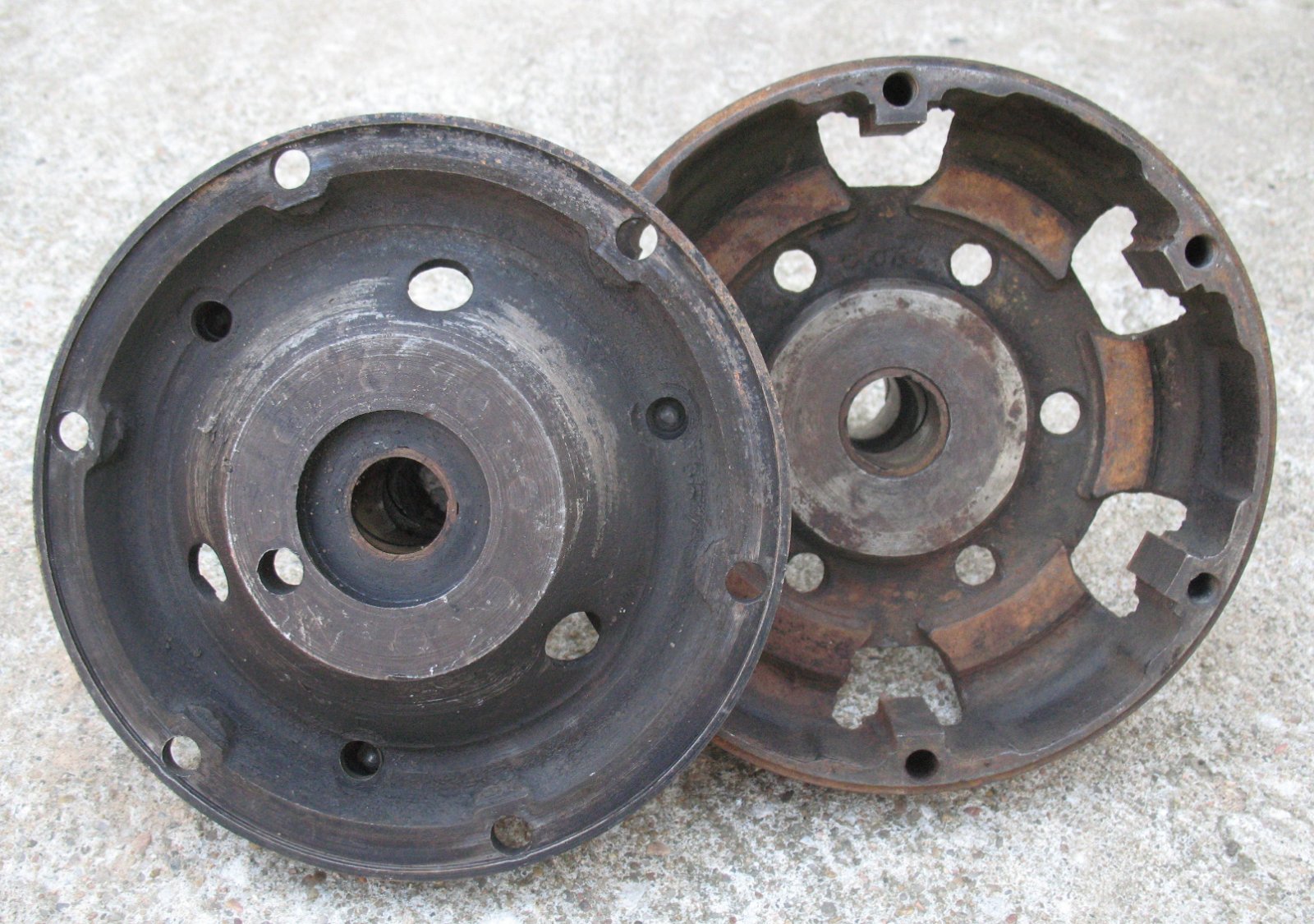

The transmission repair I cobbled together worked OK, but while everything is apart for some engine work I should put in a better brake drum. So I've been going through drums and drive plates to see if I have any that are good enough to use. Matching up a drum and a drive plate is complicated by changes over the years.
The DB mark tells me this is the earliest drive plate I have. If I remember correctly it came out of a transmission with a 1913 date stamped on the main shaft. I believe this is a later version of the brake drum that fits it, but they fit together correctly.

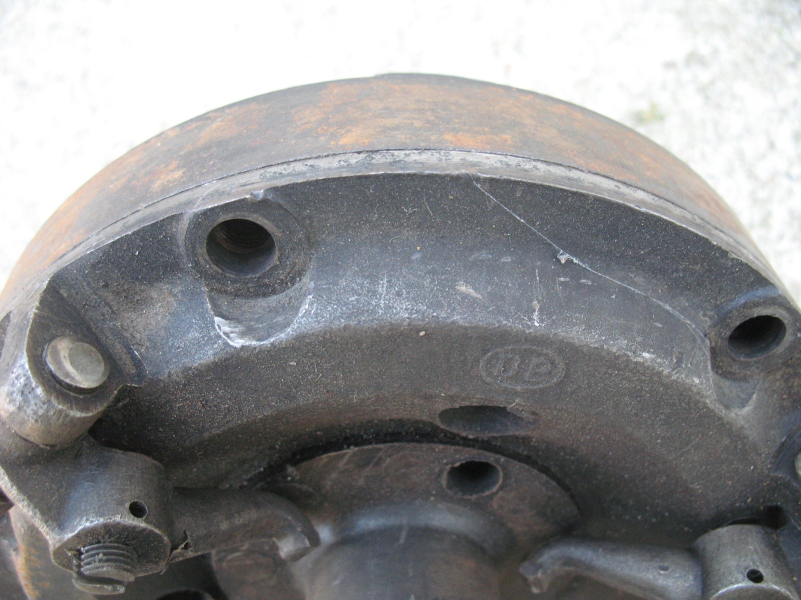

Putting them together you see that the plate forms a continuation of the drum surface.

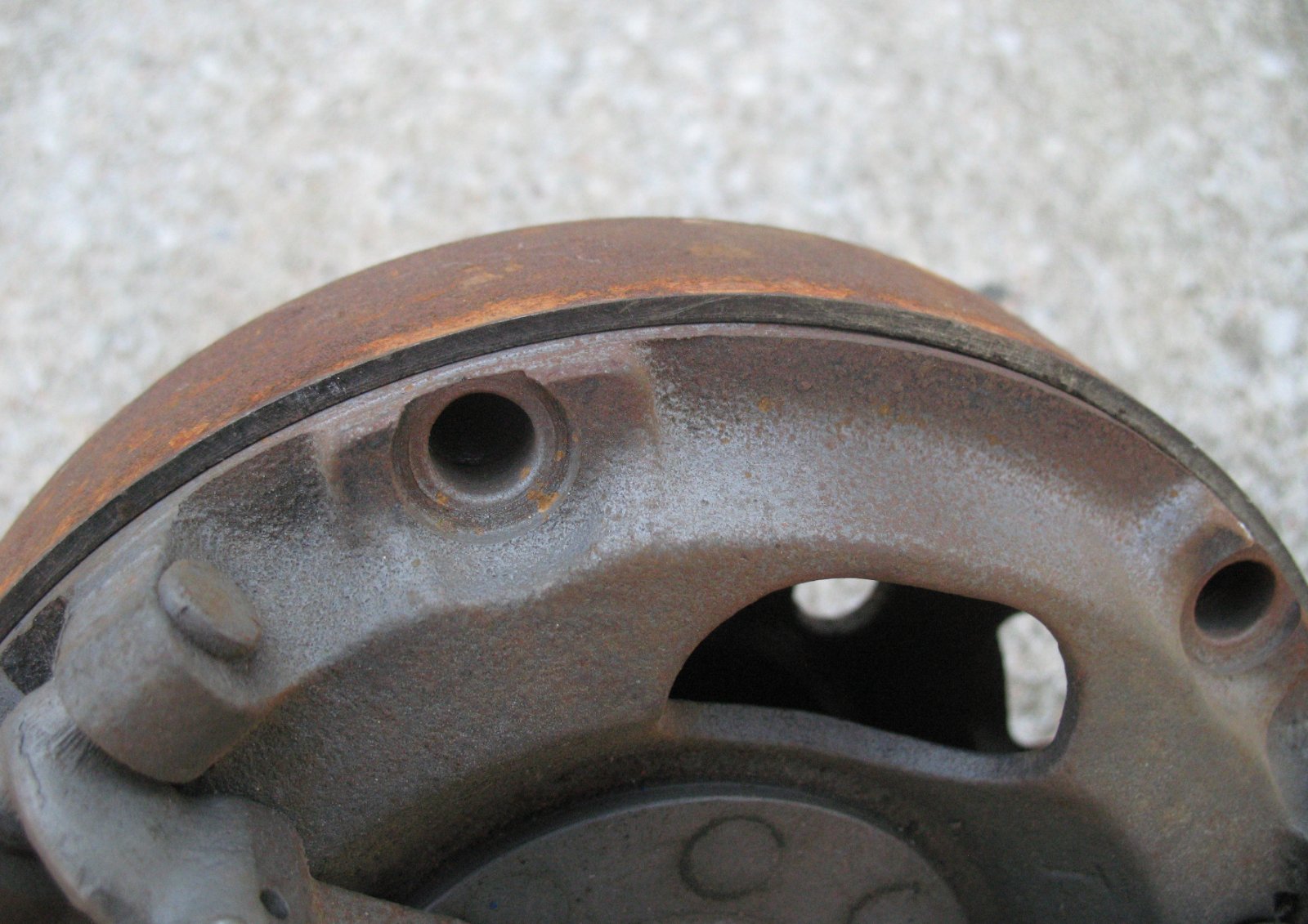

Here's one of the 1925 drums. It has disk lugs separate from the bolt holes, and the lugs have steel shoes to prevent wear by the disks.
This drive plate fits into the flange on the drum, and the bolt holes line up perfectly, but the drive plate edge is recessed from the drum surface.

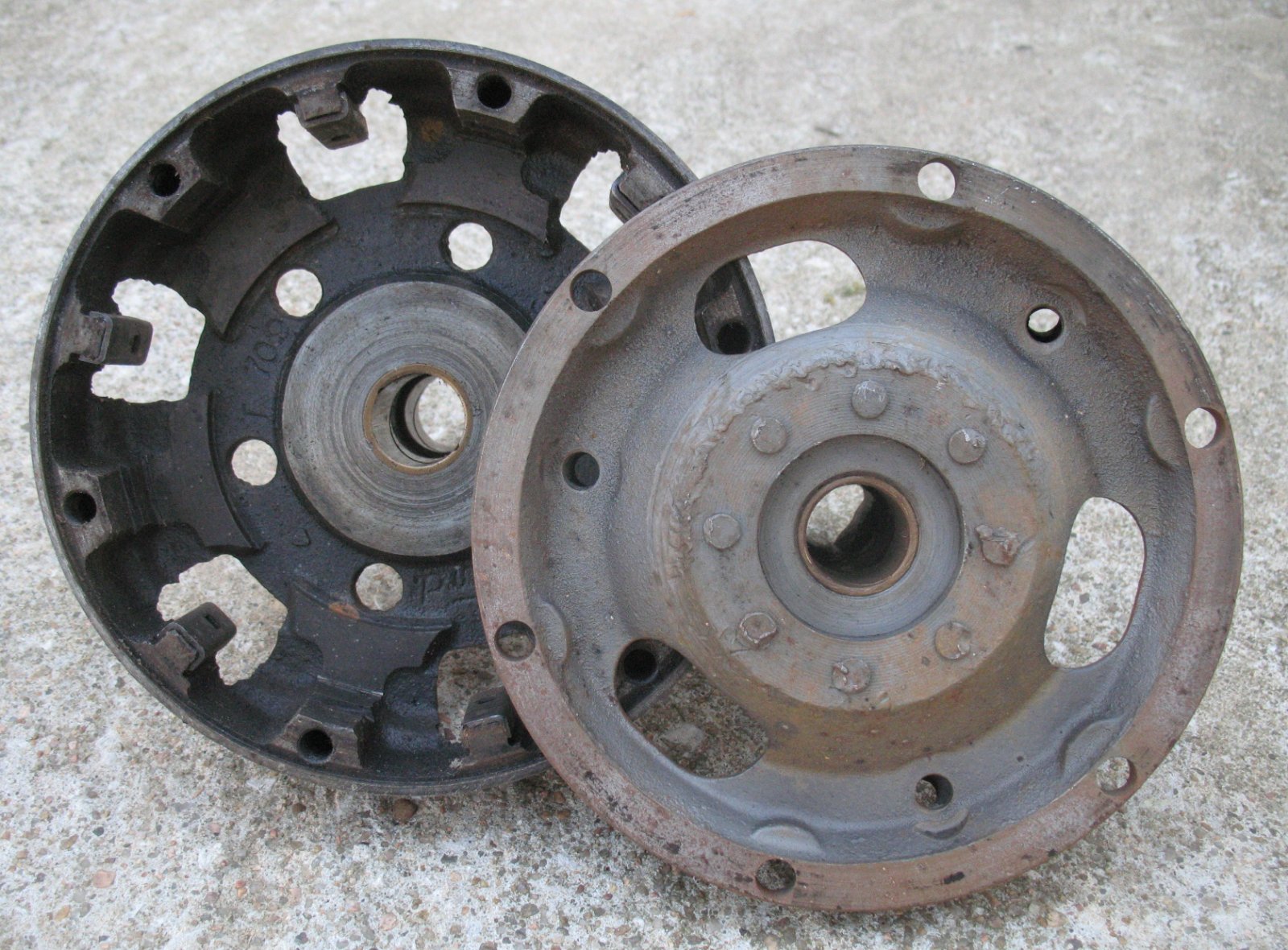

Here's another drum with separate lugs and steel shoes. The early drive plate shown in the first two pictures fits it perfectly, BUT the bolt holes don't line up. I assume there are drive plates that fit and have holes which do line up, but I don't have one.

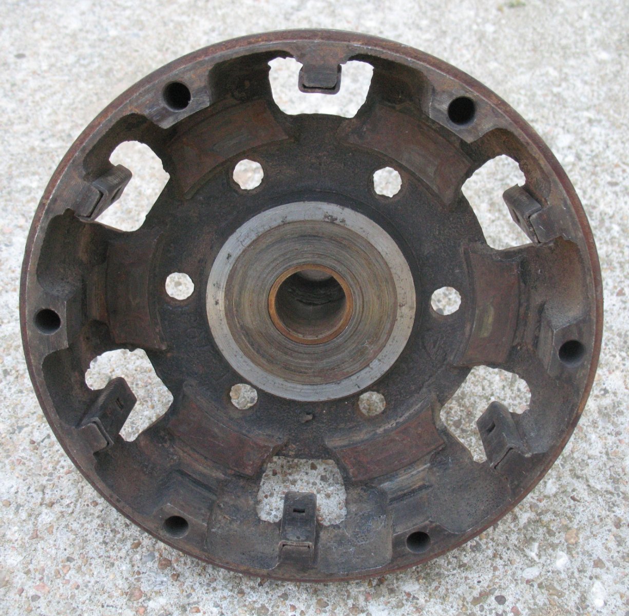

I like the steel shoe idea, but I don't like the mismatch of edges with one combination and the hole problem with the other. I suppose the best plan would be to pick out the earlier style drum with the least disk wear on the lugs and file them straight.

The driven plate that has the OD smaller than the brake drum is a 26-27 Driven plate. It is smaller because they register inside the wider brake drum rather than on the step on the face of the brake drum like the earlier design. You can use an earlier driven plate with your brake drum with the lugs by machining (preferred) or filing the bolt holes in the driven plate. The holes are on a slightly smaller bolt circle on the 26-27 brake drums and driven plates.
Posts: 7146
Re: Sorting transmission drums and plates
Post by Allan » Sun Apr 14, 2019 6:22 pm
Steve, it is most important that the drum surface and the outer diameter of the driven plate are as near to the same as you can get, as together, they form the surface on which the bands engage. If you can manage this using a brake drum with the steel lugs, you have the best combination, but I would not compromise this match just to get the steel lugs on the drive plate.
