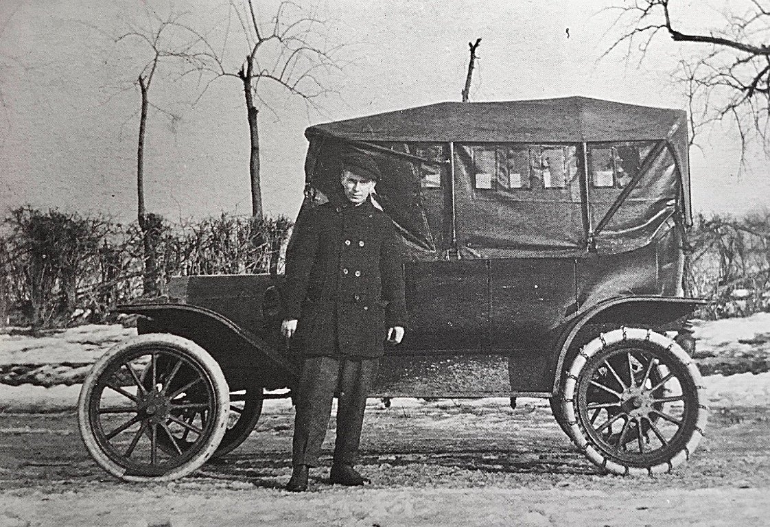

Post by Wayne Sheldon » Tue Jul 05, 2022 1:48 am
Well, I have looked through a couple hundred 1913 and 1914 Ford photos on my computer. Found a couple 1913 touring cars with side curtains if that could help? Must be a least fifty 1913 runabouts, not a single one with side curtains on. Another couple 1914 touring cars with side curtains, and no 1914 runabouts with the curtains in place.
So I guess I am no help whatsoever.
Can you tell me what you're wanting to see or find?
I'll post these two just so people have something to look at.

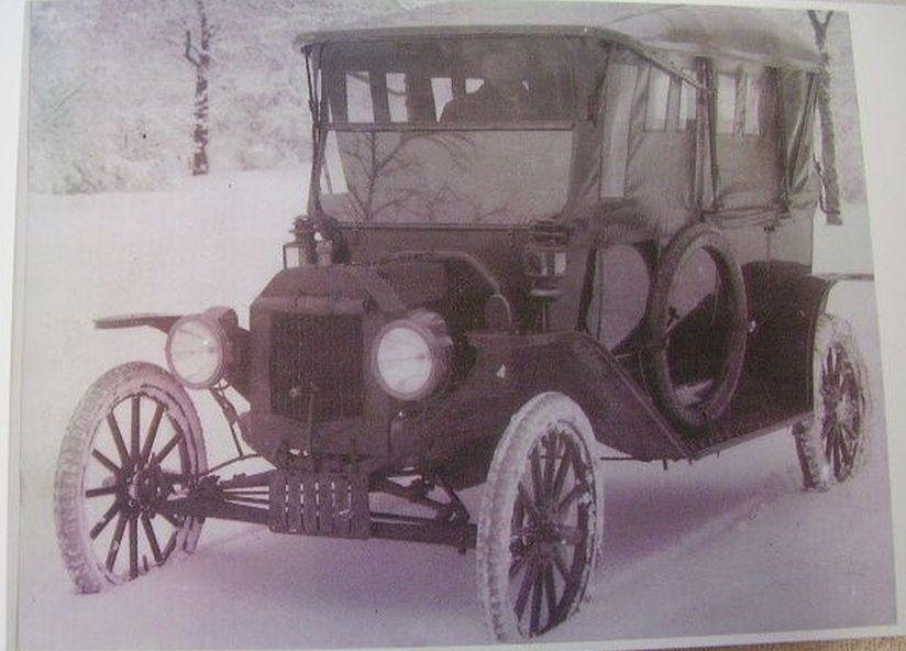

Post by Drkbp » Tue Jul 05, 2022 9:53 am
Here is a 1914 with rear side section.
I believe Tom posted this one.

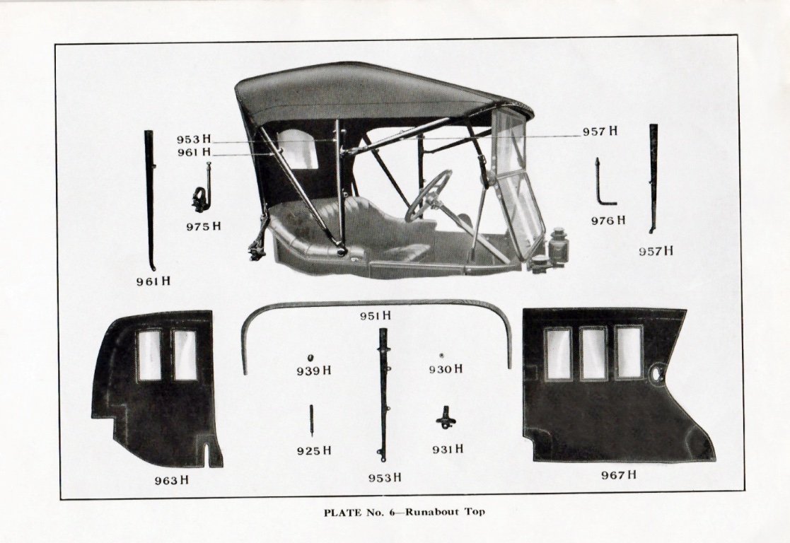

Post by BRENT in 10-uh-C » Wed Jul 06, 2022 1:10 pm
I 'borrowed' this photo from somewhere (-likely from here ;) ) but it shows something pretty similar to the picture Rich posted. Not sure that helps much.

Post by Original Smith » Thu Jul 07, 2022 11:24 am
Brent: That is what I'm looking for! I have an original 1915 Parts and Accessory booklet that shows that exact image. I also have two very bad originals, that have been highly modified. They will be of help on the techniques in stitching that Ford used. I just ordered the Turf Grain material from Mike at Classtique yesterday for this project. I also have a bag of original fasteners that were removed from tops and side curtains many years ago, so I don't have to use any the the current fasteners that just don't look right.

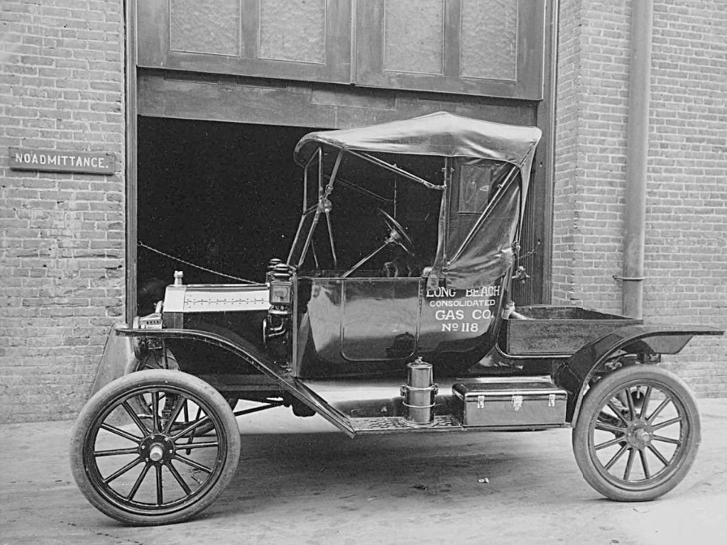

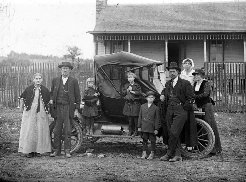

Post by KWTownsend » Sat Jul 09, 2022 3:28 pm
Here's one for you Larry. No bill on the fender. Is it '13 or '14?

Post by Model T Mark » Sat Jul 09, 2022 3:45 pm
I’m going to say 13 because of the extra bead on the bottoms of the body tub.

Post by Wayne Sheldon » Sat Jul 09, 2022 6:04 pm
Zooming in on the windshield, the hinges appear poised for the top frame to fold forward. Pretty much also means a 1913!
Nice photo. I don't think I have seen that one before.

Post by Drkbp » Sun Jul 10, 2022 12:20 pm
Nice photo ...I believe it's reversed.
(Buttons on the guys vests)
Prest-O-Lite seems to have a regulator on it maybe.

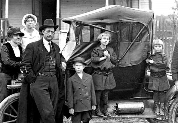

Post by KWTownsend » Sun Jul 10, 2022 1:20 pm
better?
1913 runabout side curtains close.jpg (81.51 KiB) Viewed 3346 times

Post by Wayne Sheldon » Sun Jul 10, 2022 7:06 pm
Interesting. Now the boy's coat is backwards???
However this seems to put the POL tank on the usual side.
And, yes, the "flip and zoom" does help!
Thank you.

Post by Original Smith » Mon Jul 11, 2022 10:49 am
Thanks Keith, that photo is great. Too bad all those people are blocking what I want to see! For those who own 13 & 14 runabouts, note the curve of the top at the rear bow.
Posts: 3914
Location: Lomita, California
Re: 1913 Runabout with side curtains
Post by Original Smith » Mon Jul 11, 2022 11:32 am
I just noticed another detail that points out this is probably a '13. It has a tea cup oil pan.
