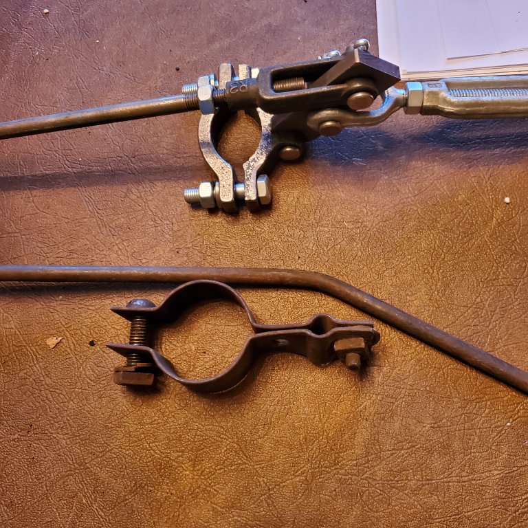

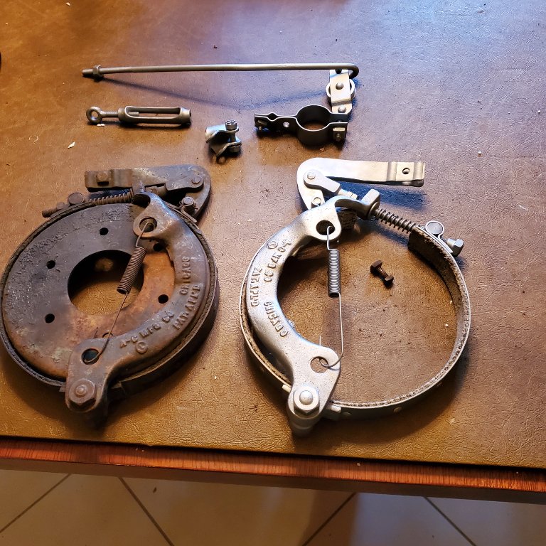

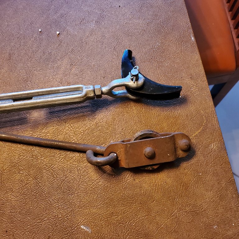

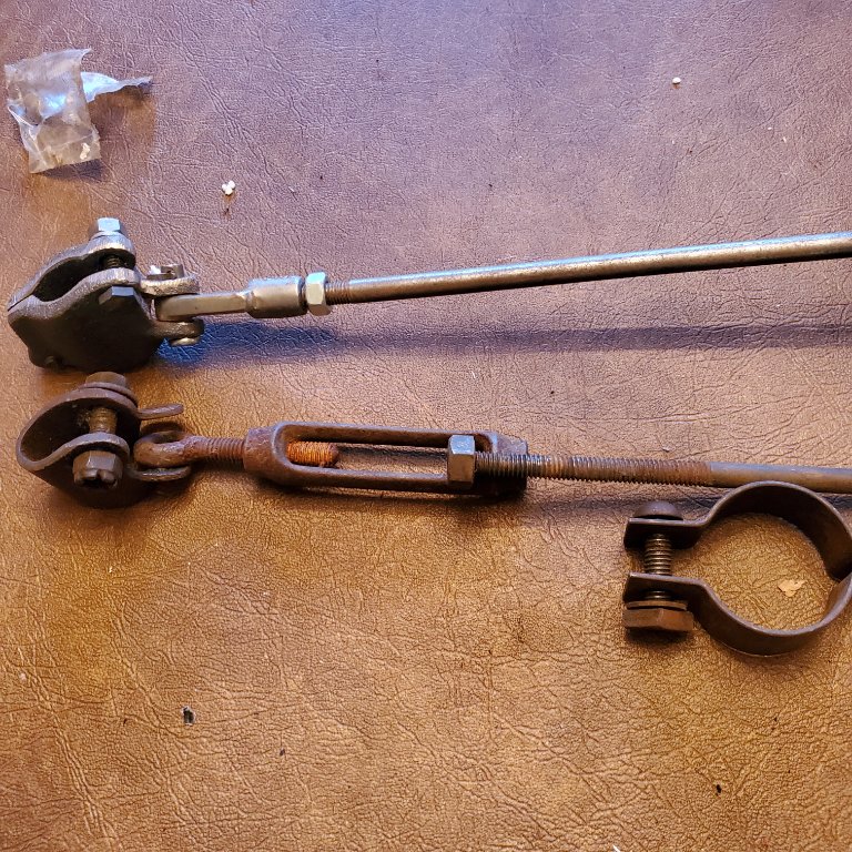

Photos of an AC brake system. The original linkage is pictured next to Mc Eacherns reproduction.Original Smith wrote: ↑Fri Jul 15, 2022 11:16 amI knew the man who had the Rocky Mountain brakes made. He was a very nice person, with no mechanical ability. Initially he copied the original Rocky Mountain design, but never did the required research enough to find the equalizer components. It's funny that I've been able to do this 30 years later.
