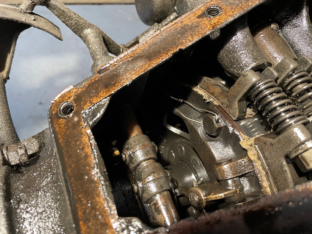

I’ve rocked the car in 3 different positions so I could see all the rivets, and they all seem tight.Jerry VanOoteghem wrote: ↑Tue Jul 12, 2022 9:33 amMiles,

Looks good Miles. Your brake band lining is a little scarce on the left end, but that's not your immediate issue.

The clutch adjusting bolt is riding the edge of the cam on the brake cross shaft. That could affect how the brake lever operates, especially if there is any side play in the brake cross shaft or in the clu tch release shaft. The bolt should contact the cam face near its center.
- Posts: 4386
Re: Clutch and brake lever issues
You do not have a proper "leading ramp" on the cross shaft clutch cam! That probably is not the cause of your trouble, but does need to be corrected.
With a proper leading ramp on the cam lever, the small end of the bolt digs in and drags a bit much when the brake lever is pulled back. So I usually grind a bit of a ramp in the bolt's head, and flip it over so that the head of the bolt, with the ramp properly facing the leading ramp of the cam lever, is down below the clutch shaft arm. Put the locking nut on the top side once the clutch is fully adjusted.
The clutch and hand brake work mush more smoothly that way.
I hope you find your immediate problem.
- Posts: 7143
Well spotted Wayne. I wonder how it came to be that way with no lead-in ramp?
The brake drum on the transmission shows that the driven plate, the edge of which is part of the brake drum surface, is not being contacted by the band. This is a common fault when piecing together a transmission from assorted parts. The driven plate has been worn more than the drum, so the band is just engaging on the narrower drum surface. It is often difficult to find a good combination of driven plate and drum to get a full width brake surface. Too great a difference between the two components will lead to compromised wear on the band linings.

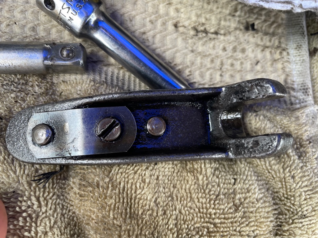

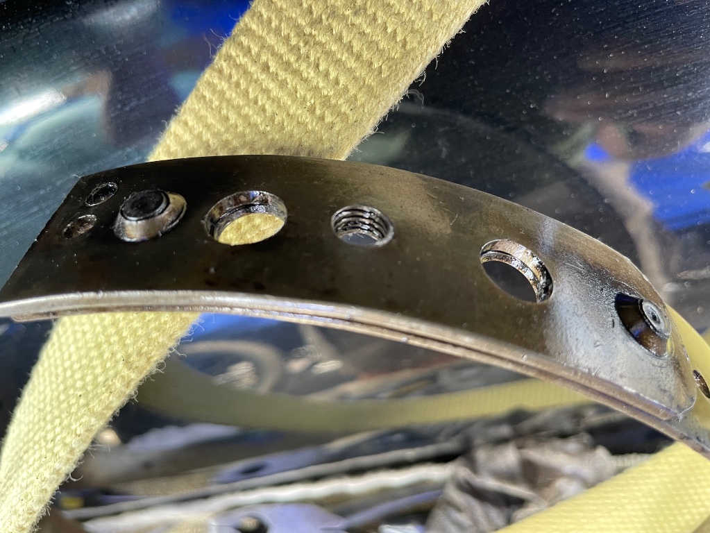

I drove the car about 5 miles after the above picture, and another 5 miles after arriving in Hamilton, and could feel an occasional slight “bump” in the pedal on moderate braking. Upon checking the oil screen I found it completely plugged with lint, and even more of the end of the lining gone - time to change the brake band lining. Fortunately, it being a big tour, I had LOTS of help to get the job done. Unfortunately, because of an unusual style of brake band, we didn’t discover it had removable ears until AFTER we’d pulled the hogshead
. Only one of the long-time Model T guys helping had seen bands with screw-on ears before, and he didn’t show up until the rest of us had the hogshead off…
Once we got the brake band out, we found that the lining had completely separated from the first rivet in the forward direction of rotation, and I’m sure others were soon to follow suit. The good news is that all drums are in good shape and crack-free. That apparent scoring on the brake drum is just a “polished” line where that first rivet had just started dragging, nothing that could be felt with a fingernail.
Whether my fault or the vendor (I haven’t gone back and checked the order), the band lining kit I had with me was for a 26-27, with the wide brake band. The low and reverse linings in the car looked serviceable, so we only replaced the brake lining. The engine is due for rebuild this coming winter, so the other linings will get replaced at that time.
I did ask about the clutch cam setup (the guy who was familiar with the unusual bands), and he said his was set up the same way. It may not be obvious in the above photo, but there is a lead-in ramp on the end of the bolt. He did say that the linkage clevis and pin were worn excessively, and should be replaced before long. He adjusted the linkage a bit, and it does shift a bit smoother now.
After getting the hogshead back on and the bands adjusted, we were running out of daylight and having an issue getting the starter bendix reinstalled, so we just put the bendix cover back on without the bendix to get the car back in the trailer for the night. Once we get the bendix reinstalled and deal with a moderate oil leak it should be good to go. I am truly grateful for all the help available in the Model T “family”!
